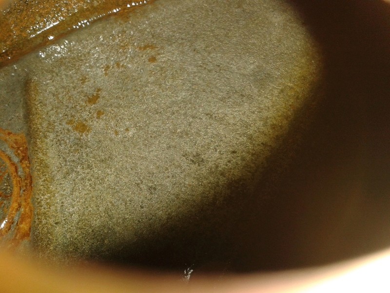

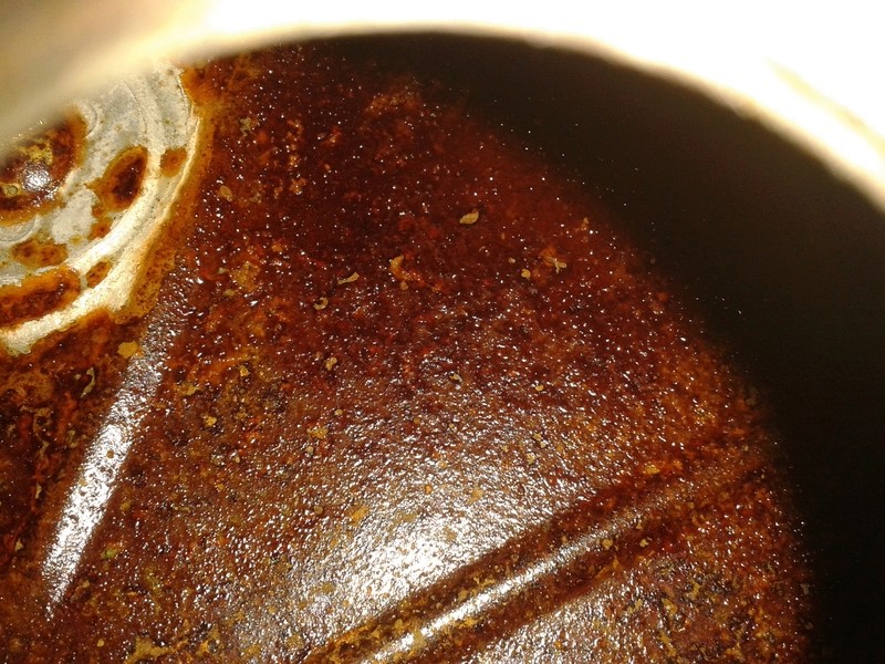

November 23, 2016 at 10:58 pm #47927White vinegar can make miracles too in a steel tank.
Same thing for electrolysis.
And then , shaking the tank with a handful of screws / bolts.
Before / after.
Almost done, work in progress for now. Maybe I’ll pour it with a mix of mollasses and water later.

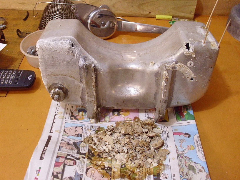

November 24, 2016 at 1:03 am #47934I once did this too 😛
