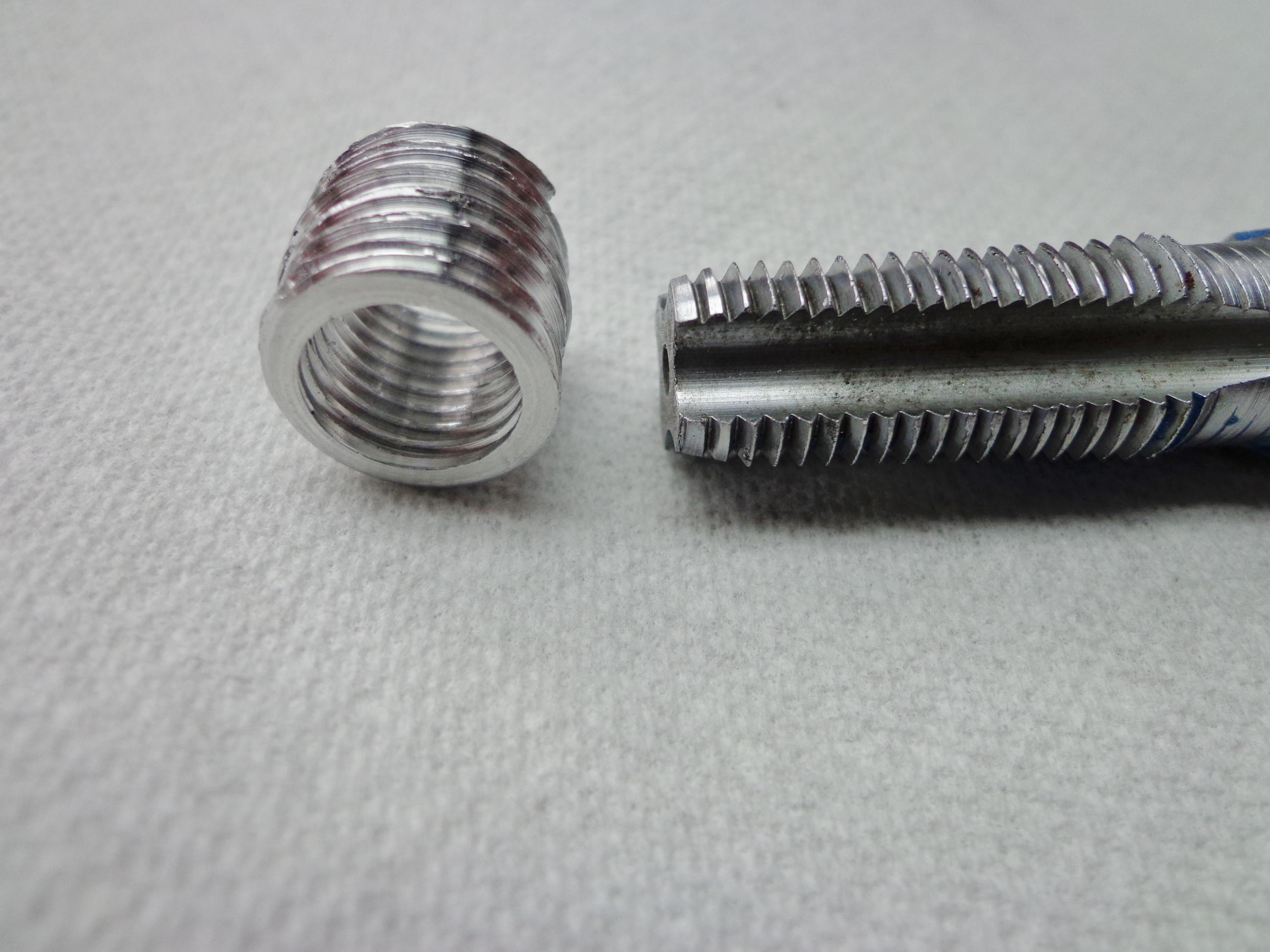

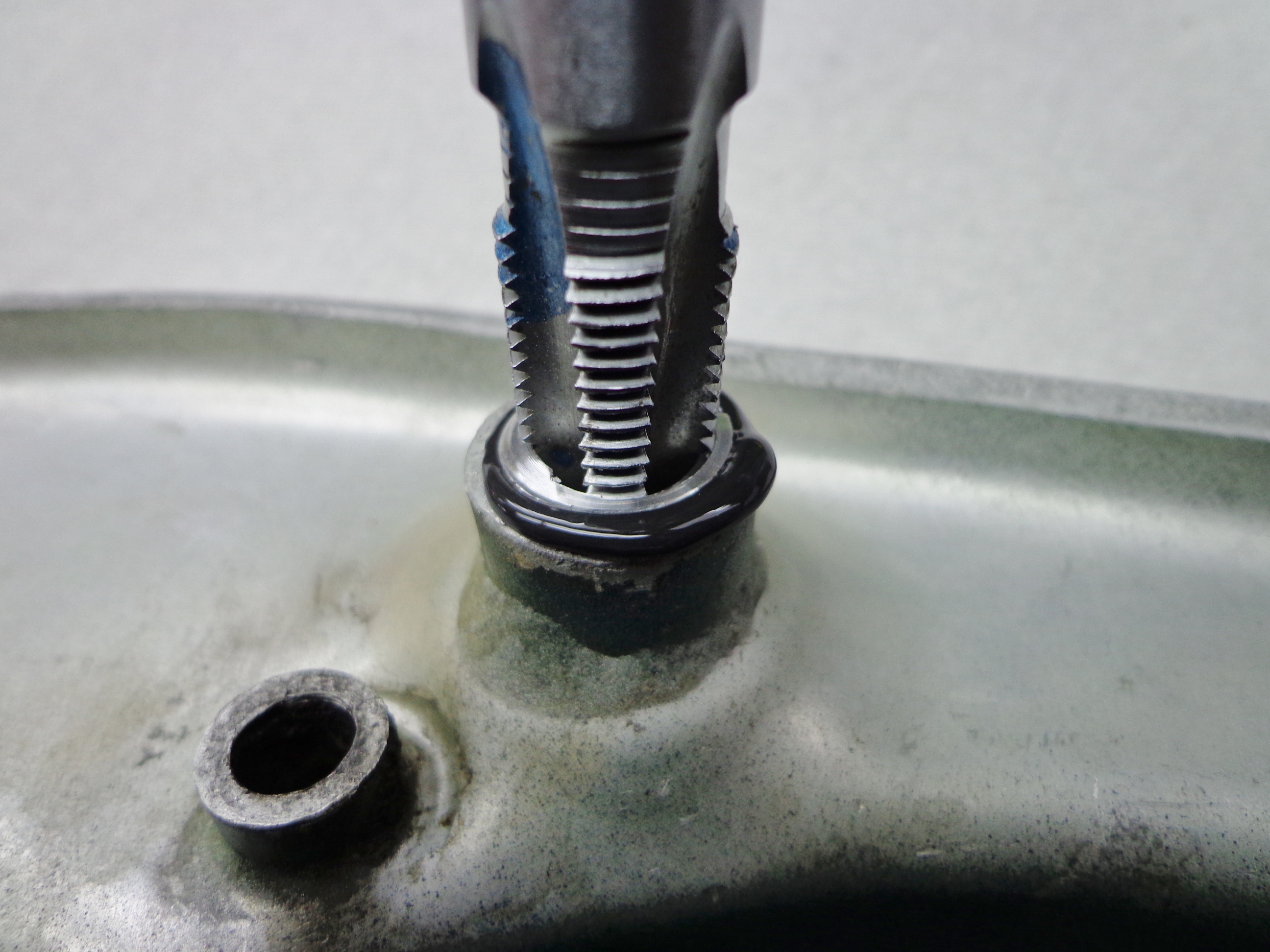

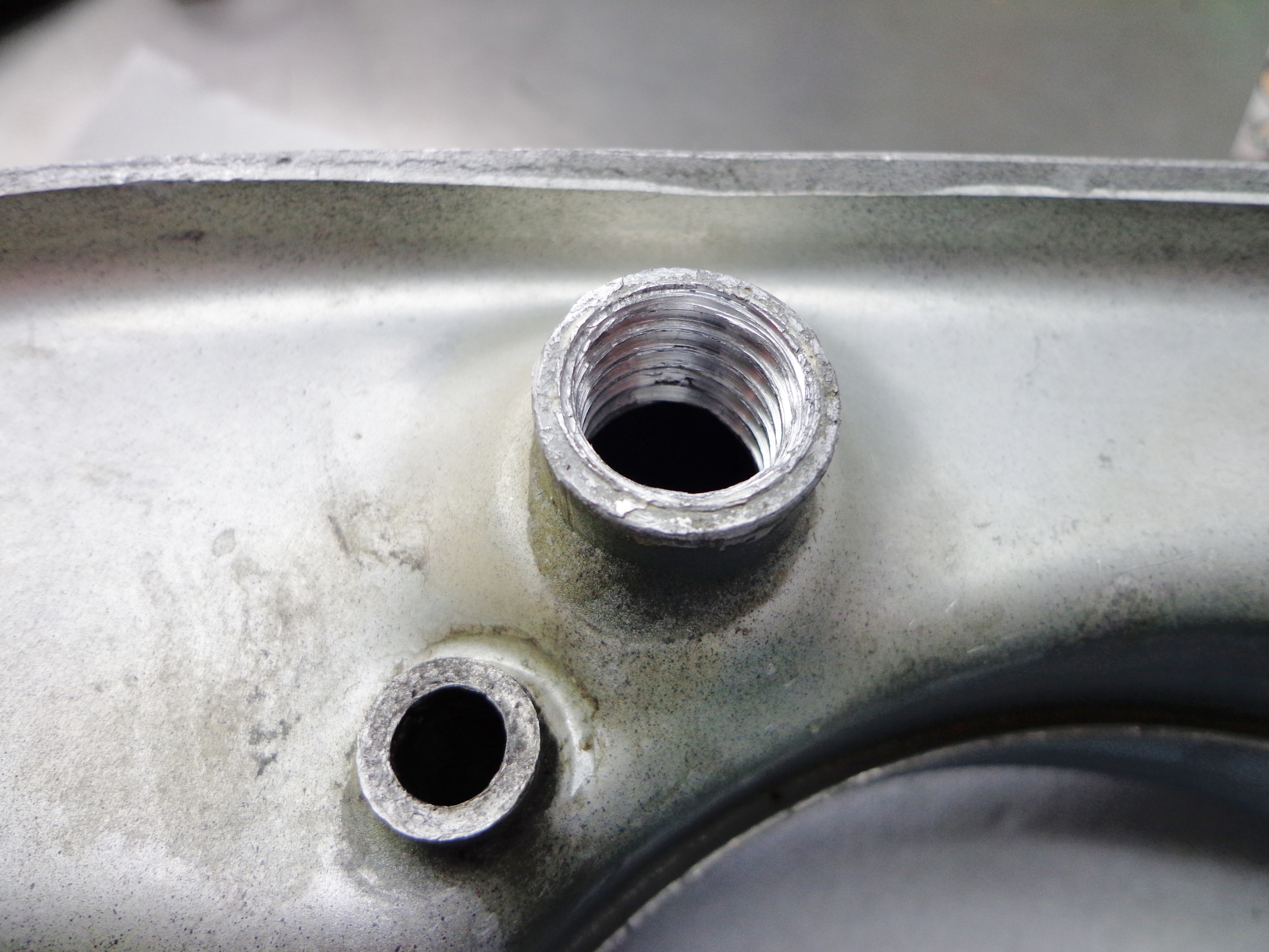

          A few years ago I showed how I repaired some Johnson and Evinrude tanks with bad threads by making an insert for them. The original threads were drilled and tapped to fit the insert which was sealed and held in with Marine Tex epoxy. The internal threads of the insert were the same size as the originals so an original fuel tap or fitting could be used.
