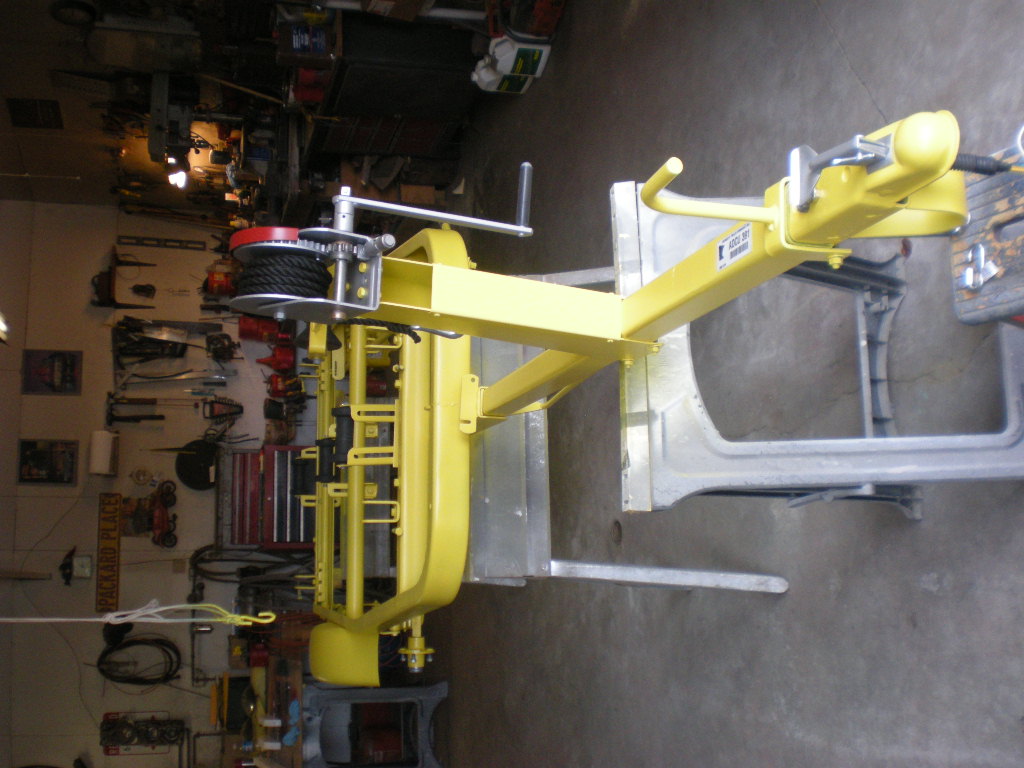

The Gator trailer is back together for the most part.
It had a broken up cedar board on it for a walking plank
when I got it. At least one original brochure shows a
plank, but not in close enough detail to see how
it was mounted. My old plank was held on with one

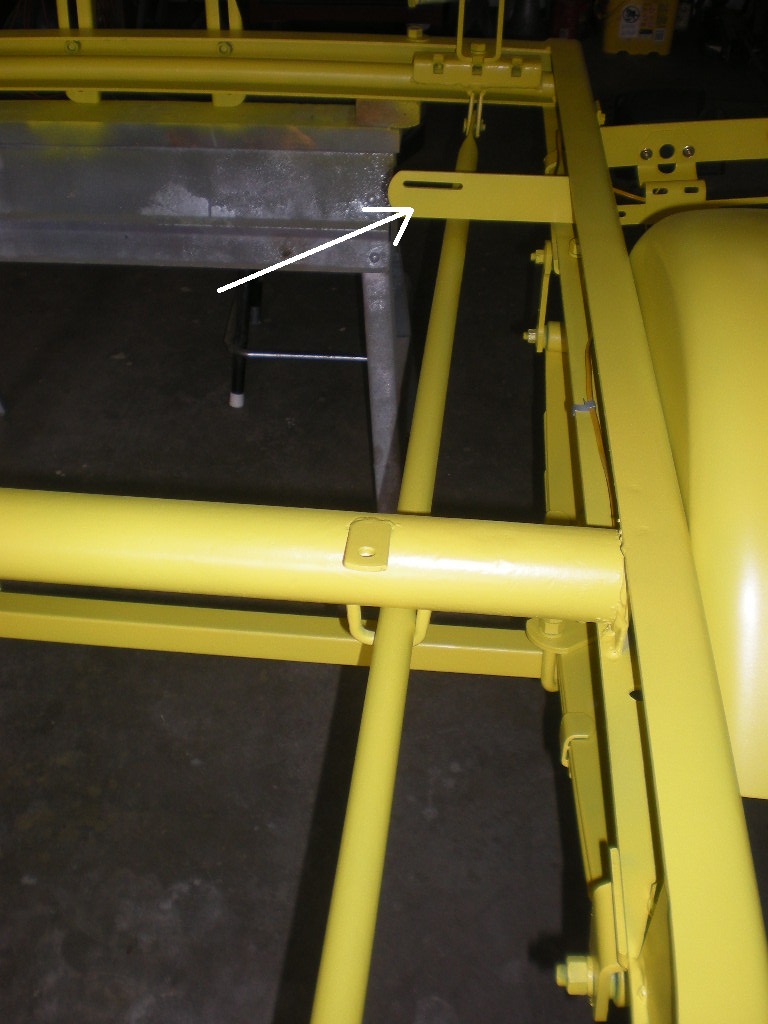

bolt in the tab that’s welded on the pipe in the center
of the trailer. I believe the rear of my cedar board
was just resting on the bracket that the arrow points to.Q. Anyone have photos of how the board originally mounted?
The bracket (that the arrow points to) does not appear to
be a plank mount.
Q Anyone know what it’s for?
I’ve seen it in other old Gator trailers, doing nothings as mine.Prepare to be boarded!

Looks like she’s a tilt trailer, I believe they used a chain, one end with a fixed attachment at the hole, the other end of the chain slid into the slot on the other side after wrapping below the tongue, to lock it down. Unhook the chain from the slot, rehook giving it some slack, to limit tilt.

April 19, 2016 at 2:20 am #35055GD, the tilt safety chain bracket is seen in the top photo, where
the tongue and main frame meet. Don’ have the chain bolted
on it yet, but will tomorrow.Prepare to be boarded!
