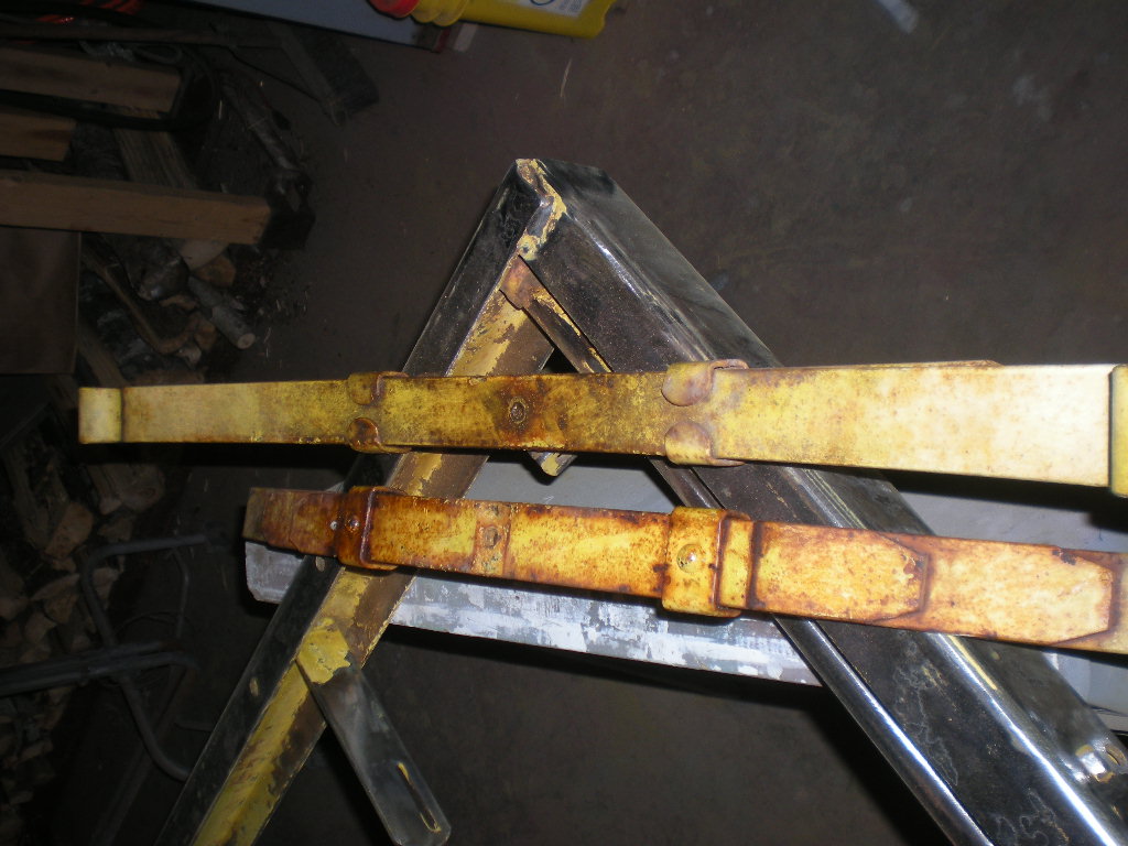

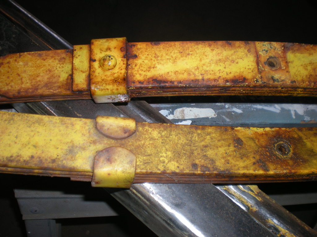

      I’m trying to get the leaf springs apart on my Gator trailer.
      I have the center bolt removed on each set. There’s two
      clips on each spring that appear to be pinned to the
      leaf springs. The pin or rivet does not go all the way through
      the spring set, therefor cannot be pounded out. The pin
      has a rounded head, and can’t be grasped with a vice grip.
      Thinking that perhaps the pin is only anchoring the bottom spring,
      I tried to tap a center leaf out, but none seemed to move.
      Anyone know the proper why to remove these clips?
      There’s two piece rubber bushings in each end of the spring
      eyelets that should be replaced.
      Anyone ever have any luck purchasing them?
      Anything wrong with sandblasting the leaf springs?
      Should leaf springs be lubricated / greased when reassembled?
      I thought I read once NOT to.
      Thanks!

        You would have to unbend the open ends of the clamp that hold the leaf springs together. Should you do that they might break when you try to rebend them closed, or not close tight enough without significant application of some serious heat. For what it’s worth I had my leaf springs sandblasted without disassembling them, and painted them with Tremclad Black. Over 5,000 miles of trailing later all is still well.

                  Got the spring clips off today. They spread apart easier than
                  I would have thought. Found out that it is an actual rivet
                  that’s peened to the bottom leaf spring. I easily drilled
                  out the peened side of the rivets and punched them out.
                  Will make some rivets out of 3/8" bolts in the lathe.
                  Thanks for the help and suggestions!
