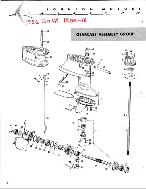

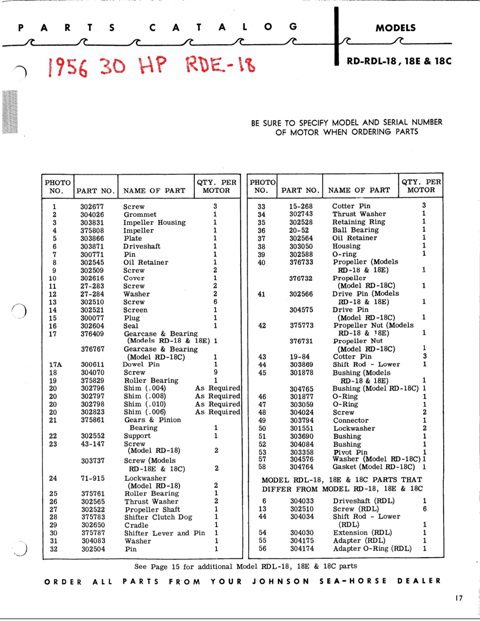

          How does one find out individual part number for each gear?
          1956 RDE-18 30 hp Johnson
          gear-case1956-30-hp-RDE-18-1
          list-gear-case-1956-30-hp-RDE-18-1

            I had the individual gear numbers when I restored my RD-18 a few years ago but can’t seem to find it at the moment, except for the pinion gear and bearing assembly which is part #375835.   I’ll keep looking for the forward and reverse gear numbers.
            13-New-Pinion-GearBearing-375835

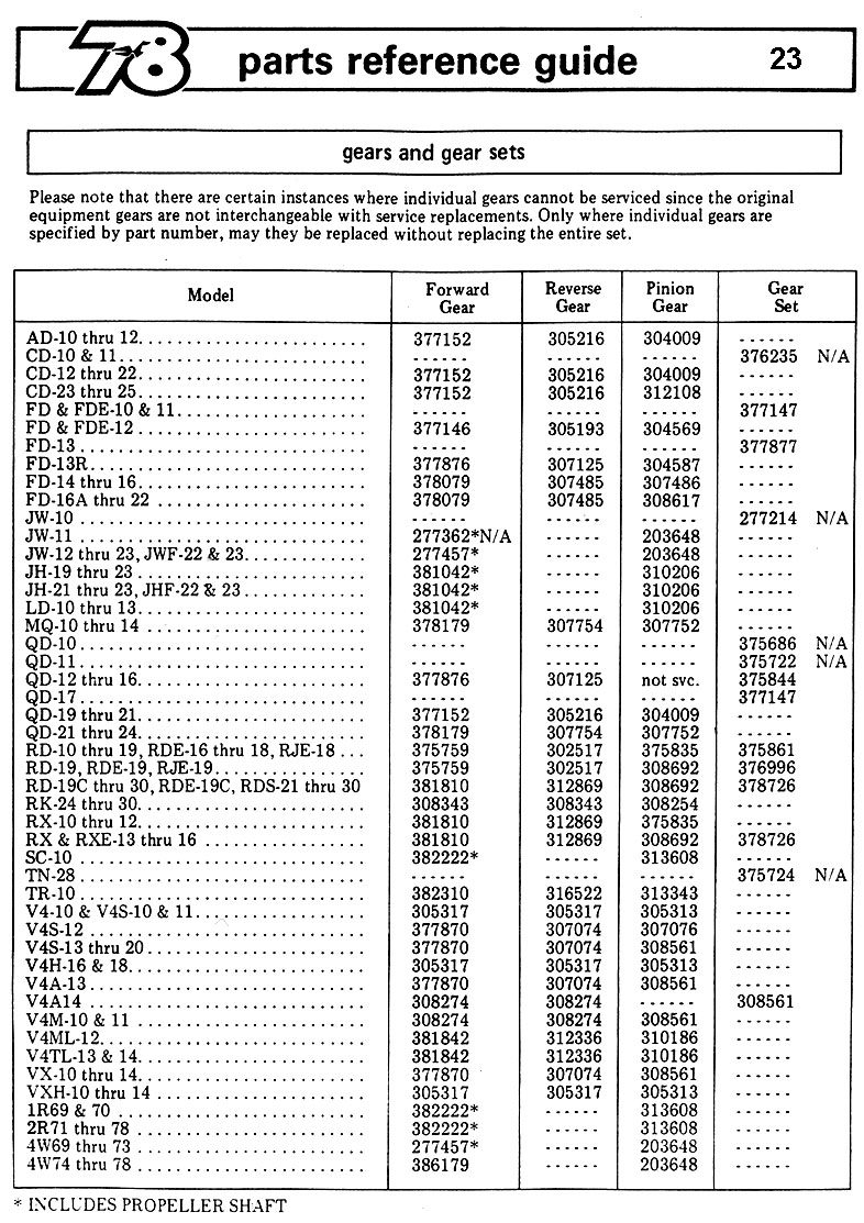

                #270399
                retiredoz
                  These are the numbers in my ’69 Parts Reference Manual for RDE-16 thru RDE-19 :  Fwd Gear 375759, R Gear 302517, Pinion 375835, Gear Set 375861  My ’79 Manual lists the same numbers, so apparently they weren’t superseded by then..

                      #270406
                        OK, I can also confirm the same numbers provided by retiredoz.    I finally located my file record on gear set numbers – see enclosed.
