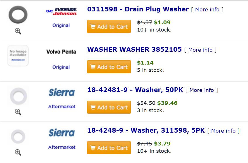

                  But as I look over the ‘net, I’m not seeing a real clear picture of what washer to use. The plastic ones seem to be the most common, but I’m not certain which to buy. Johnson part # 27-284 is the correct-but-obsolete OMC number. What is a modern, plastic equivalent? Is it Sierra 18-4248-9? As absurdly overpriced as these are, I’d prefer not to make a purchasing error .

                    Surprisingly, Marine Engine has the washers for less than Amazon. You can also try your local BRP or Mercury dealer as they both use a 3/8″ drain plug on certain models.
                    http://www.marineengine.com/
                    Drain-Plug-Washers
                    #248271
                    nj-boatbuilder57
                      Casual observation:
                      – a 5 pack is $3.79. That’s $0.758 / ea.
                      – a 50 pack is $39.46. That’s $0.789 / ea.
                      Who would buy a 50 pack when ten 5-packs is cheaper?
                      I found these at West Marine….same deal, only worse!
                      – a 5 pack is $3.79. That’s $0.758 / ea. (same as marineengine.com)
                      – a 50 pack is $44.99. That’s $0.8998 / ea!!
                      Who thinks this stuff up?
                      Anyway…thank you for the info.
