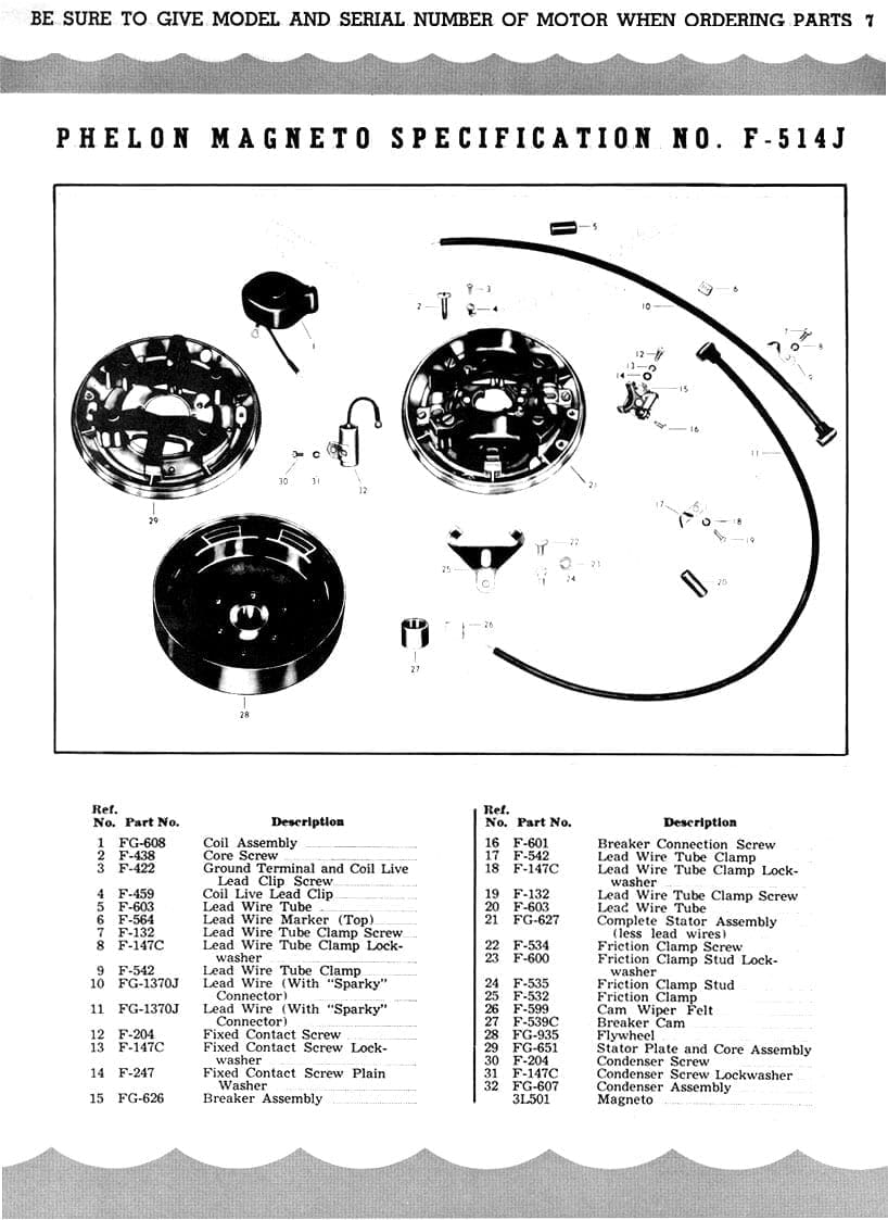

          Is this your magneto?
          7.-Phelon-Magneto-F-514J

              bernied07
                It does look to be the same magneto as in the diagram.
                #184729
                  Same as Mercury. They are available, not cheap.
                  https://www.ebay.com/itm/Wico-Prestolite-coil-5-5071-Mercury-Kiekhaefer-Phelon-FG-608-Champion-Wizard-/263897119056

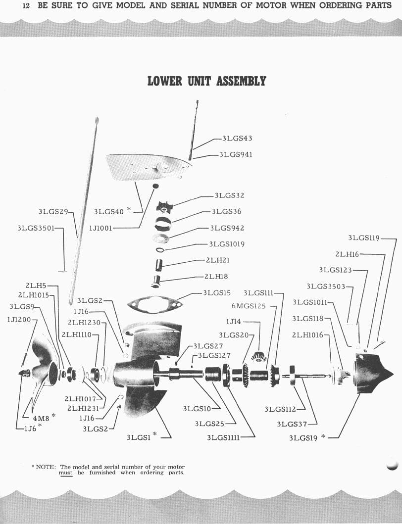

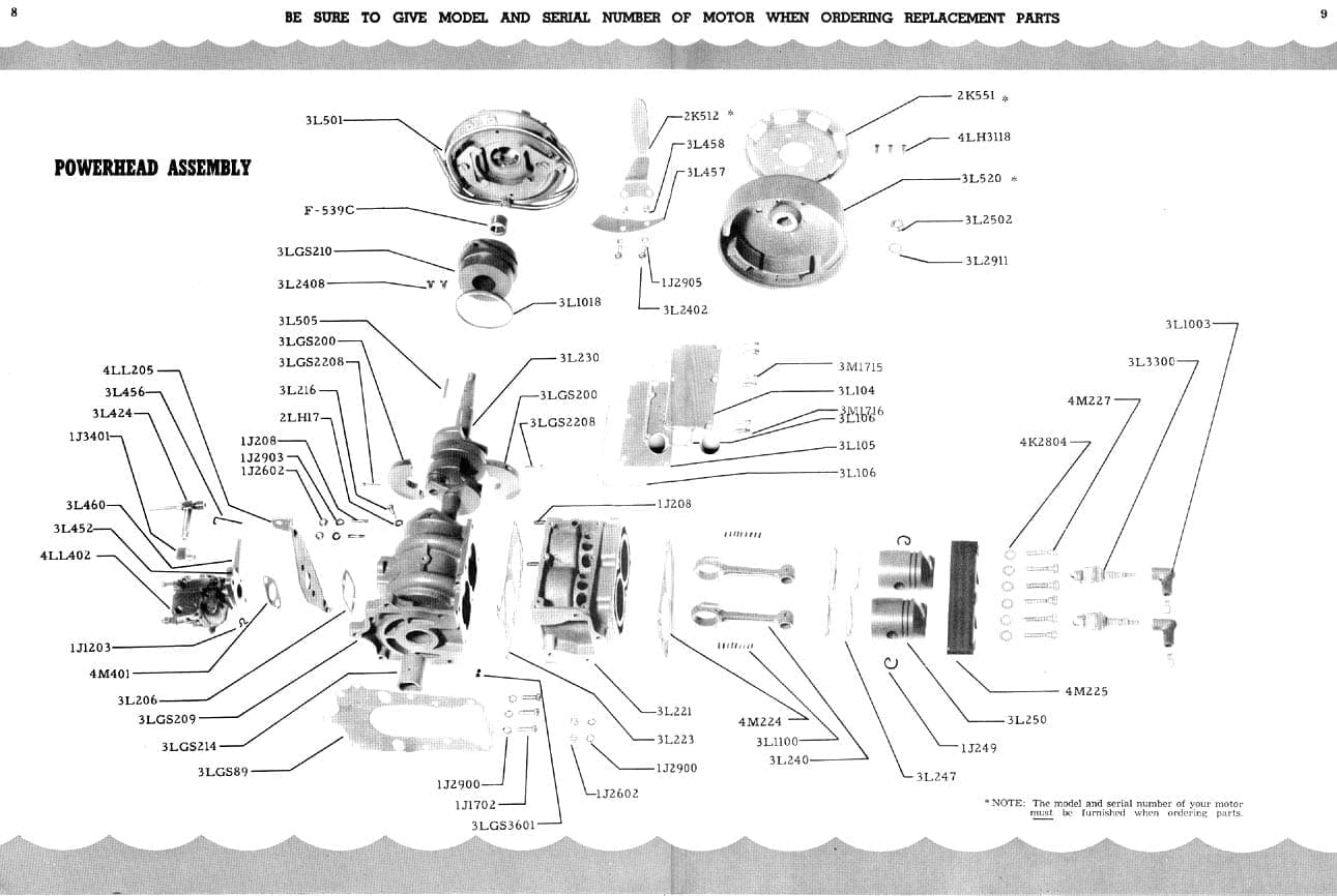

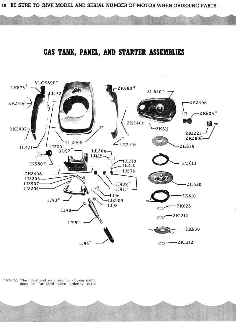

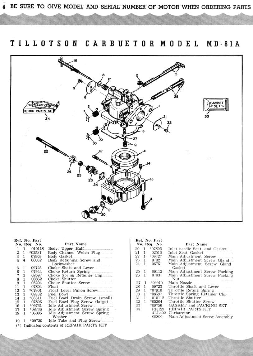

                    #184737
                      Parts List
                      6.-Carburetor-MD-81A
                      8-and-9-Powerhead
                      10.-Gas-Tank-Panel-and-Starter

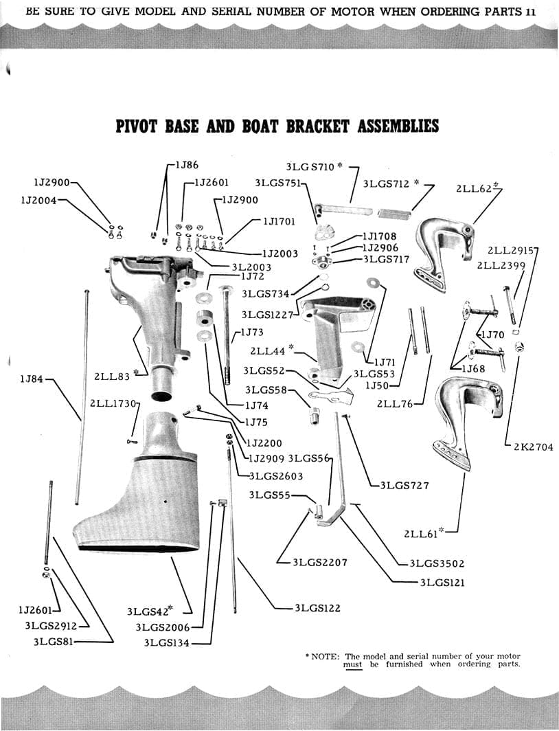

                      11.-Pivot-Base-and-Boat-Bracket-Assembly
                      12.-Lower-Unit

                      #184771
                      JOHN D.
                        You can adapt the cheaper OMC coils on those laminations without too much problem.
