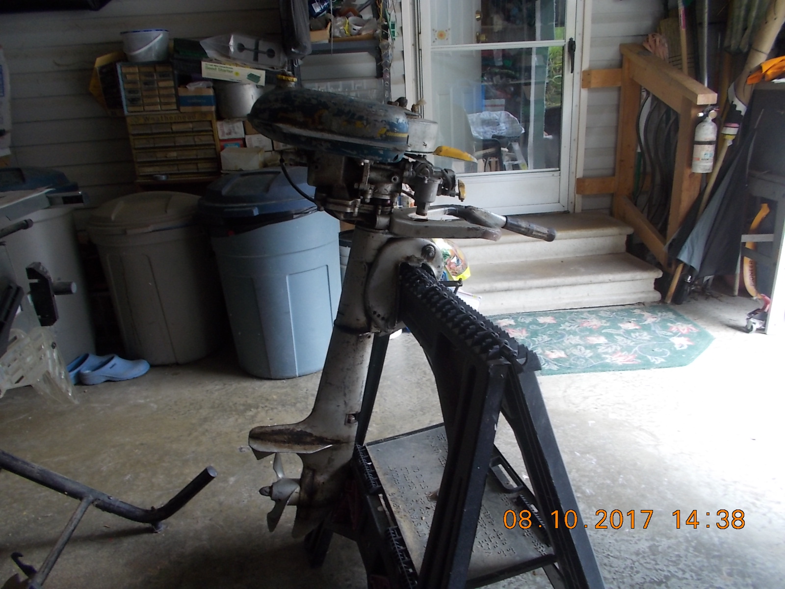

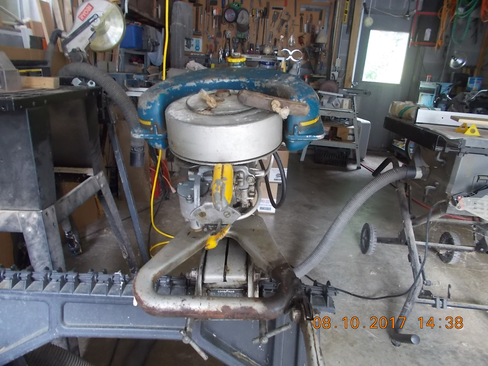

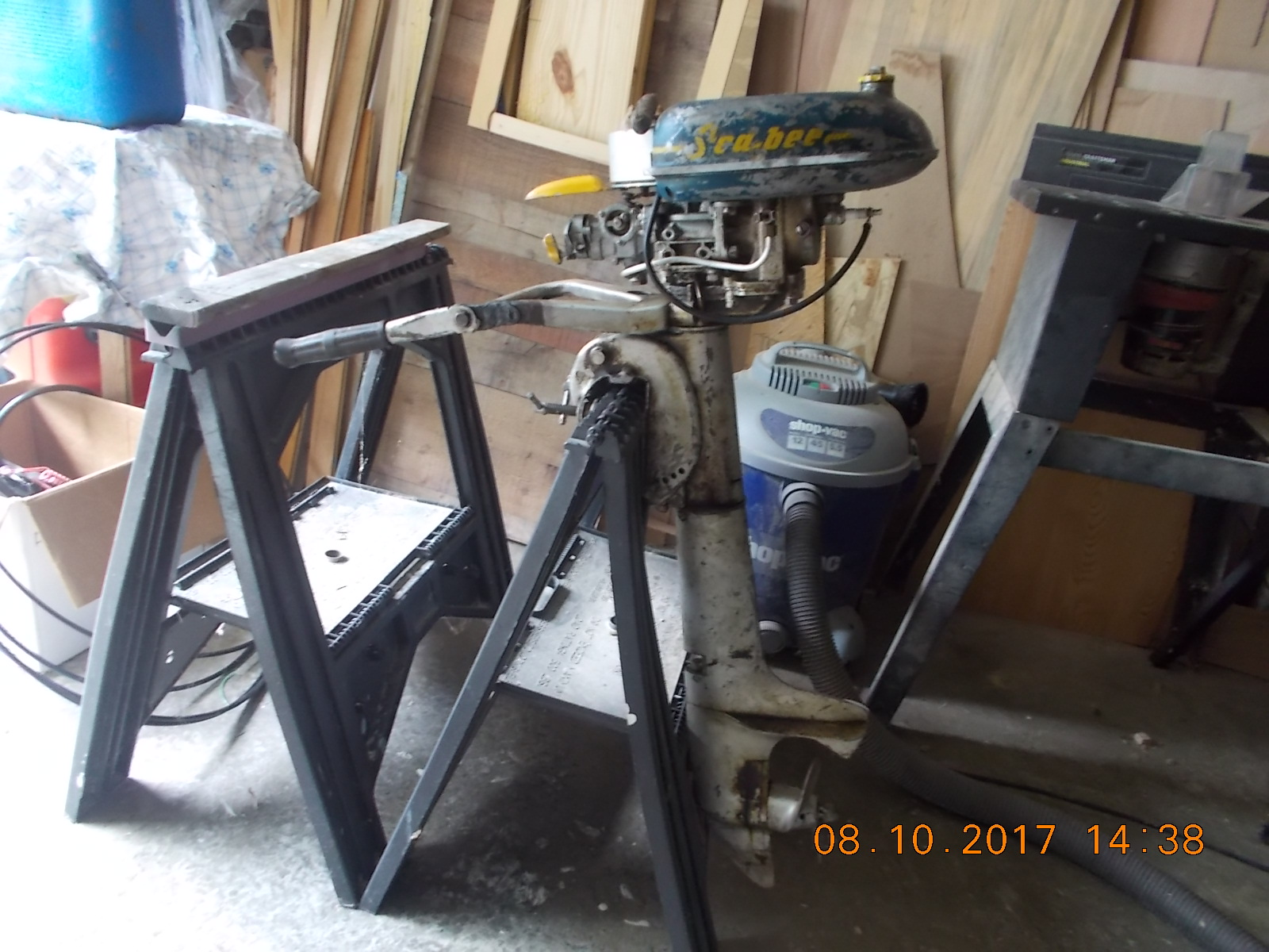

      I just brought home a Goodyear Sea Bee. Mod. # 1G4, ser. # 92379. It’s a 1947-48, but I haven’t found a serial number listto see the exact year. Good compression, dirty, scraped up, and greasy. Half a tank of OLD stinky gas! I haven’t checked further yet. I’ll flush out the tank and put in fresh gas and check the spark, then try starting it. Other suggestions? If it runs, I’ll just clean it up for now and restore it this winter. Where can I get decals, carburetor, and ignition parts? I’ll post some pictures later.
      Any other comments are welcome. Thanks. I’m new to the old motor game. Also have a 1954 Fastwin and a 1947 Mercury KE-7 waiting to be restored.
