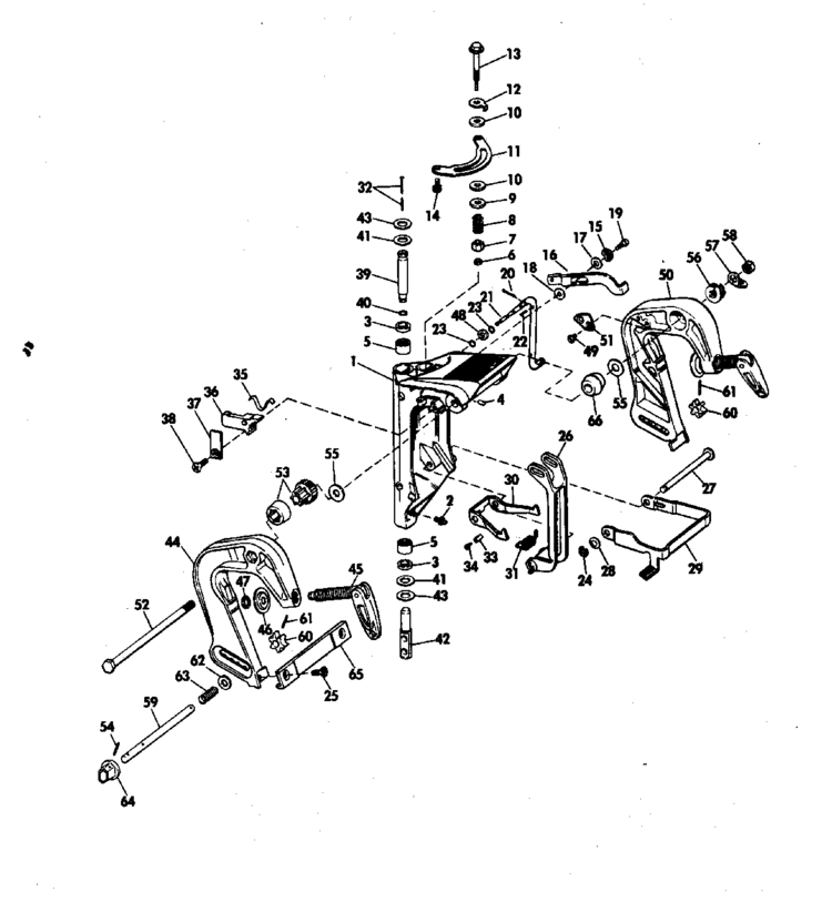

2nd question – the stern bracket was all the way up (had probably been that way for years). After much effort the only way that I could get the stern bracket down was to depress the ratchet spring with a screwdriver (part 35 in the image) so that the swivel bracket ratchet (part 36) would disengage from the ratchet wheel (part 53). How is this supposed to correctly disengage?

The tilt mechanism on that motor is a bit more complicated than most. There is a lever on the Right side, #16 in your pic, near the shift lever that needs to be pressed to release the motor back to a down position. I forget exactly how it works, but you have to lift the motor and depress the lever at the same time.
If I remember correctly, you also need to have the motor in Forward or Neutral to lower it. Might be wrong there. More help will be coming.
