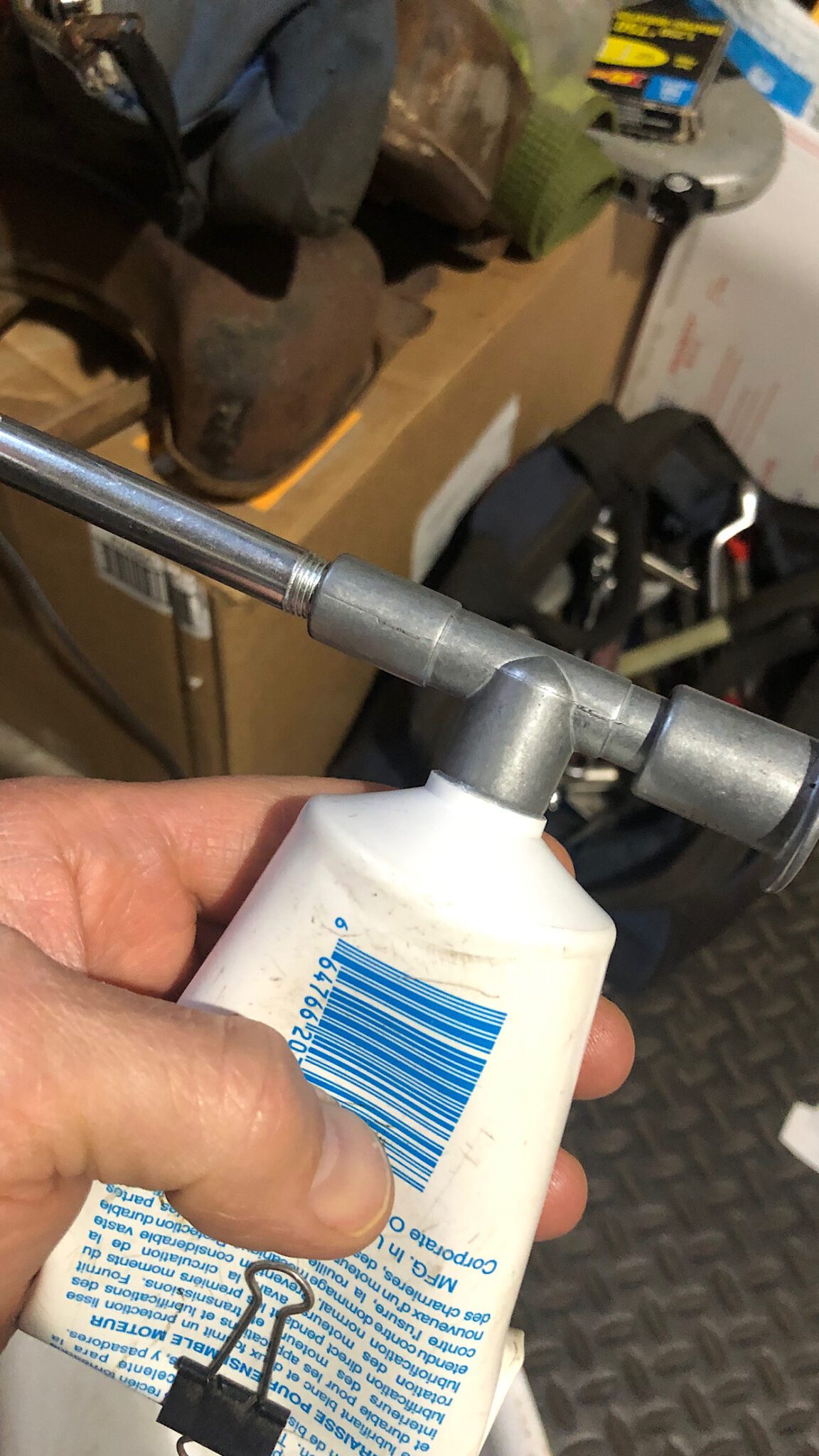

      I just got this mercury grease gun hoping for a nice low tech simple solution to filling gear cases with grease, lubriplate 105, etc
      Problem is the plunger won’t spring back and re-set after being pushed/compressed. It’s also very difficult to pull it back into position manually.
      Anybody have any experience with these guns made for mercury?

      #274541
        had one years ago……..it broke down also …it went in the  bin in the sky
        #274542
          OMC sold same or similar gun.  Mine didn’t work well, either.

            #274575
            T….in Wisconsin
              Possibly an air lock behind the plunger.
              #274612
              munimula
                Take the nozzle off. Inside you’ll find a spring and then a ball bearing. Often times the ball bearing will become stuck by old hard grease. Soak it in penetrant, remove , clean and reassemble. Pump away!

                  opposedtwin
                    Got it working! Thanks guys!
