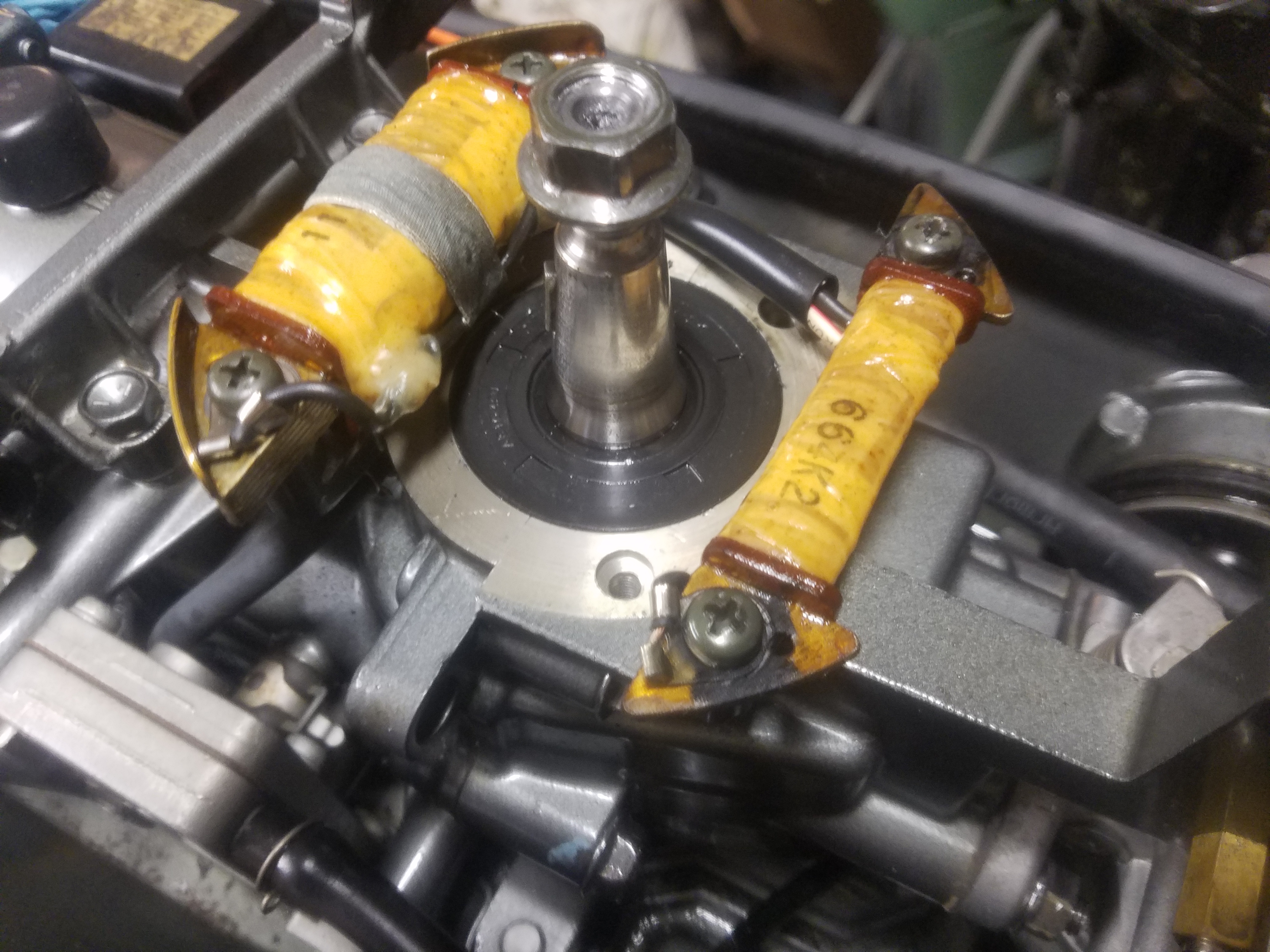

                    I hear some sort of popping like pressure being released that sounds like it’s coming from under the flywheel. I had it off and didn’t see any oil like there was a bad seal but there is a definite popping sound. I’ll see if I can record it.
                    #83425
                    bullie
                      https://youtu.be/cSpavBYoMQo
                      https://youtu.be/PXMJEXSbvf0
                      Slow and fast. It’s a popping sound. Not a rubbing sound. I’m gonna pull the flywheel again.
                      #83427
                      bullie
                        The plastic disc around the crank was popping up and down. That was the sound.
