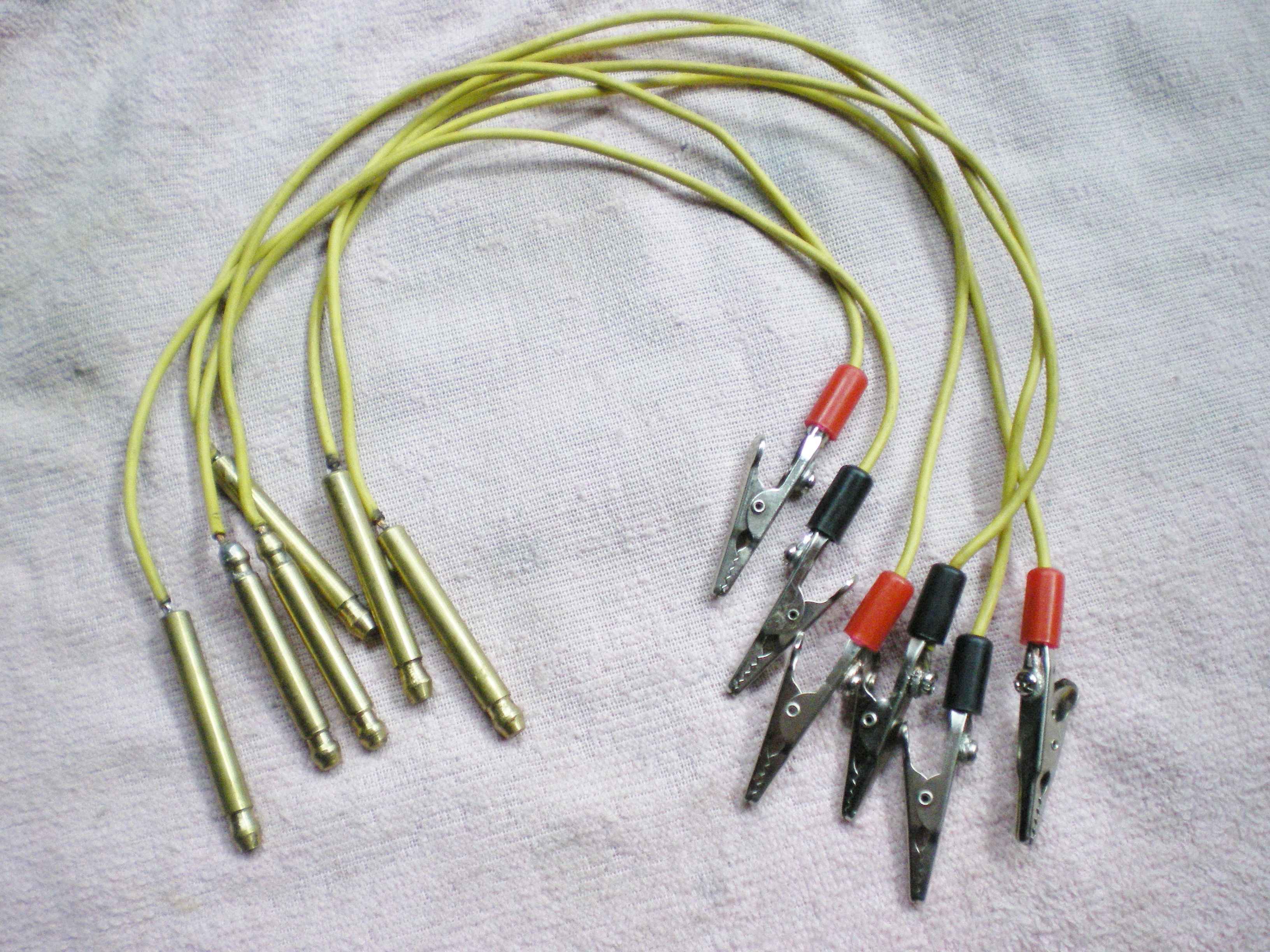

April 1, 2017 at 1:38 am #55280April 1, 2017 at 2:00 am #55281Just like what the others here said. In addition let me add that a spark can ignite any fuel or solvents nearby. This could be near a spark plug hole and cause that cylinder to fire.
