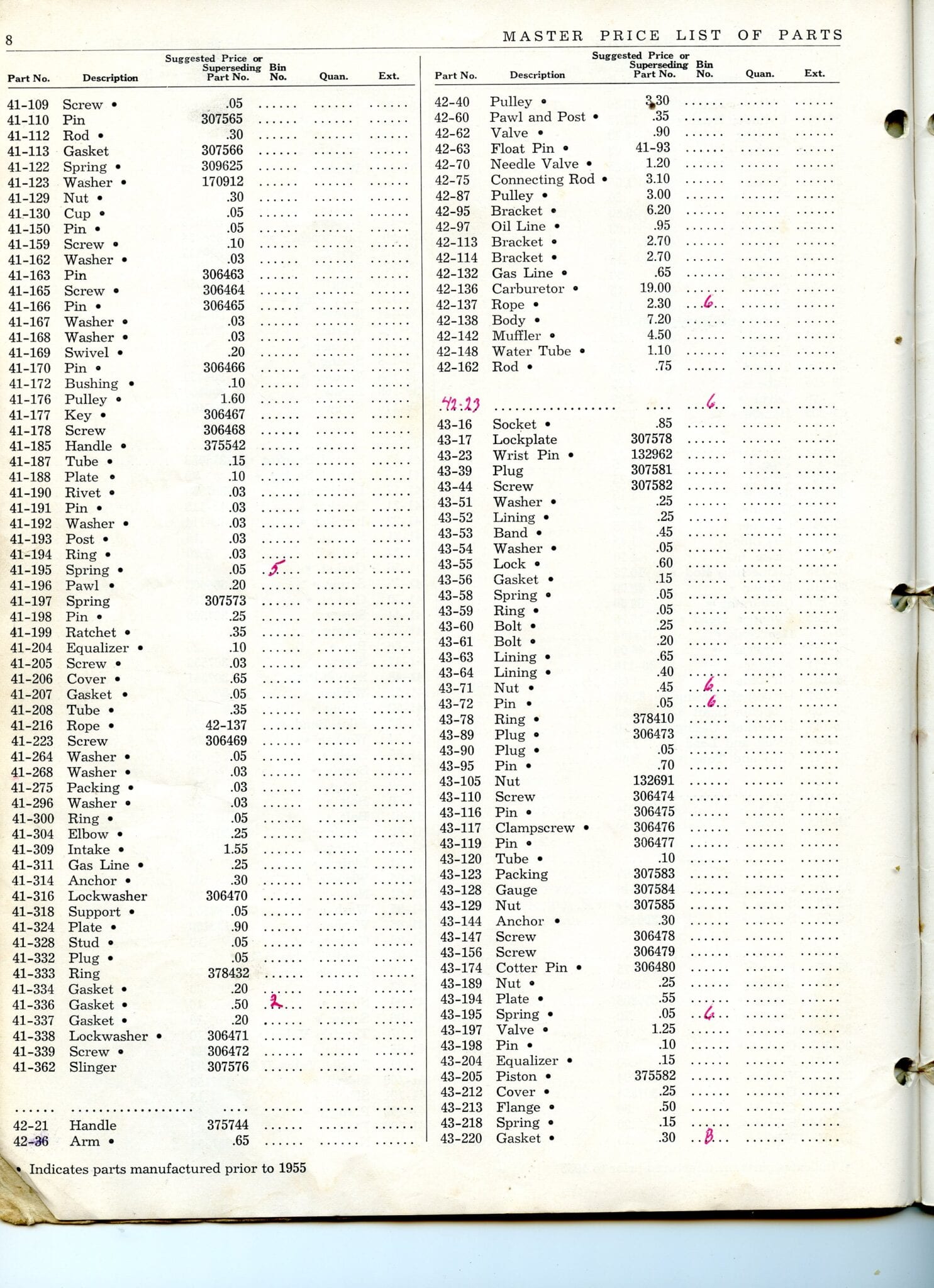

                The conversions are found in the parts price books. This is from 1964 price book For newer books, pad the number with zeros to make it 6 or 7 digits long. Thus 51-223 becomes 051223 or 0051223.

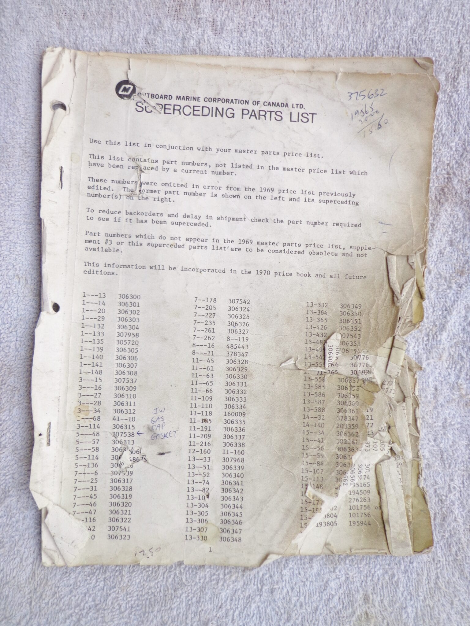

                      It took two days but I finally found my well used superceded parts numbers lists. Yee-haw!
                      I’m almost scared to open the pages in case they disintegrate.
                      DSC00032
                      DSC00033

                        Oh open it up.Some information is better than no information.
