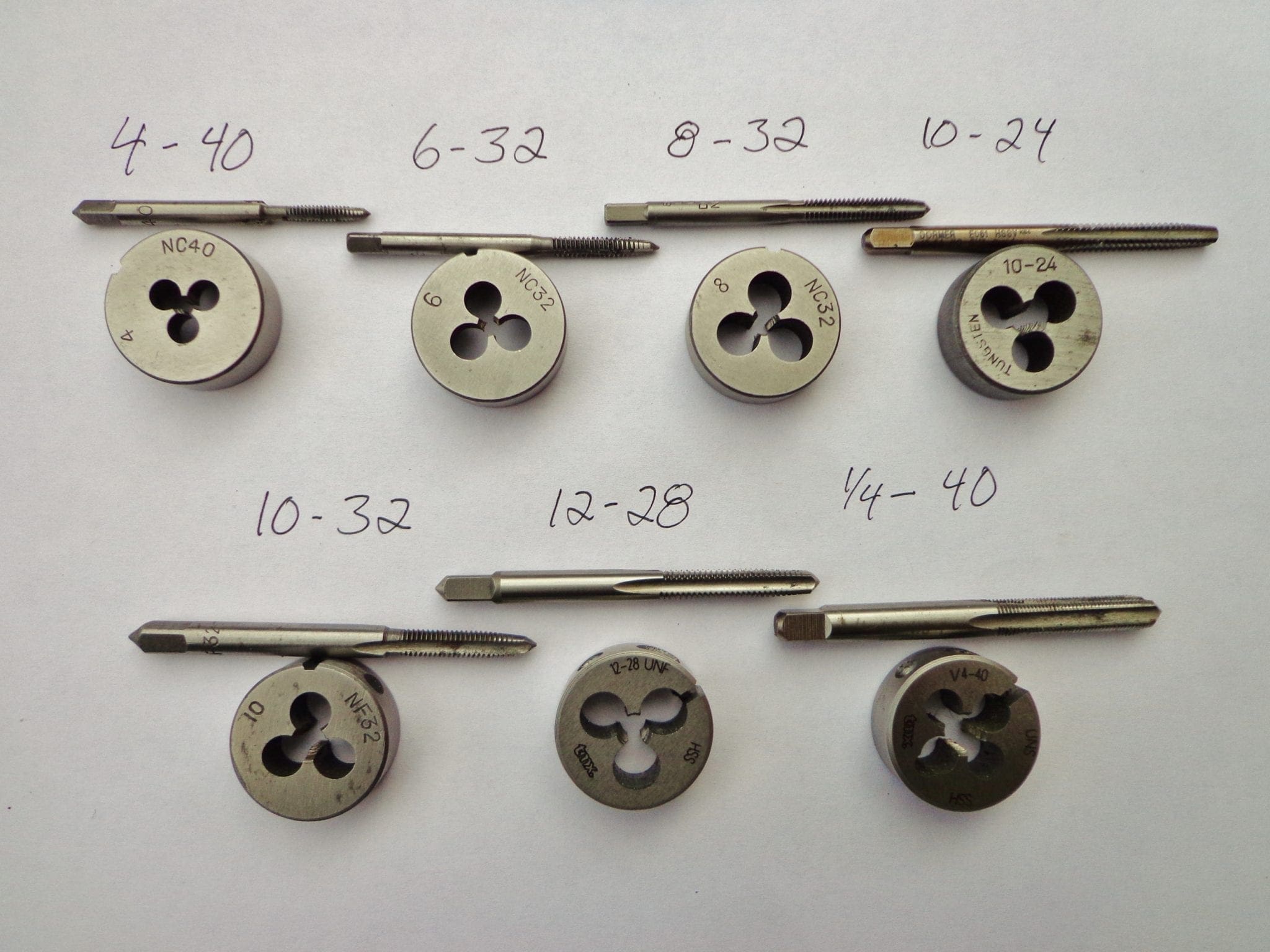

      Here’s some common and not so common taps and dyes I keep nearby when working on the smaller OMC classics. While everything is apart, I like to chase all of the threads to remove any gunk or corrosion. That makes it a whole lot easier when going back together. The 4-40 is used for carb butterfly screws while the common 10-24 is used mostly for exhaust covers, intake manifolds, and mag plates. The 6-32 will clean up the threads on the mags adjusting screw for the points. The special order oddball 12-28 is used for the tiller grip screw and 1/4-40 is used for most carburetor mixture adjusting screws. The 12-28 comes in real handy as lots of tillers I see have mangled threads in them.

        I use many of the same ones on the older Johnson motors “square tankers” Thanks for sharing Mumbles

            Some OMC carb butterfly screws are 5/40 thread. A not so common size.

              Mumbles – you are so right regarding having all of these taps and dies. I recently had to go pick up a 4-40 to clean up one of the carb butterfly screw holes when I rebuilt my RD-18 carb. I needed the 12-28 tap on another rebuild and although I didn’t have one, I was able to borrow one from a neighbor who was a machinist. Always good practice to clean up threads during the rebuild process.

                  Great advice, will have to find the 12-28 and 1/4-40 ones for sure…
