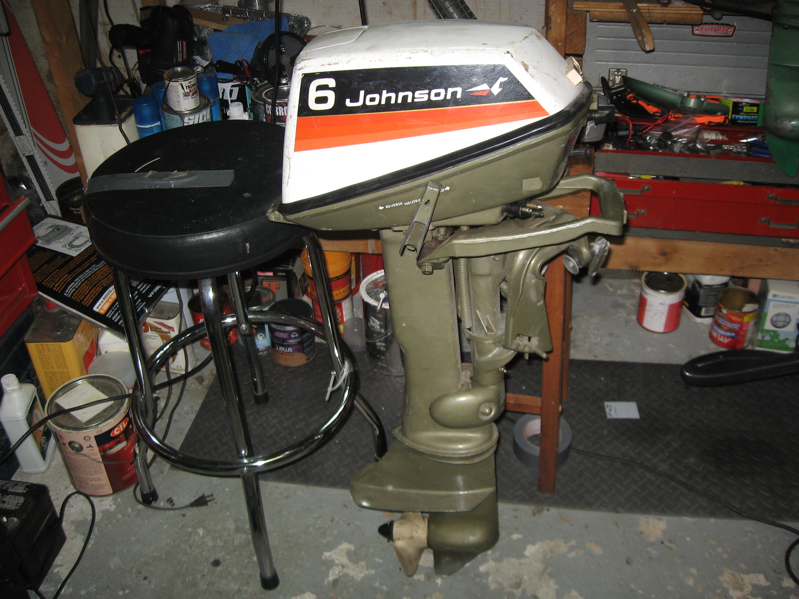

      Had to grab it at $60 CDN nice Evinrude 6hp 1974 ….. Ok it is stuck but my pleasure will be to free it up during the coming snowstorms πŸ™‚
      the engine is super clean no oily residue inside anywhere to speak of . Starter gear don’t even look used much . Cowl inside surface is spotless
      It looks like it was mostly in storage. If it did not go for a swim the innards are likely fine.
      I figured for a price cheaper than of a prop it is a good gamble .
      it was listed at $150 for a few weeks so I set the hook at $60 "as a parts motor" and got a nibble πŸ˜€
      pics to come

            update…… before pics….
            well I had a closer look

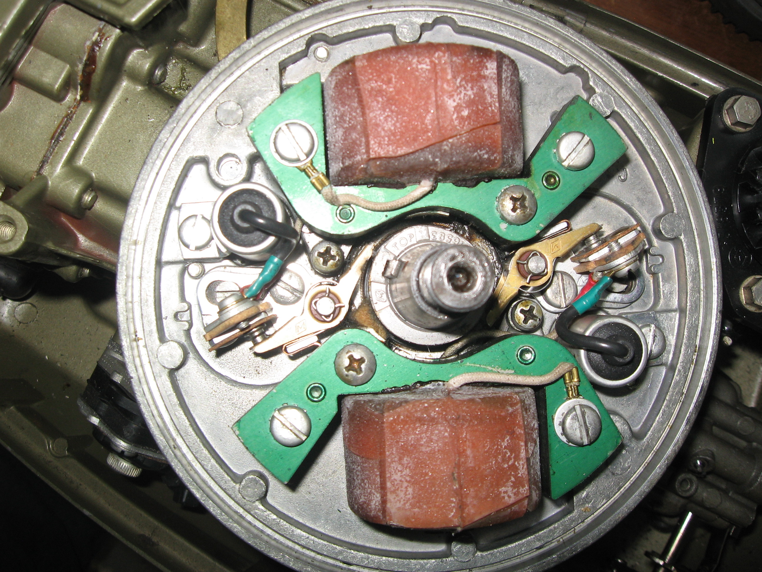

            the flywheel came off and found nicely cracked coils πŸ˜€
            thermostats bolt covers in a virgin state
            this thing was in a mecanic ‘s back shop marked… " for pieces" yet none were missing
            I have a feeling it was brought in due to faulty ignition (obvious) and remained untouched for years after the owner never followed-up on an expensive ? estimate
            whatever happened it is now on the road to recovery…… I may even swap out my nice 1962 turtle for a "newer" 1974 next summer if it purrs ok

                MY TURTLE IS A 9622A I GOOFED…. IT IS A 1966 SHORT SHAFT …. I confused that mid 62 sequence of numbers in the mdl#

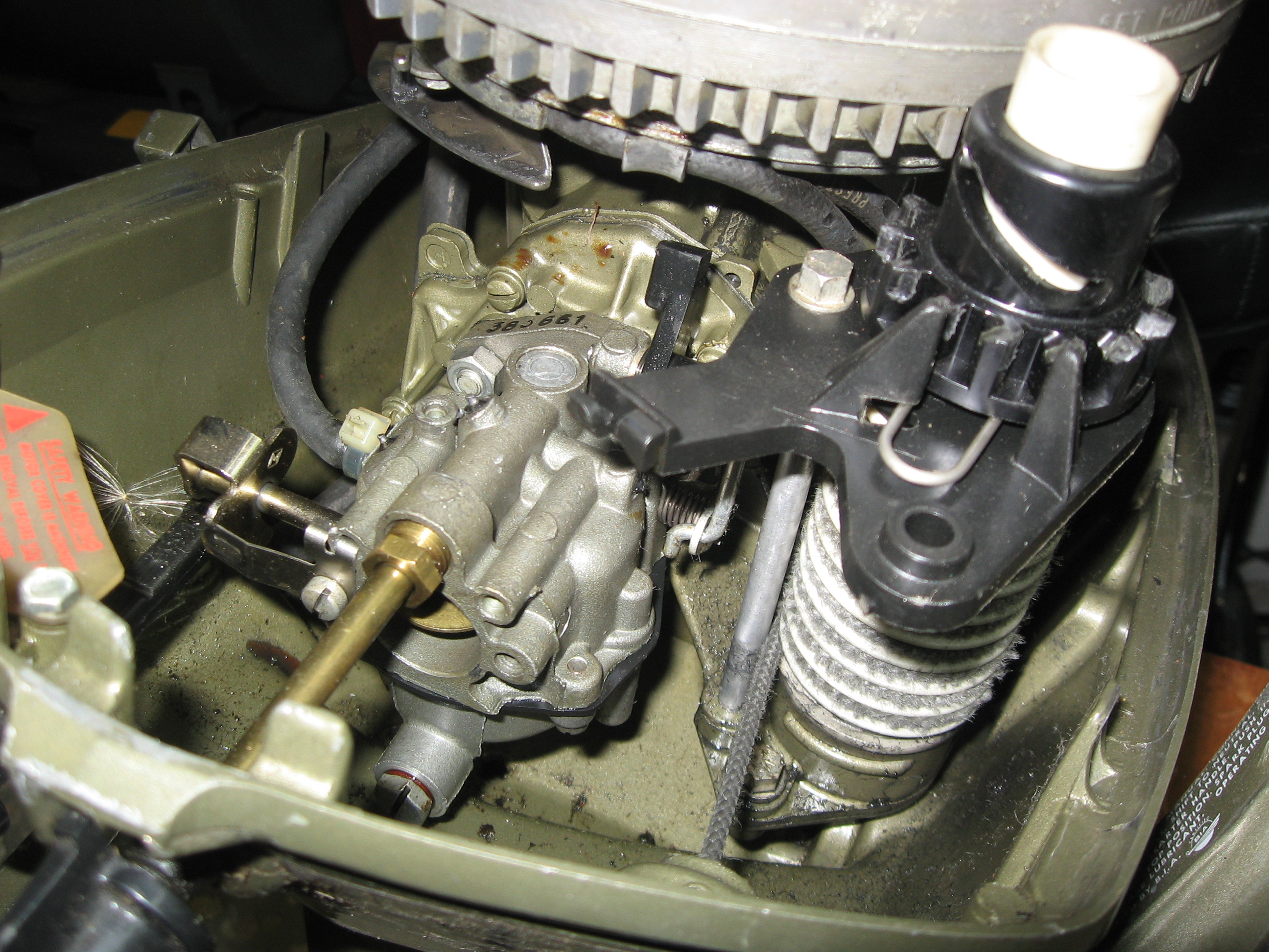

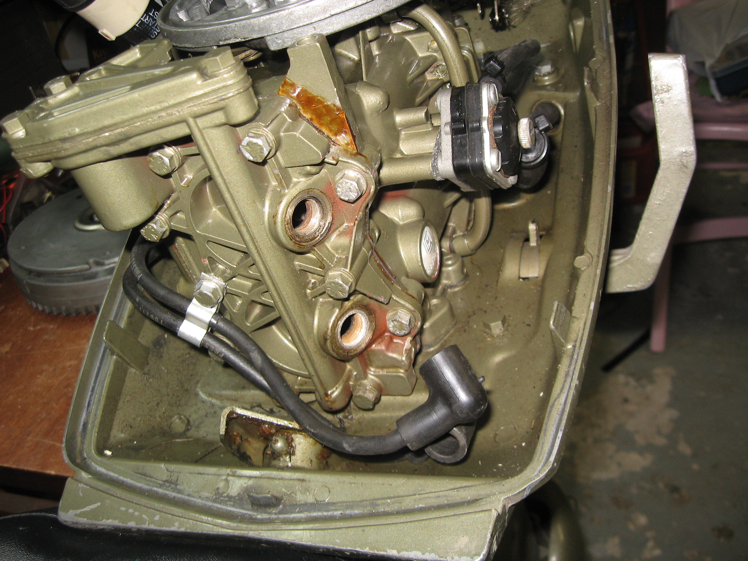

                here is a few pics of the new arrival

                  That’s a beautiful little motor! It likely will take very little to free it up and get it going. It should be a very nice runner. I have the 1969 version of this motor and it certainly is. It appears that you are probably right about the history of this one. Very nice find.
                  -Ben

                      I fed it some Deep Creep a few times and will let it simmer a few days but… i will pull that l.u. for an impeller replacement
                      i’ll check the oil in the gearcase but visually I see no drips or stains anywhere and it looks tight as a clam
