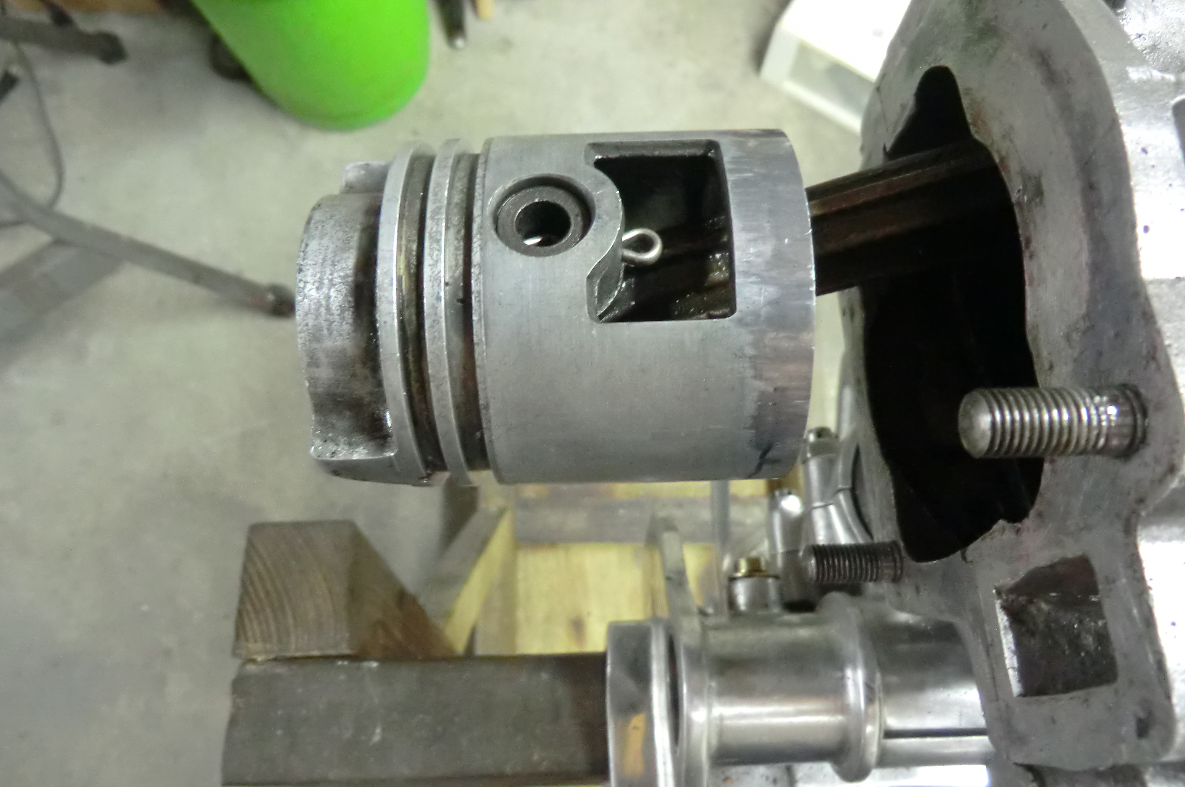

      I noticed a couple of guys on you tube starting Johnson K45’s like mine and they were not pulling nearly as hard as I’ve been. So i took a cylinder off that I remembered having trouble putting on. It’s hard to tell by the picture but the bottom of the piston skirt is shiny from rubbing. The piston measured around 3 thousands out of round but it was kinda hard to measure while it was still connected. I believe the rod is bent. I know there are ways they fix them in the manuals. I was thinking about trying to take the studs out of the crankcase and see how the cylinder lines up but I wanted to run it by you guys first.
      Thanks for the help

              #61085
              Tom
                The most common way to bend rods is to unbolt the jugs, and accidentally bump the jugs downward before taking them off of the pistons. The bronze rods are quite easy to bend. While running?.. very unlikely.
                There are a couple of different ways the rods can be bent. Side to side won’t show up, since that’s the same orientation as the flex in the wrist pin. Up and down will show up just as you see in the photo you attached. If the shiny spot is evenly front and back, the bend was likely just up and down. If the rod is twisted, all bets are off, and you’ll need a jig to bring the rod back into alignment. The jig I’ve seen has two parallel rods, one goes through the big end, the other through the wrist pin end.
                Tom

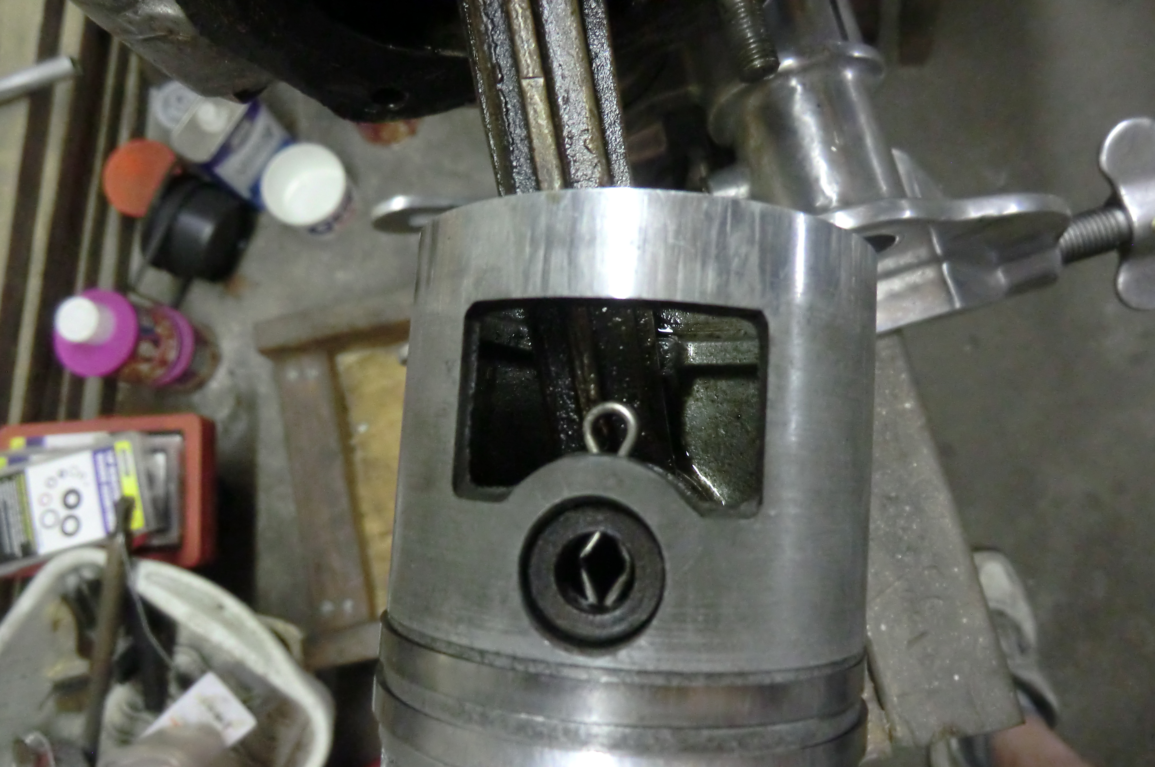

                Goman
