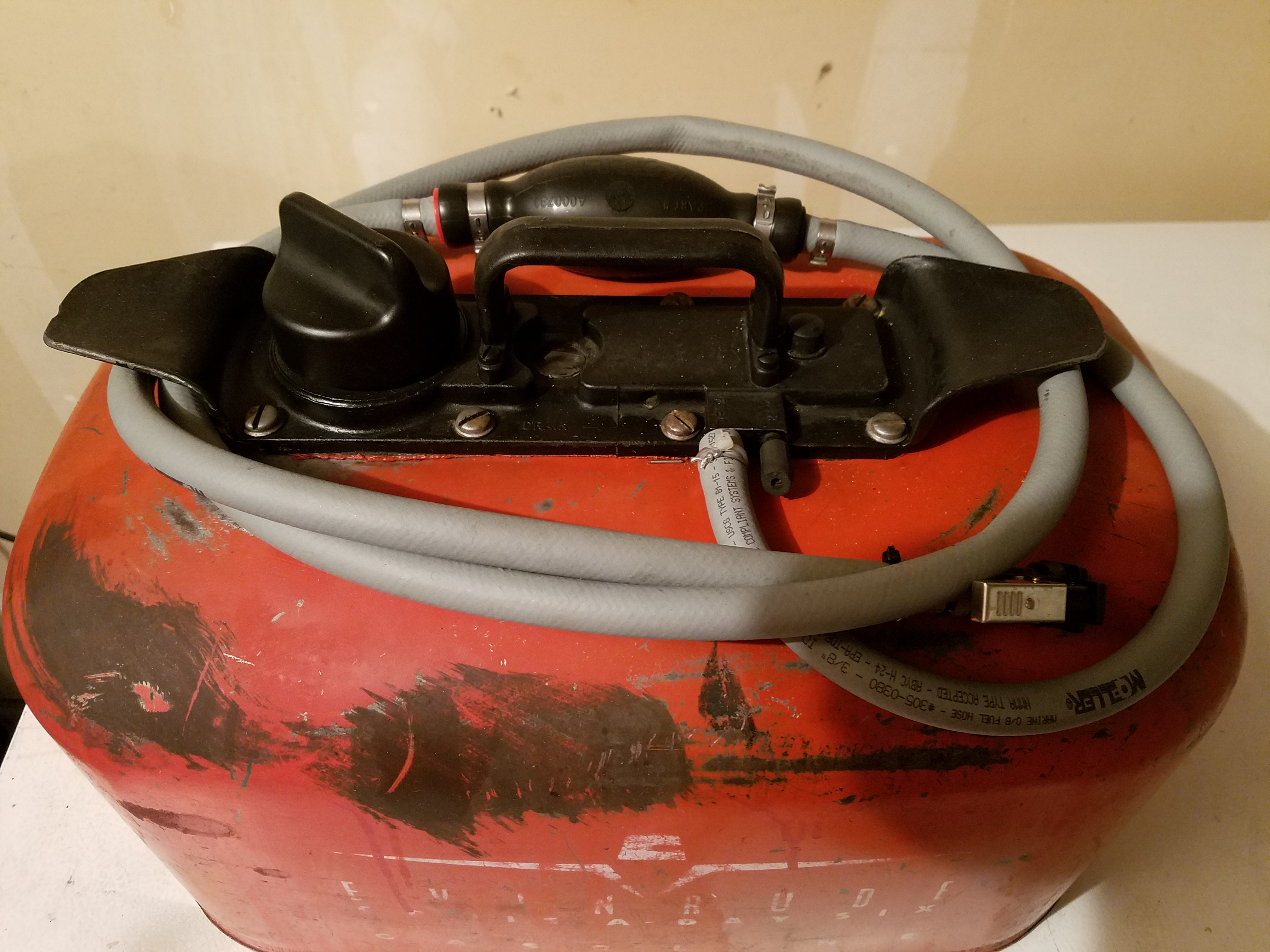

It might be a stupid question but has anyone ever converted a Cruise A Day tank to a single line system? I restored a 1954 Fastwin 15hp to a single line system and I wanted to use the original CAD tank. I removed the pressure line and hooked up a regular line to the tank. Works great with no issues.

May 20, 2017 at 7:38 am #58031Looks like a good idea if you want to maintain some originality with a conversion. Looking at it you could probably use the tank black button to prime instead of the squeeze bulb. Also you could plug the air line fitting instead of leaving a stub of hose open and just crack the black fill cap open to vent the tank. Also a black fuel hose would make it look like an original fuel set up. Personally I like the original pressure set up as they work well with no issues and I feel they add to the experience of using a 1950’s OMC engine. But if I did a conversion I think this is a neat idea to use the original tank for looks. The thought of using a plastic tank always turned me off. Bill,

May 20, 2017 at 11:39 am #58040I have not. I have several pressure tanks and several suction tanks. If I converted a 50s motor to a fuel pump it would be for the convenience of being able to use a single line tank that I could buy a replacement for anywhere. I like the pressure system also and believe it adds to the experience of running a 50s OMC like Billy J said. If a person didn’t have a suction tank and needed one, this is certainly a workable solution. To me though, the single line and squeeze bulb has already taken away from the originality enough that I wouldn’t worry too much about the tank. That’s just me.

May 20, 2017 at 1:51 pm #58049I haven’t done it myself but I think it was the late Art Sesselburg who did it and used the original dual fuel/air line so it appeared to be a functional tank. Up near the motor end connector, he cut the air hose and installed a small filter, something like a gas filter used in small outdoor equipment, to keep dirt and dust out of the tank. It looked good and no one could tell the difference with a casual glance.
Thinking about it, a person could go one step further and cut the air hose under the motors hood. That would really fool the masses!
May 20, 2017 at 5:03 pm #58057When I do an oil recovery system on 50s OMCs, I add a fuel pump, yet keep the original pressure tank. What used to be the "AIR" line is now the oil return line back from the motor.
Looks original, runs off a fuel pump, and contains the excess unburnt fuel/oil mix.
