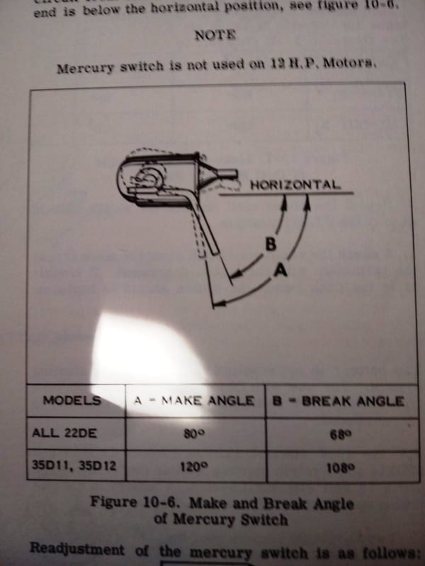

      #200547
      outboardnut
        I thought I would include this info also
        Its from a Gale service manual
        mercury-switch
