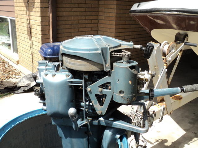

        #281116
        CHUCK
          Not sure if this a “Dyna Start”
          Not mine;  just a picture from my files
          25hp4
          25HP-Elec-Start-1951

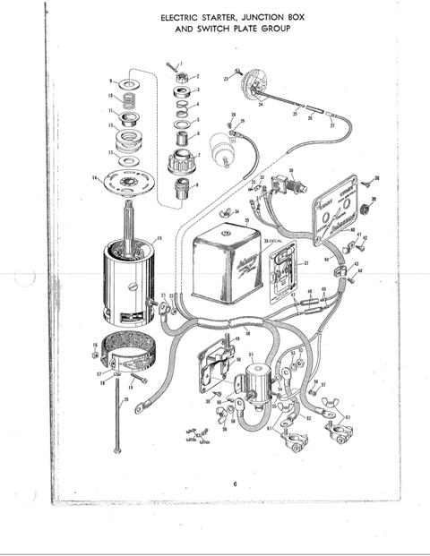

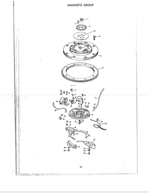

          #281126
          outboardnut
            seakaye12 picture is probably it
            These pictures are from a 1954 25 hp parts catalog
            In seakaye12 picture I would not think a traditional ring was used

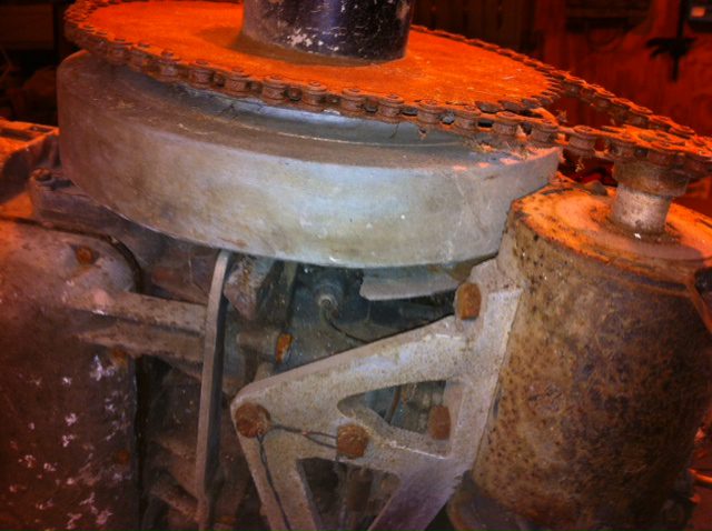

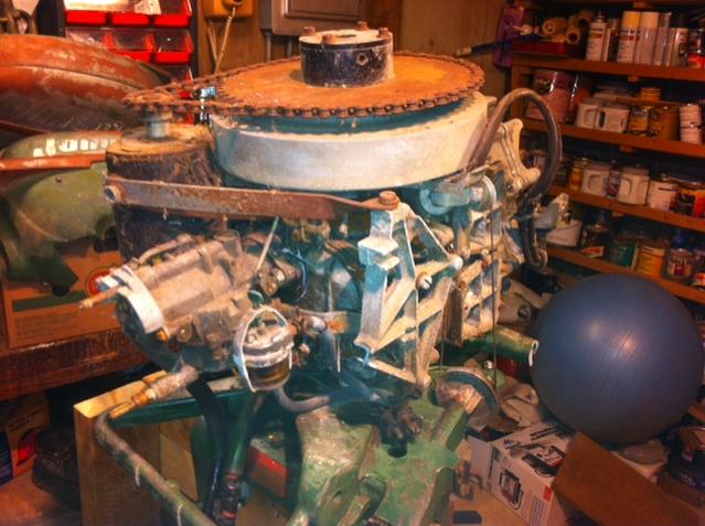

            #281129
              Here’s some photos I found years ago.  Not sure if it’s an aftermarket kit or homemade.
              RD-Electric-Start-2-Chain-Drive
              RD-Electric-Start-Chain-Drive
              #281143
              CHUCK
                That chain would sure get to whirring.
