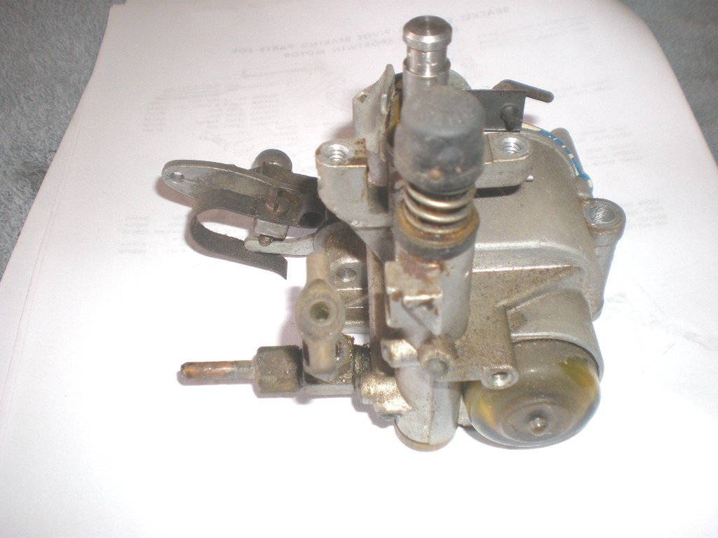

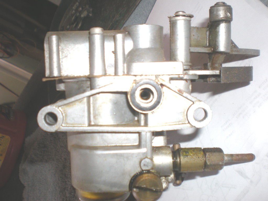

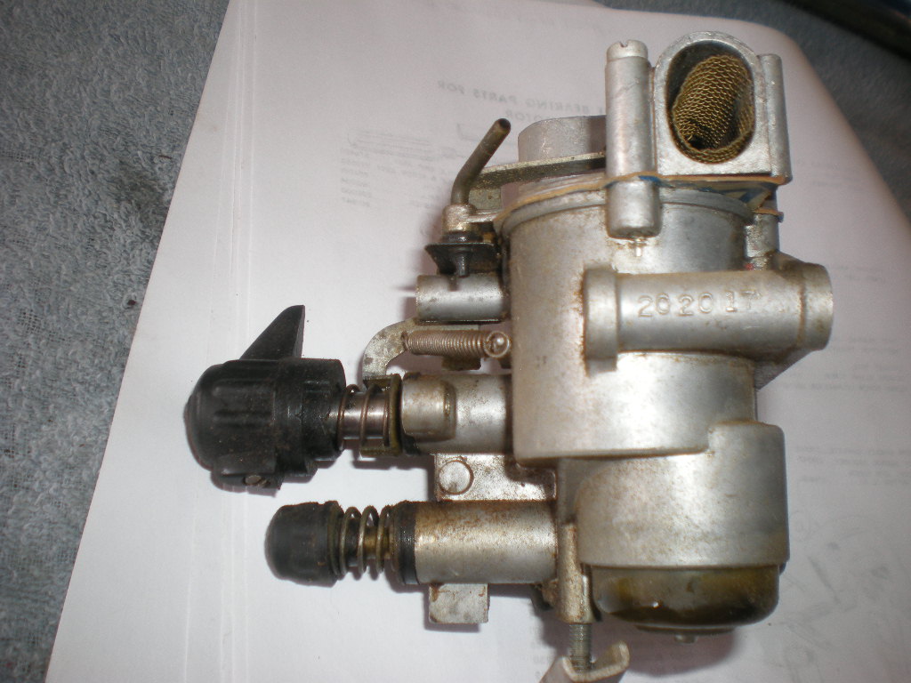

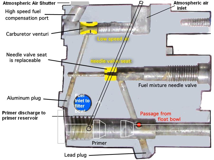

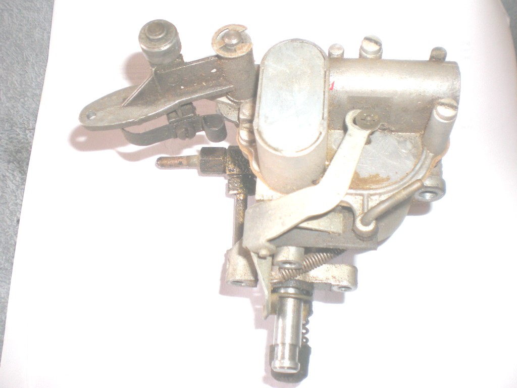

June 10, 2016 at 2:09 am #38027quote Buccaneer:One of these? If so, good luck 😀Ranks right up there as one of the worst things that ever came out of Evinrude. Just my opinion.
June 10, 2016 at 7:47 pm #38074Last night I never would have believed this would happen. Thanks so much for the pictures of the carb Buccaneer.
