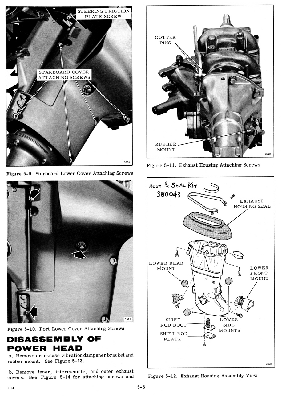

          http://www.leeroysramblings.com/OMC_9.5.htm
          CajunCook’s 9.5 exhaust seal leaks info
          The 9.5hp Evinrude/Johnson motors were known to have exhaust leak issues that would make a motor run poorly. Also, vibration dampeners were not added to the motor until late 1966 and definitely in 1967. So, the 1964 to 1966 motors idled a bit rough due to the excessive vibration, so the dampeners and slight carburetor adjustments improved idling from 1967 an on.
          Suggestions:
          – If you are running this motor in a barrel, then put a fan next to it so the fan can blow the exhaust gases away from the motor. The 9.5hp motor was built compact and sits low in the barrel, so it has a tendency to inhale its own fumes and idle and run very poorly. (Usually not a issue on the open water and while running and moving along.)
          – If the fan does not help much, then remove the motor cover. If the performance improves then you have a exhaust leak issue.
          There are four known areas that can leak exhaust gases inside the motor cover and smother the motor. That is why you have rev up the motor to run rich to stay running.

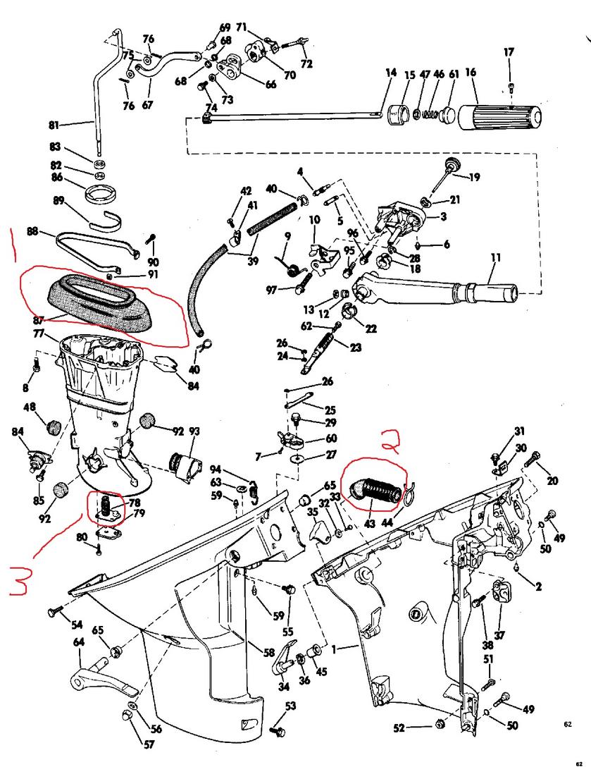

          Leak 1 = Is in the first attachment picture and is part # 87 SEAL,Exhaust housing. If torn, cracked, miss shaped over the years or trash collected in between the side and exhaust housing then exhaust gases can accumulate up near the motor.
          Leak 2 = Is in the first attachment picture and is part # 43 HOSE,Exhaust. If cracked, torn or loosely clamped then exhaust gases can escape and accumulate in the motor cover and smother the motor.
          Leak 3 = Is in the first attachment picture and is part #78 BOOT,Shift rod. If torn, cracked or missing then exhaust gases can escape and accumulate in the motor cover and smother the motor.

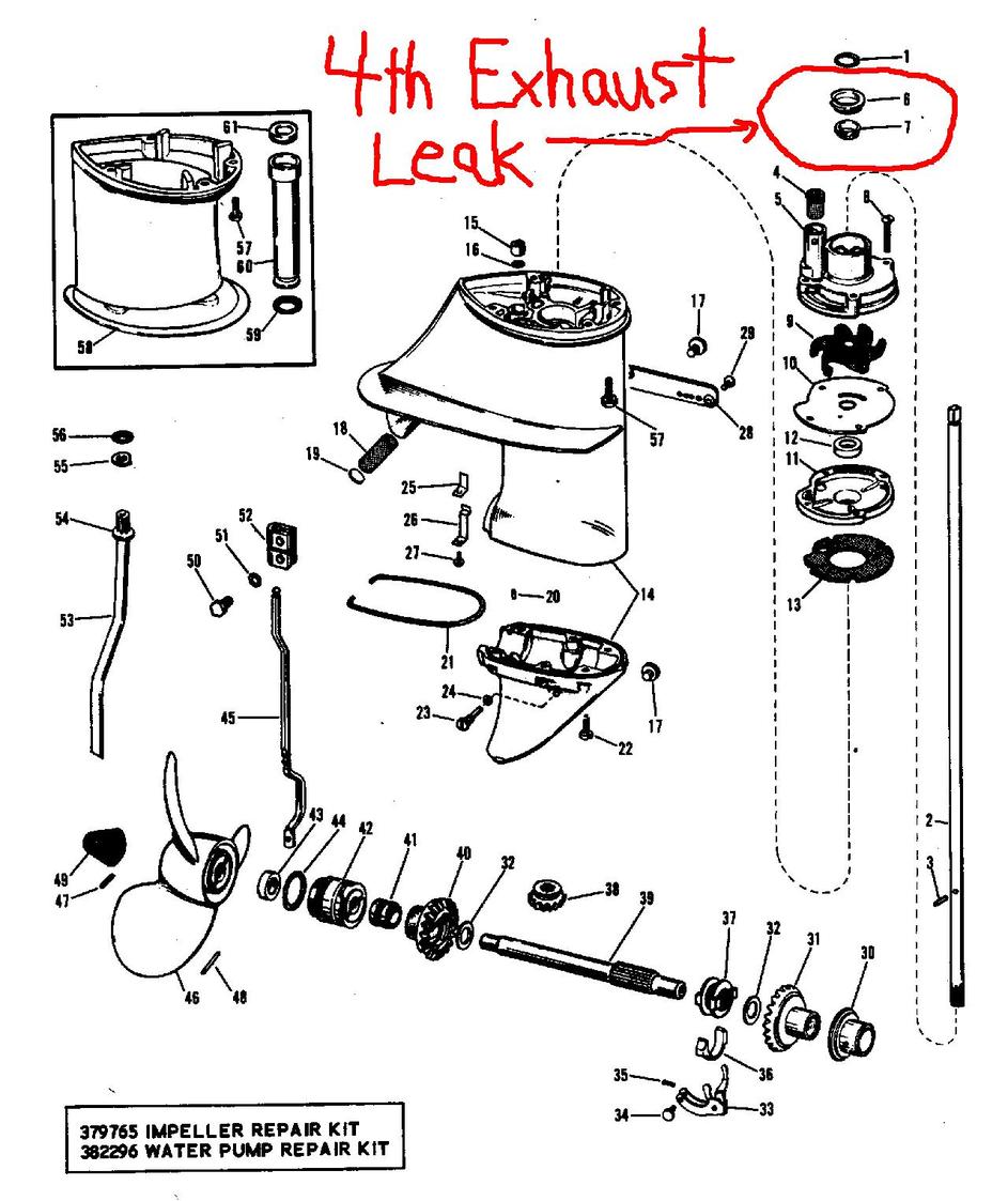

          Leak 4 = Is in the second attachment picture and is parts #6 SEAL,Impeller housing and part #7 WASHER,Seal. If missing then exhaust gases can escape and accumulate in the motor cover and smother the motor.

                    Also I will start focusing on the areas it can leak (certainly appreciate the pointers in the messages sent about that). I’m not much of a mechanic but I think leak spots 2 & 4 can be eliminated. I replaced the water pump a couple of years ago so those seals should be OK (I replaced the impeller a couple of weeks ago & they seemed fine then). From what I can see by just looking, the exhaust hose (#43) is OK. I’m not sure how to check the shift rod boot – l will pull the lower unit and see if I can spot it and tell if it is there and if so, what kind of condition it’s in.
                    Thanks again to everyone for the input and the links – the PDF’s are great and the part numbers really helpful.
                    #68198
                    David Stanton

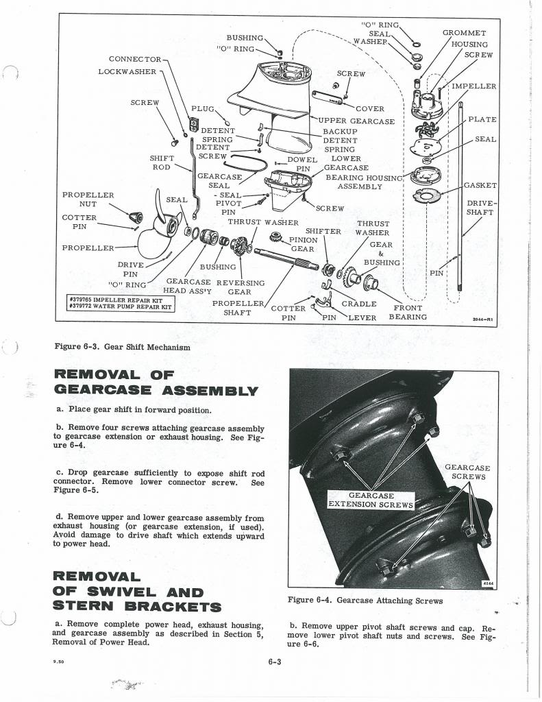

                      You can’t see the shift rod boot with the lower unit off, you have to disassemble the housing to see it and that’s a big job – it’s on the end of the shift rod that’s up in the housing. If it’s bad, the motor will still run fine with the cover off, and when you accelerate from slow to fast with cover off, you will momentarily see exhaust billowing up from inside the housing.
