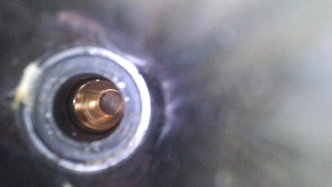

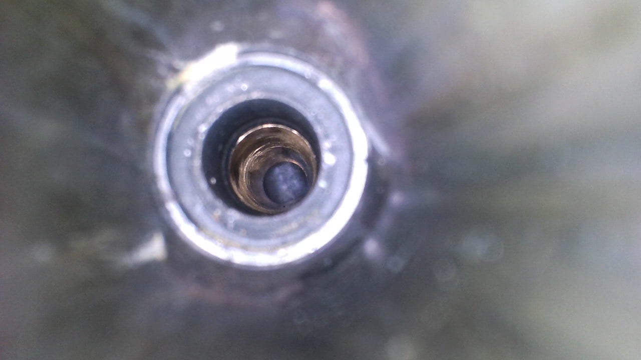

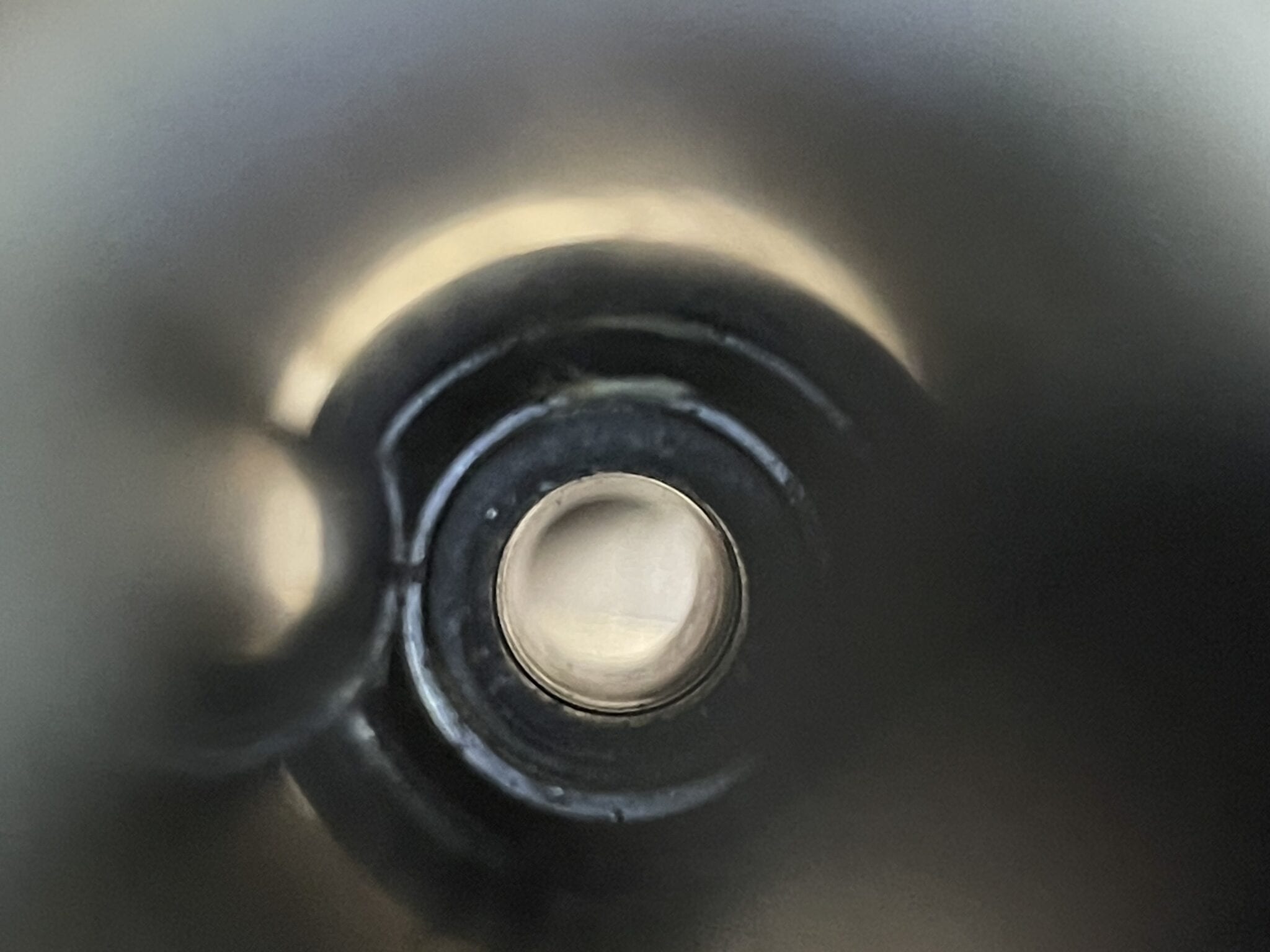

          Thanks. I can’t tell if it’s leather or rubber. I know once made a tool to remove that seal but what else can be used? I attached some pictures of it but can’t tell which material it is.

          #233650
            It’s been quite a while since I worked on mine, but I’m thinking the seal is leather,
            and yours looks intact, and it might be best to leave it alone.
            Those old gearcases used grease that was designed with water ingestion
            in mind. Even if you were able to put a modern lip seal in there, the driveshaft
            is likely to be pitted or grooved and the new seal would leak anyway.
            Perhaps someone in the know will give you better advice.
