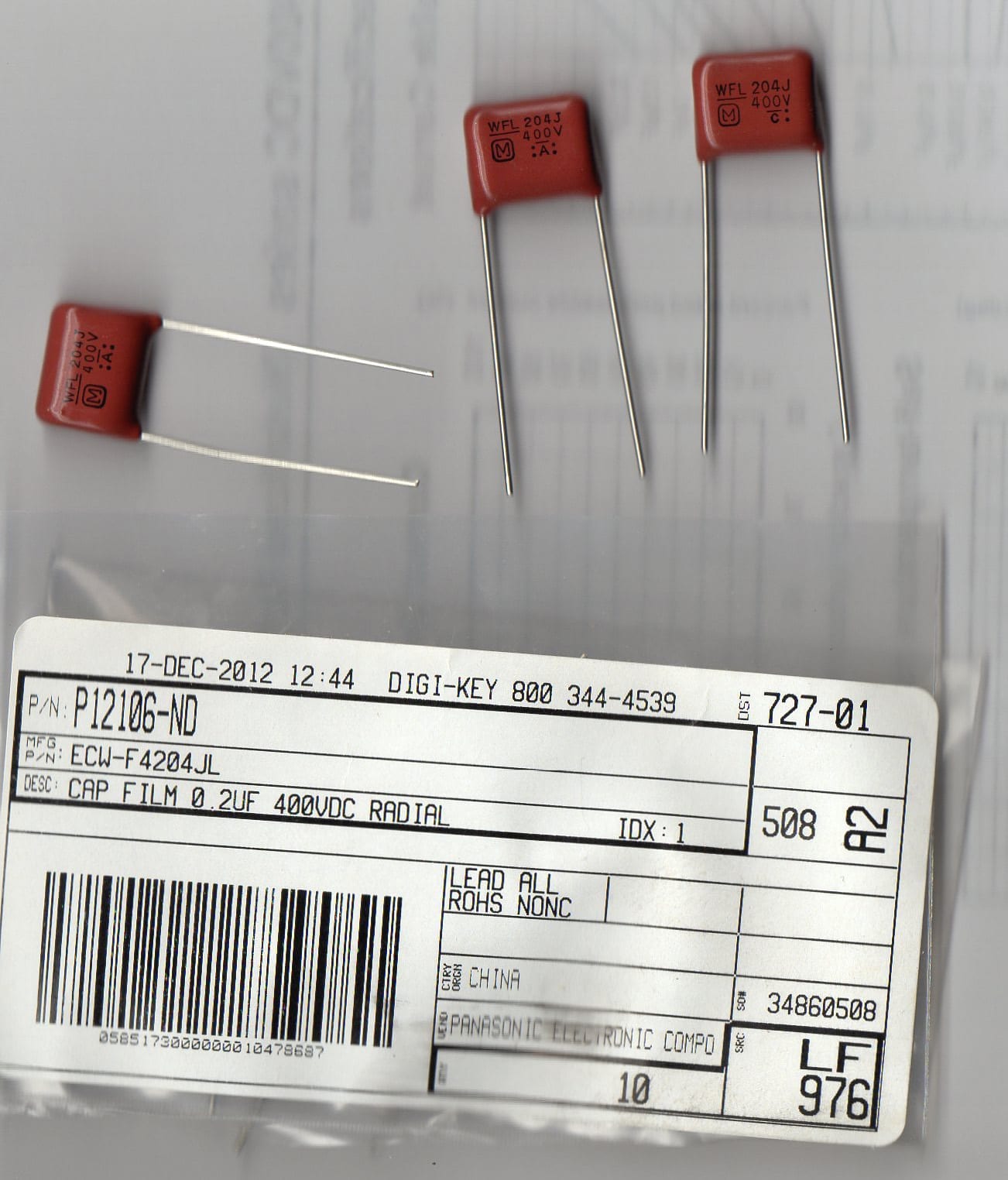

            I use these instead. Haven’t failed me yet. And they are $ cheap!
            Capacitors-2-from-Digi-Key
