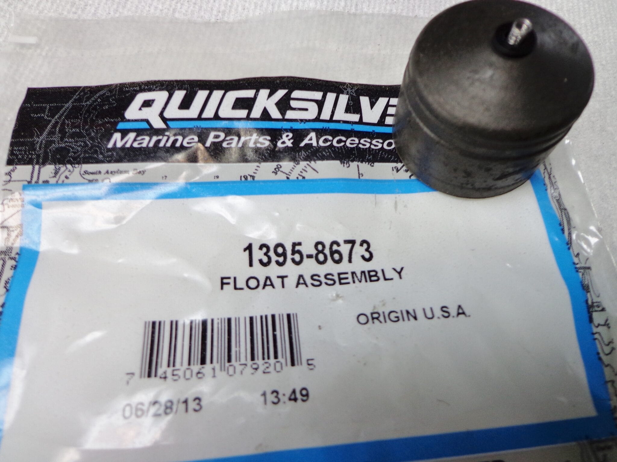

          The Merc floats work great and I have installed several in my TN motors. The small spring in them has to be removed and then I drilled them out to get a friction fit on the needle. With a friction fit, the float level can be easily adjusted.
          DSC00008

            #238021
            Jim Brizzolara
              I think you’re right. The Merc part number I have for the float is a different number than the one in the picture. Thanks for the replies.

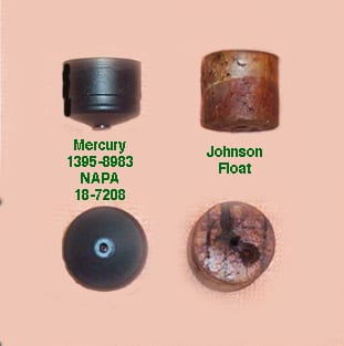

                  #238098
                    Whoops, didn’t even think about the different OD’s. The part number shown in my earlier photo is the current P/N for the one in this older photo.
                    Mercury-Johnson-Floats

                    LLOYD LAUTNER
                      TD/TN floats are 1 3/16 diameter and 1″ tall. HD float is 1 1/16 diameter and 3/4″ tall. I would make one from cork and seal it with old time acetate dope, but whatever makes you happy and floats your cork.
