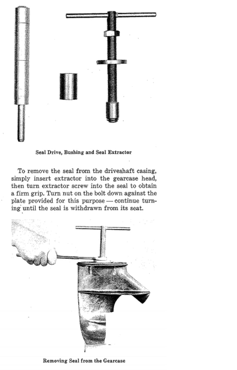

        It’s been too long since I’ve worked on mine, and I can’t find any photos
        of my lower unit apart. Did find a photo of a seal extractor for one,
        not that it will help!
        I’m guessing most people either use Lubriplate 105 or
        John Deeere cornhead grease.
        seal-extractor
