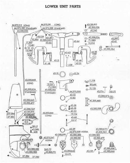

          #167147
            You might want to check the condition of the 300583 rotor impeller in front of the propeller. They tend to go bad with age.
            Johnson-HD-Lower
            #167163
            Rick Robbins
              It fit snugly inside the new impeller, the old impeller had a significant gap.
              • This reply was modified 6 years, 8 months ago by Rick Robbins.
