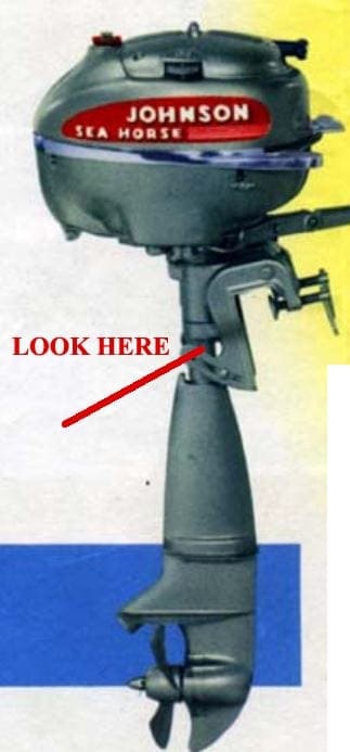

                I’m thinking the relief holes are in the round tube just below the swivel.
                HD-25
                #167040
                Rick Robbins
                  You’re right!! I just looked for them and found them where you had them shown. I’ll have to give it another try this weekend to check for water output. If that’s spitting water, I guess I’ll have to assume the higher block temps are normal. I’ll repost my results when I get to try it. It’s pretty cold here right now so it may be awhile.
