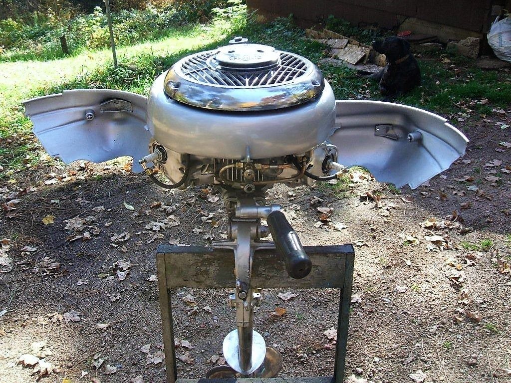

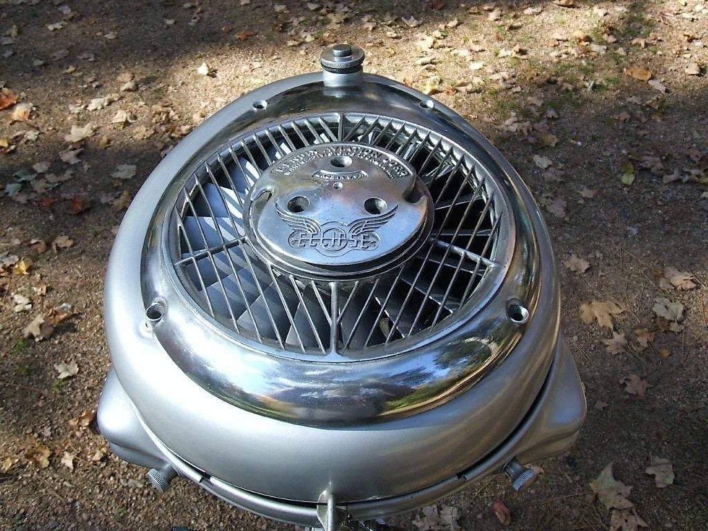

      Hello everyone. I just joined the AOMC today. I own a 1939 Bendix TMD that was beautifully cosmetically ( and reportedly mechanically) restored about 7 years ago. I have never tried to start it. I now live on a beautiful lake in the Adirondack Park in upstate NY and I would like to use this beautiful machine with a small skiff. Could someone please walk me through the process of starting this motor. I know that it is AIR cooled so can I perform a test run with it on a stand without having it in the water? What gas mix should I use ??? Please HELP 🙂 Thank you. Eric

          Sorry I can’t help, just want to say welcome to the club.
          And that is one beautiful motor!

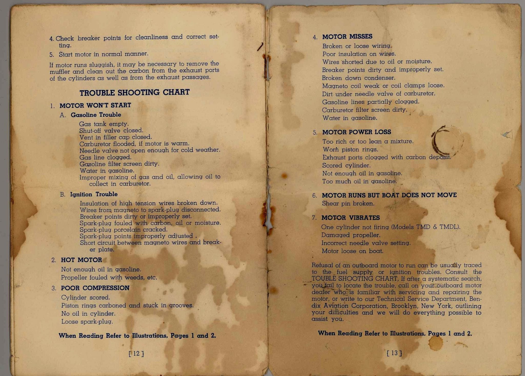

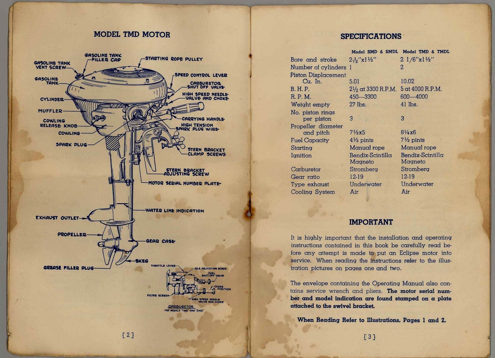

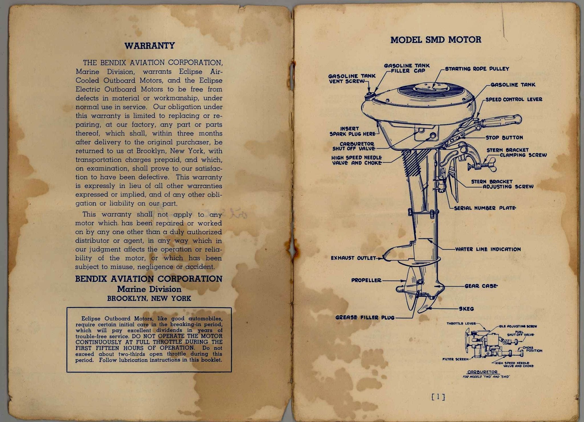

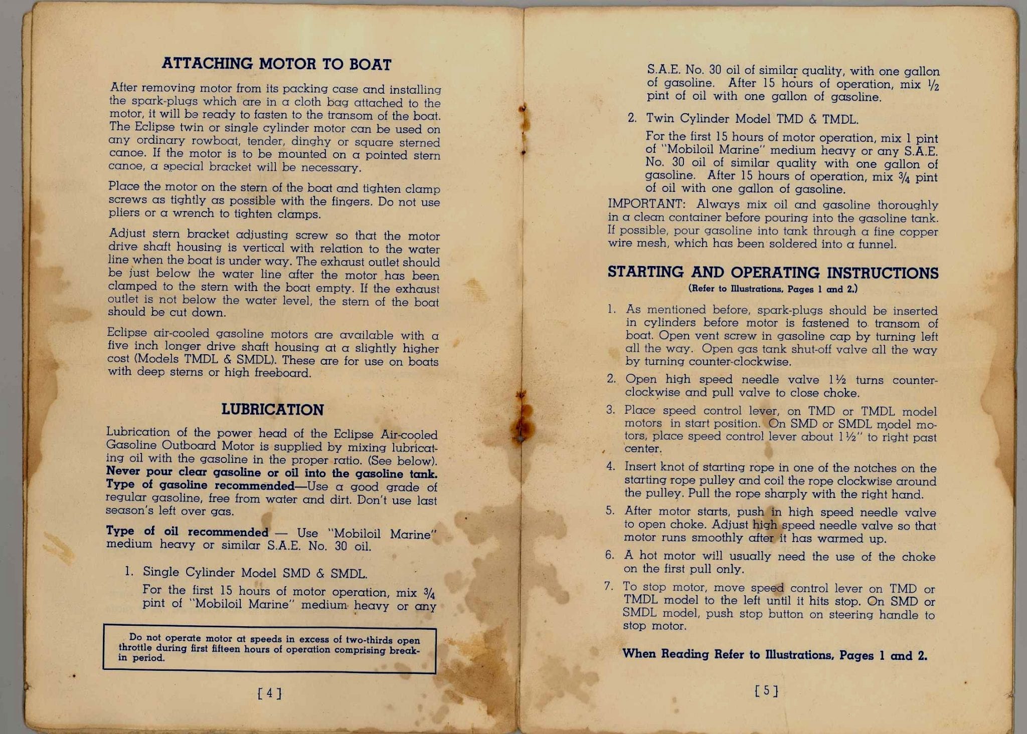

            I’m not much help. I only have experience with the single. However, you should find everything you need in the attached operators manual.

              This is all I have regarding starting……
              I love how your motor looks like a bat with
              the covers open!

                    Screw down the top cover before you try to start it! You don’t want that flopping around.
