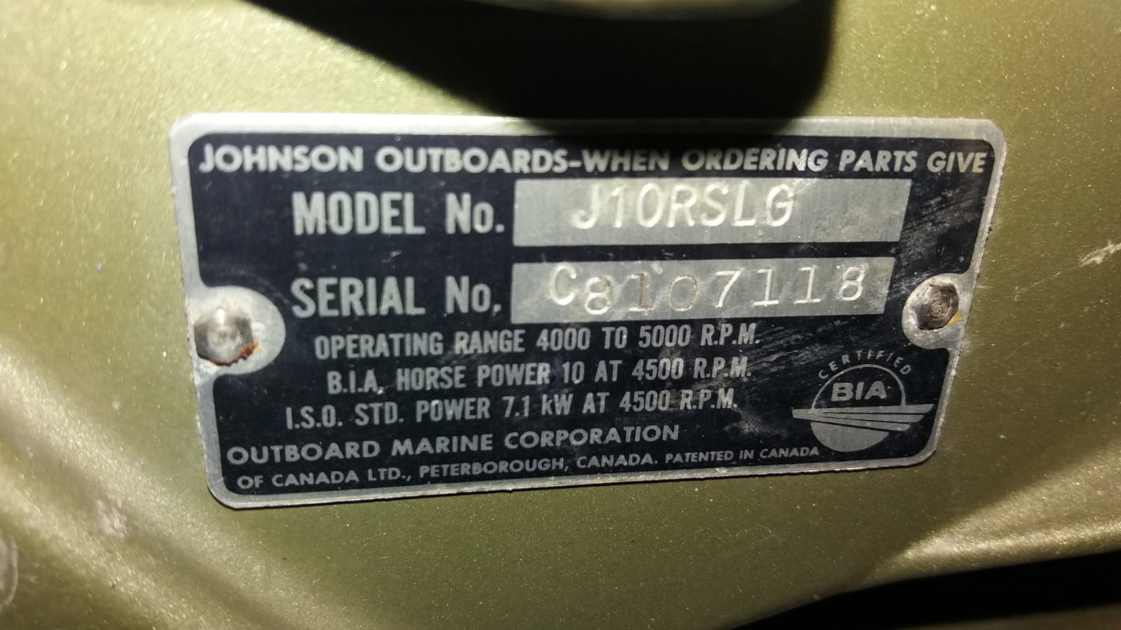

      My father has a an older motor that he got in the 80’s but still runs like a charm, now I need to buy a thermostat and the water pump but I cannot find the model year. The plate is marked with J10RSLG and I could figure this much…

              jiam
                Thank you guys for the input, you are correct he did buy it in South America – Uruguay.
                I figured the model may look different but the parts should work fine from another model.
                So what model could I use?
                Should I just pick a 9.9 from the 80’s ?
                Thank you,
                Javier
                Here is the plate:
                #83463
                rmhxruss
                  Found this info
                  389623 impeller
                  391389 water pump kit
                  Not a common part but still sold by BuRP.
                  378065 5005440 could be the thermostat very common.
