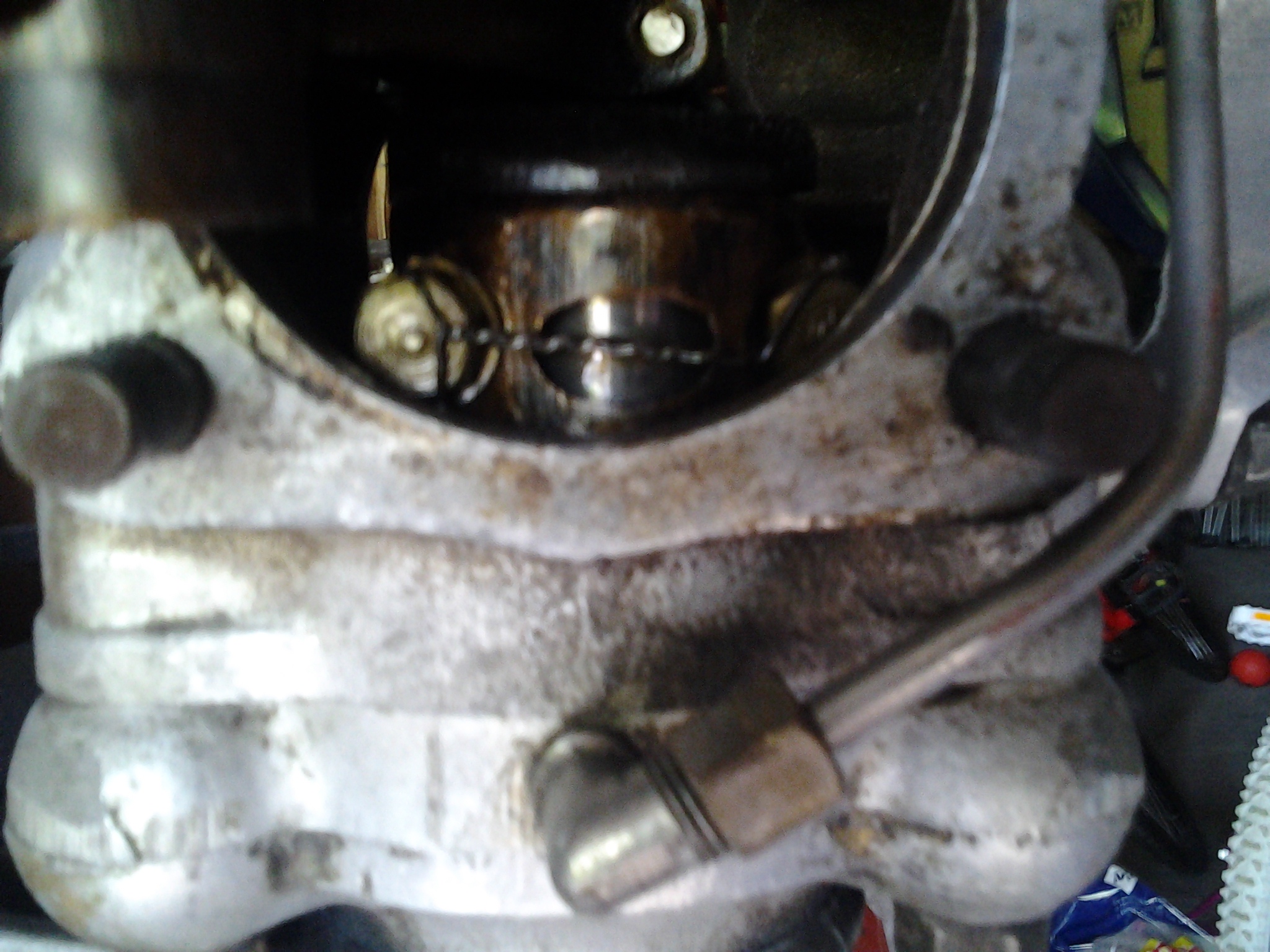

Hi . need help on Lockwood chief motor is 060 bore is that standard on racing motor stock from Factory 82b on rope pulley .I just purchase two of these motors i believe one is a 1930 b motor and the other 1928 is a 82b motor pistons on 28 say 060
July 5, 2017 at 2:18 am #61004Standard bore on the Chief is 2.375" (two and three-eights inch). Year of manufacture and whether its a racing model or fishing motor doesn’t matter, they used the same size bore. Racing model reportedly built with two-ring pistons and aluminum rods as standard equipment. (usually changed over to bronze). Personally I’ve never seen a two-ring piston in a Racing Chief, but have been told they exist.
Your bores should measure at least 2.435" if the slugs are indeed 6o thou oversize.
Hope this helps.
Best,
July 5, 2017 at 12:38 pm #61021Thanks its stamped on piston an jugs has the bronze rods too trying to post a picture of pistons and jugs but I just can’t figure out how to post a picture yet will post soon. An piston has 2 rings
July 5, 2017 at 1:19 pm #61024OK’ if the number 094 is cast in the upper surface of the timing flange it is a 2-ring +.060 O’size Judson piston. If they have either no number inside or a 6 digit number starting with 100*** they are factory replacement +.060 for 92BR or 1930 Sea King made by Lockwood. e-mail <sogentiiiky@gmail.com> or ph- 1-731-584-2195 in Tenn. .060 is the largest oversize bore that was allowed to go or it went into next class. Jim Ross
July 5, 2017 at 3:04 pm #61028Are these the Lockwood’s you bought?
viewtopic.php?f=6&t=12549
July 5, 2017 at 3:47 pm #61032Yes those are the one’s the one on the left is the one that its bore is 060
July 5, 2017 at 3:58 pm #61033The pistons have 094 stamp stamped in them to . What do you mean by the number stamped into the timing flange where would that number be located it isn’t the serial number or the model number right
