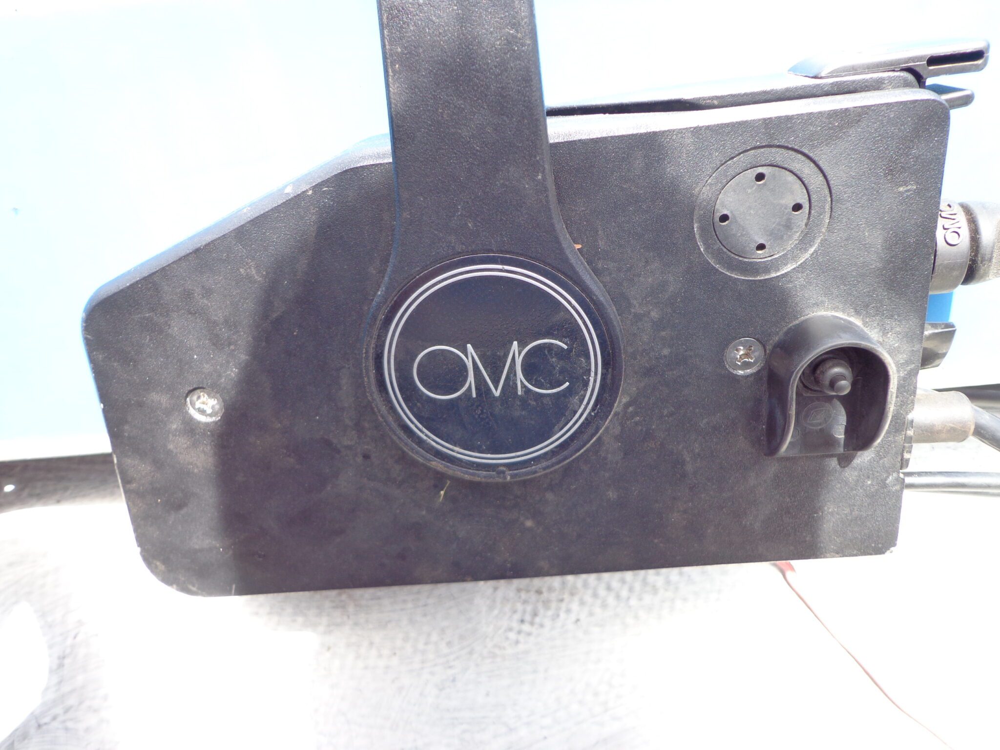

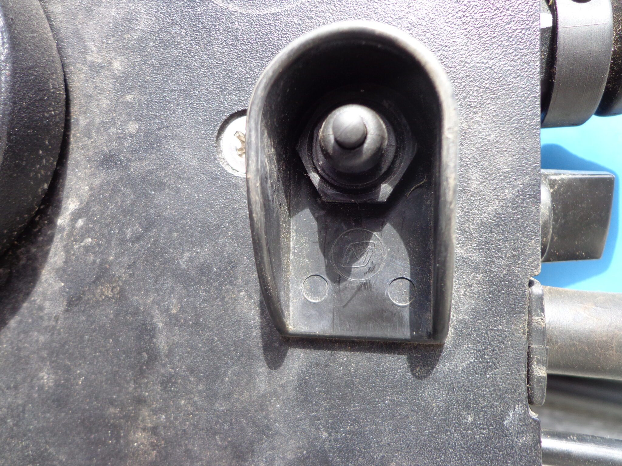

      A friend just picked up a boat but I can’t keep the motor running unless one of us holds the emergency kill switch in as the lanyard with the clip for it never came with the boat. None of my horseshoe shaped clips work on this switch and it seems it needs a clip which fits over the outside of the switch to hold it in. M.E. and Google were no help so any ideas? If I can get the part number I’ll see if my old OMC  dealer has one. Thanks!

        Anyone?  Well, it doesn’t really matter anymore as I posted the same question on several Facebook groups and within minutes I had several correct replies.
        Sierra      MP 28880
        OMC       432230, 393079, 392288.

          Also Sea Dog 420496-1

              Well all the above were faster than I was.
              0432230
