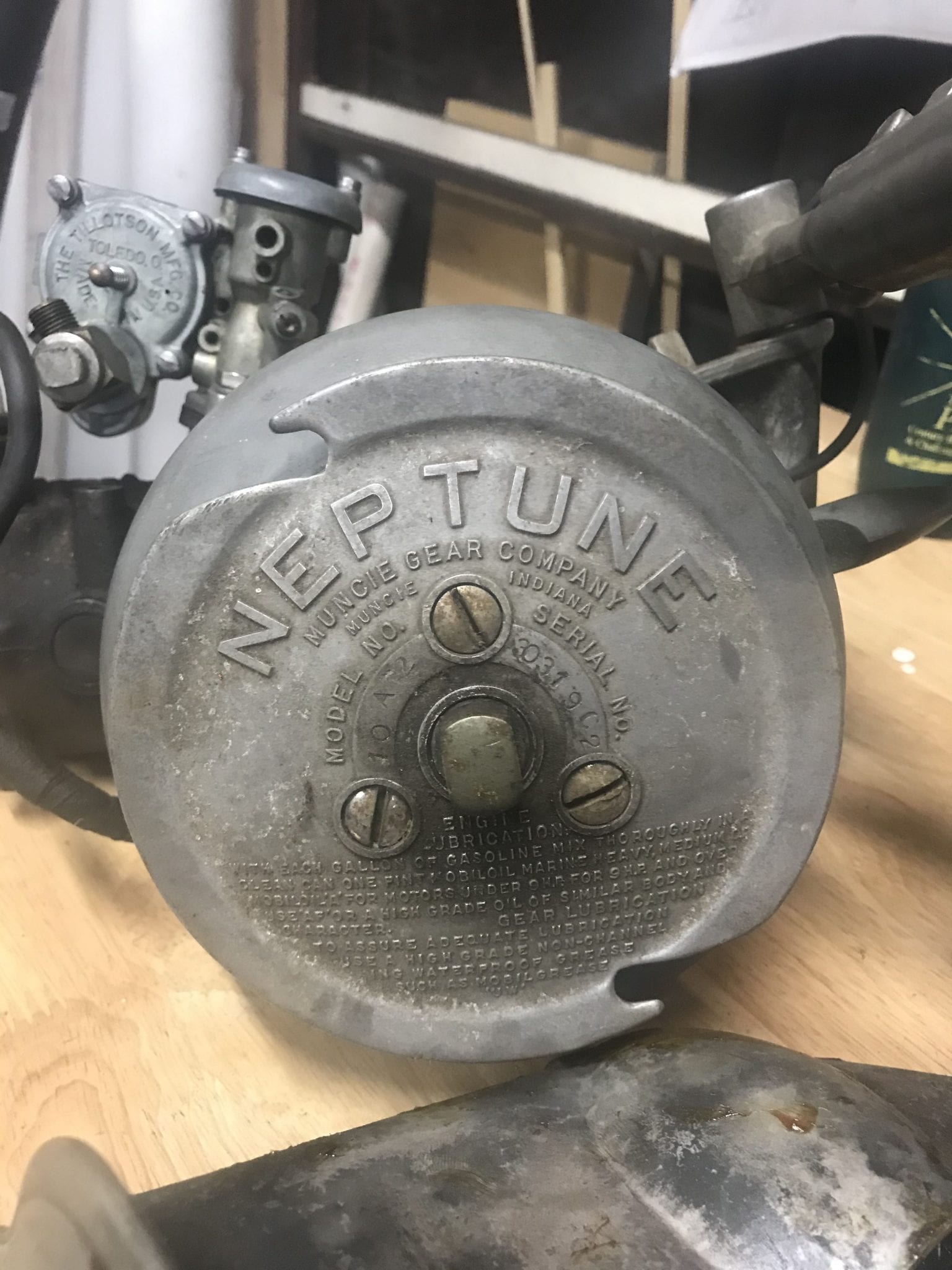

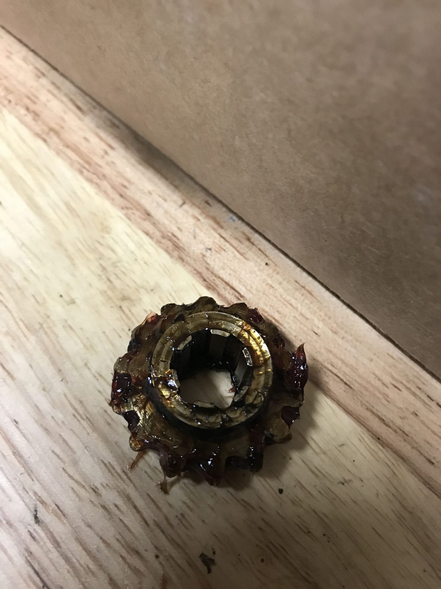

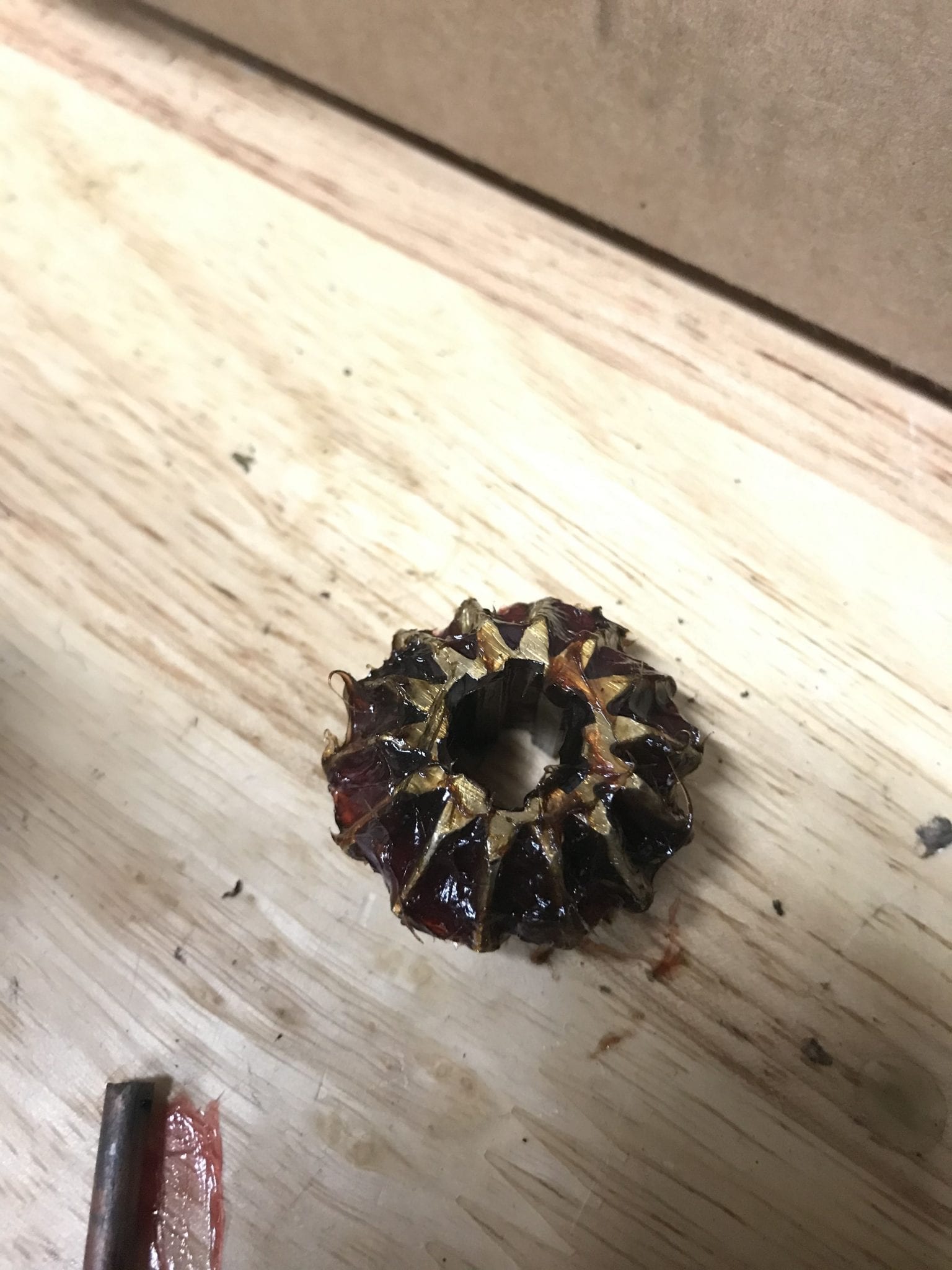

      I inherited a Neptune 10A2 from my grandfather after he passed and I’m finally making the time to see if I can get it running again. So far I’ve cleaned the carb, confirmed that it has spark, cleaned the gas tank, and serviced the lower unit. However, after inspecting the bronze driveshaft gears in the lower unit, I discovered that the gear on the driveshaft has worn such that it no longer makes good contact with the gear on the propeller. I think that there was dirty grease in there, causing the bronze gear to lose height as it lost material off the bottom from friction. Now it’s so short that it doesn’t properly engage the other gear to drive the prop.
      Anyway, I’d hate to give up at this point so I’m putting this message out here to see if anyone knows where I can find a replacement gear or how I might be able to repair this. Perhaps a spacer under the gear to make it sit higher and make good contact with the horizontal gear. Hope that makes sense to those more experienced than I. I’m attaching a photo of the gear and model plate. The second photo shows the wear on the under side of the gear.
      Thanks for any help – Elliot from Maine
      Top of gear
      Bottom of gear showing wear
      Model info

                    JOSEPH BRINCAT
                      Elliot, that gear does not look too bad to me, at least the teeth look serviceable. Assuming that you intend no tran- Atlantic voyage with the motor , I think that you will be OK by just adding a shim thrust washer, just thick enough to bring the gear mesh back to a respectable position. The gear is bronze. What was the bearing material that it road against? I would guess also bronze, not a real good design. Make the thrust washer of steel, preferably hardened steel.
                      Clean the gear of grease and send us another photo, just to verify
                      Joe B
