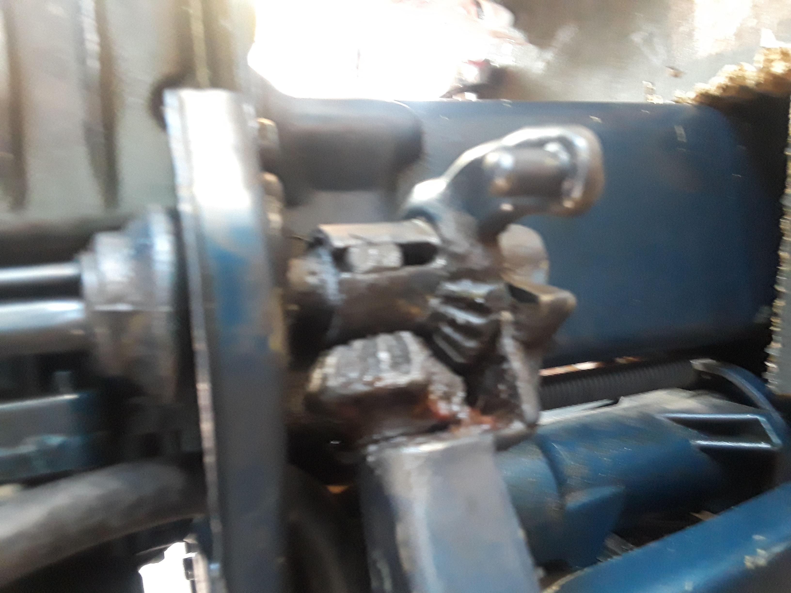

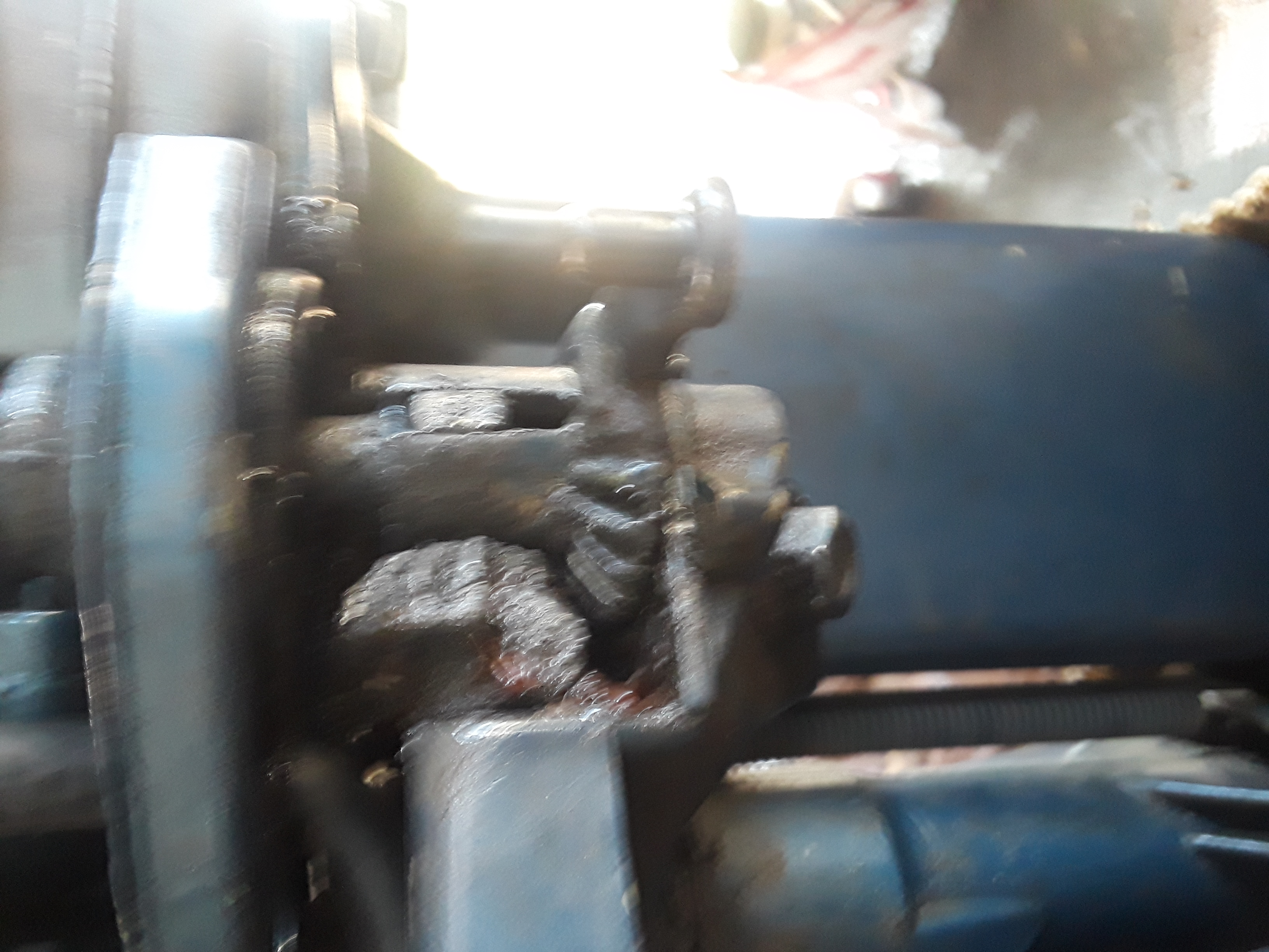

                    mrhtx21
                      quote fleetwin:
                      quote mrhtx21:
                      So after evaluating the situation I am pretty certain that that shift lever on the outside of the exhaust cover was not put back on correctly and so I don’t have the full range of throttle that I did before cause any kind of run rough cuz it’s half throttle
                      So can anyone tell me the correct procedure of putting that lever back on
                      OK, I am assuming you pulled out the vertical throttle rod/linkage, correct? Probably to access the exhaust cover. If so, I don’t know how that could have gotten messed up during reassembly, it only fits in one way. There is a plastic pin that fits into the gear on the bottom of the vertical throttle lever, did that get broken/snapped? The gears could not have gotten misaligned unless you pulled out the horizontal throttle rod, but you would have had to remove the set screw on the end of the gear to do that….
                      Maybe if you post some pictures we can see what is going on..
                      Finally, that engine absolutely requires a 16:1 fuel/oil mix, regardless of all the hype about today’s oils being superior to what was available back in the day. Continuing to run the engine at 24:1 will probably end up with a rod through the crankcase.

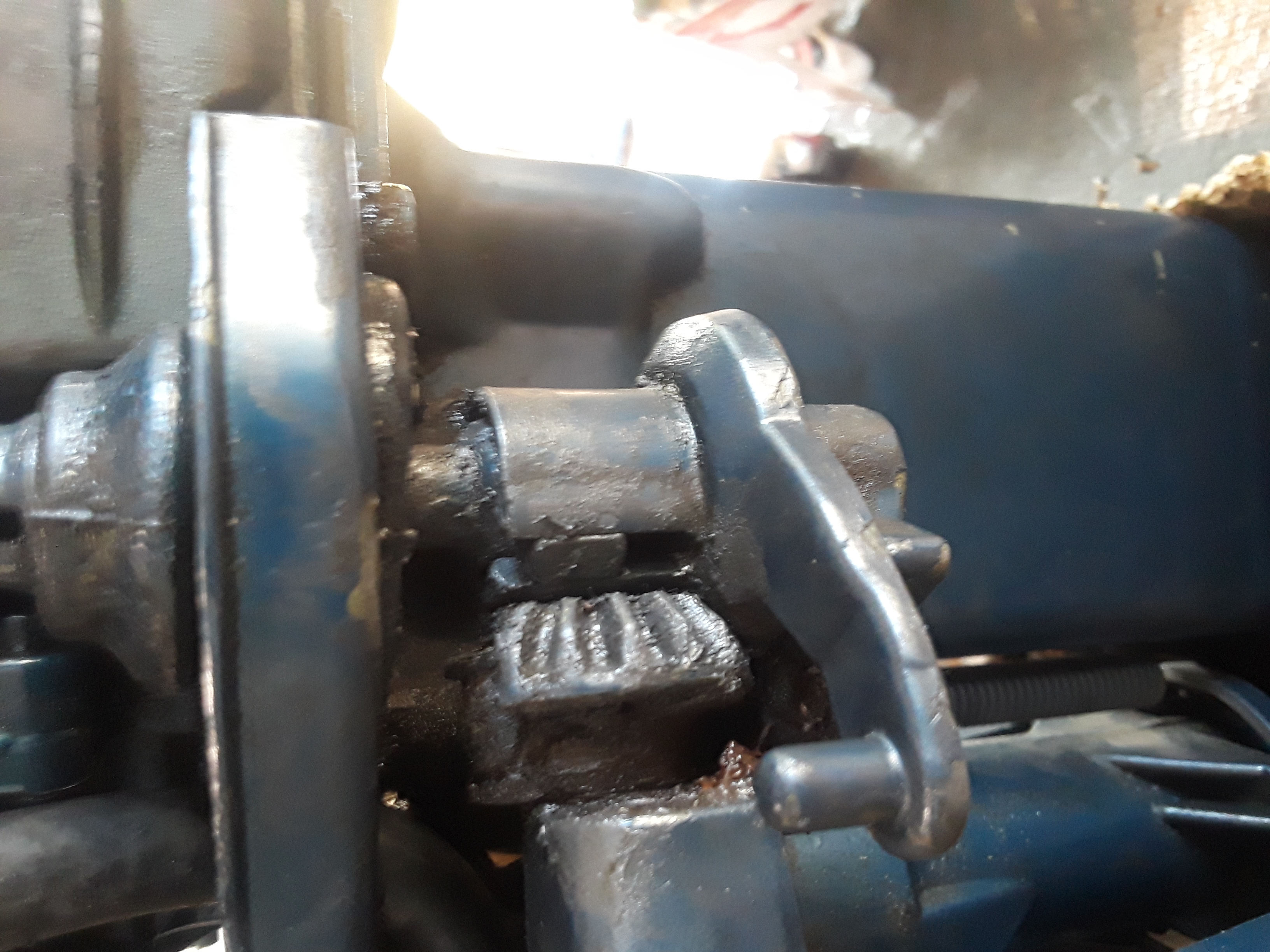

                      So as you can see the gear on the tiller part only runs part of the way around it’s almost like the smooth part needs to face inside because as the teeth roll against each other it finally hits the smooth part which in turn won’t move the arm any further on the throttle and that small black rubber piece ends up quite shy of full throttle
                      #79198
                      jpatti75
                        Oh yes, those gears are way out of alignment. The first tooth at one end of the pinion gear connected to the tiller should align with the first groove on the throttle gear. I’d butcher the explanation on how to adjust it, but you need to remove the throttle shaft/rod that connects to the magneto advance arm, and then you can remove both the tiller pinion gear and the throttle gear, and reinstall properly aligned.
