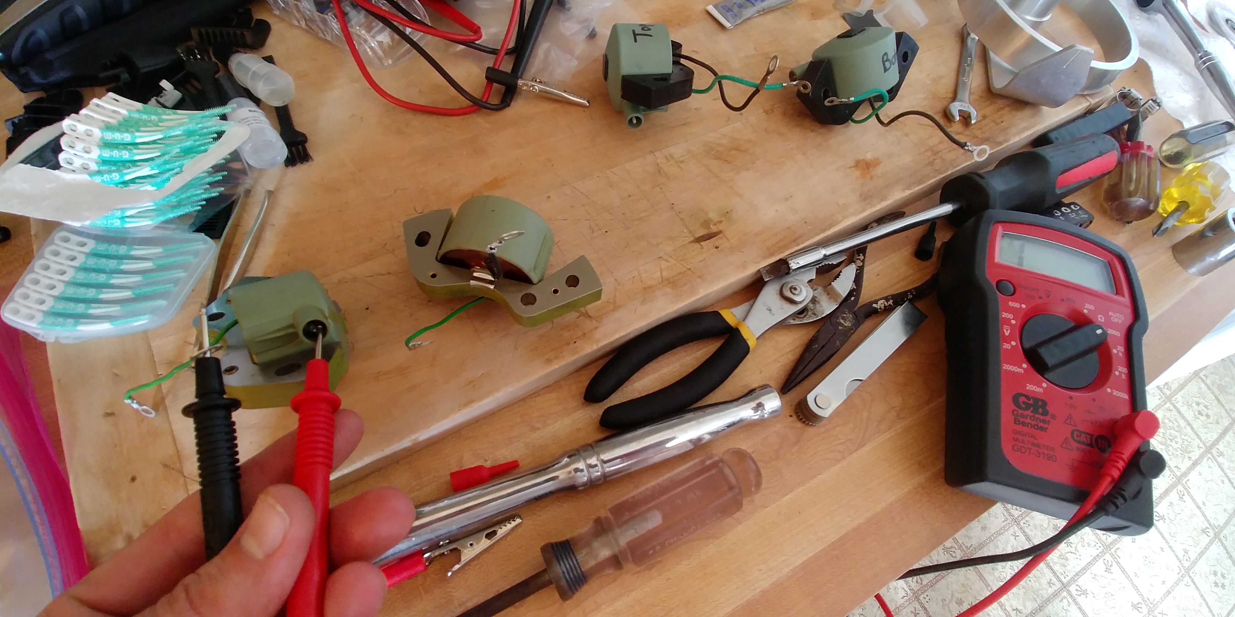

    t-bell

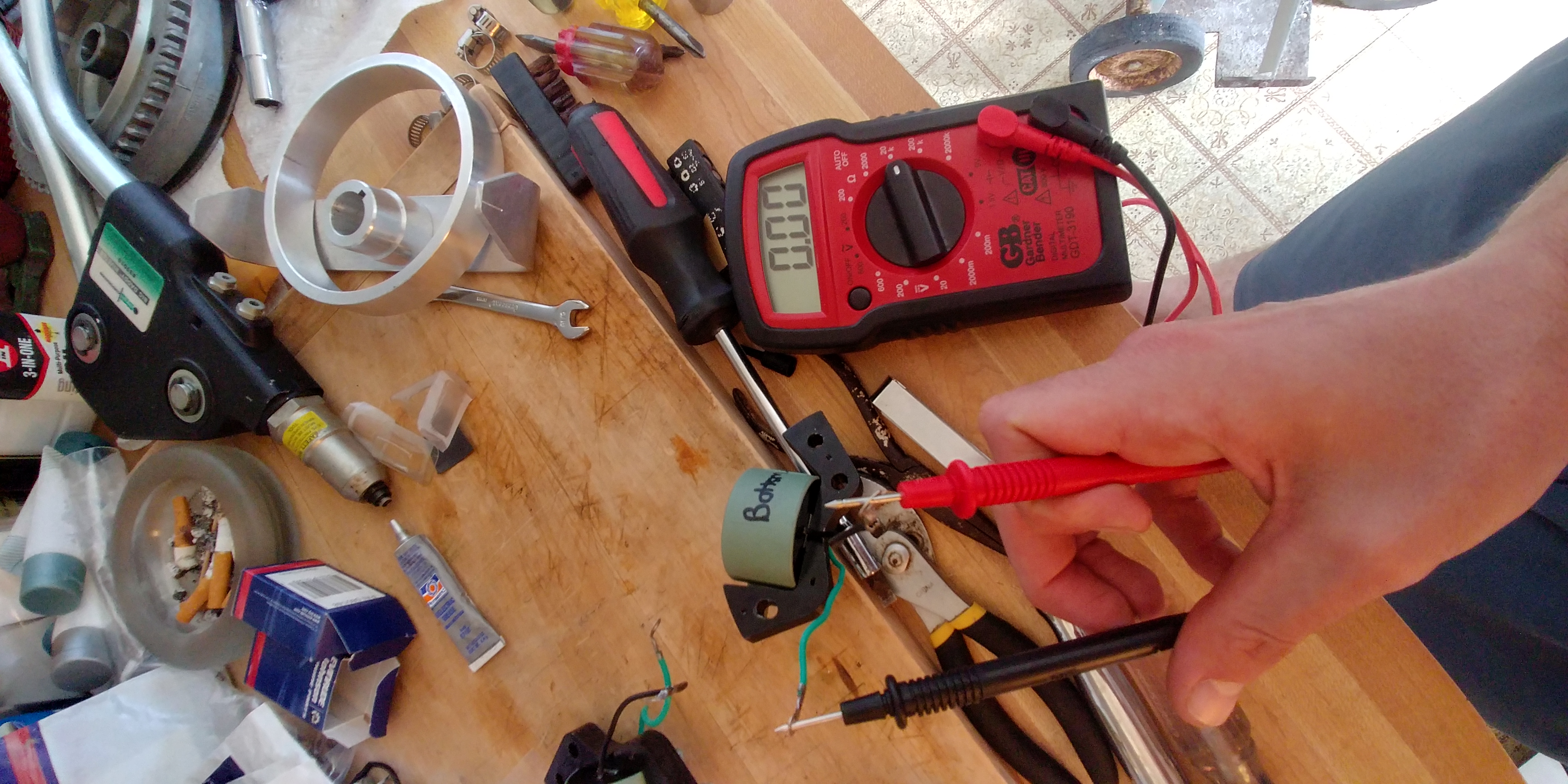

      Just to make sure we’re on the same page and I’m doing this right lol
      #71842

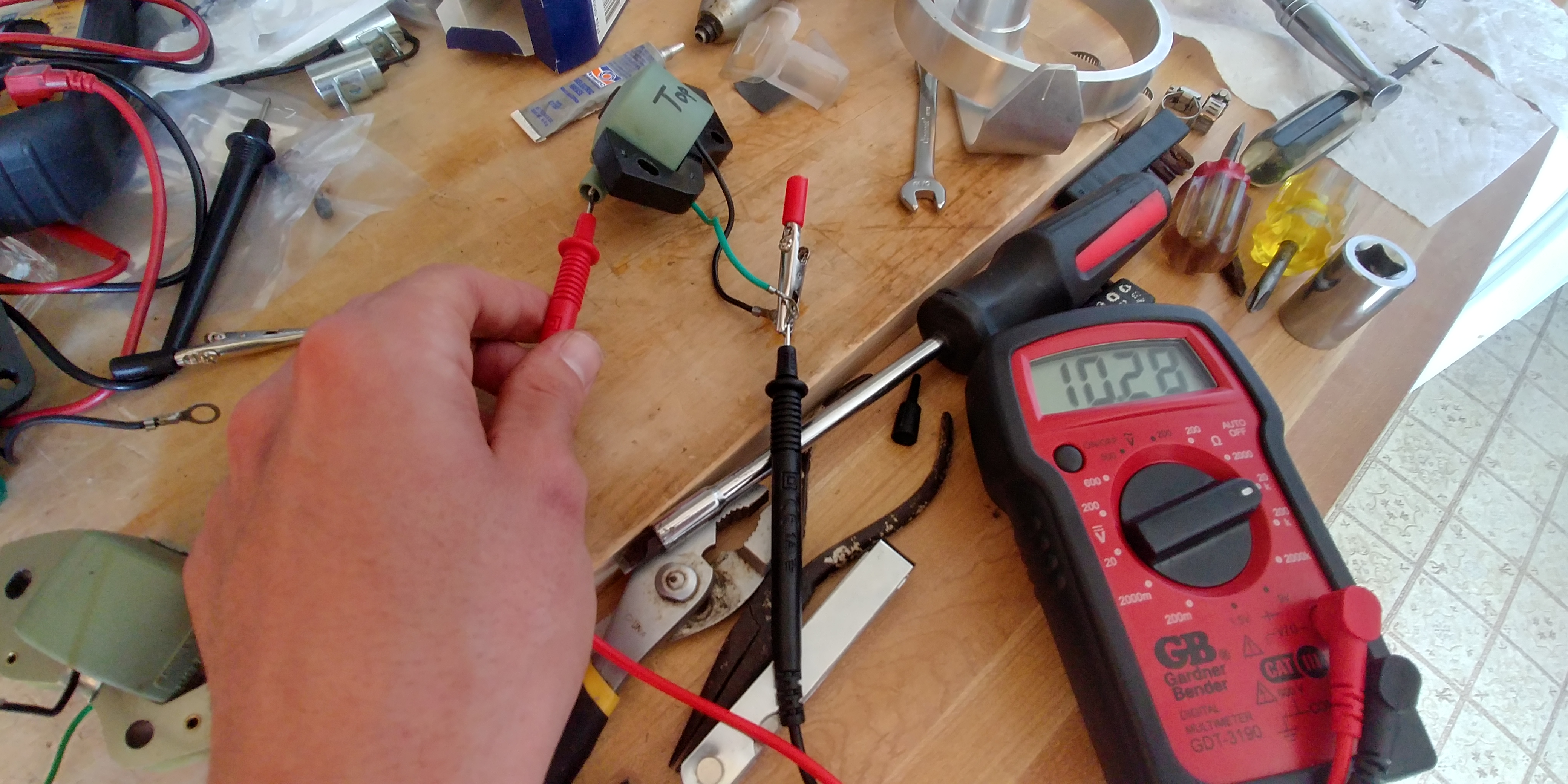

      t-bell
        @crosbyman
        I don’t think I can do the tests you described without doing some reassembly here as I’ve torn it apart to test individual parts like I saw in the video (which I’ve already screwed up) so tell me? should I reassemble? or is my method sound but my testing was flawed haha?

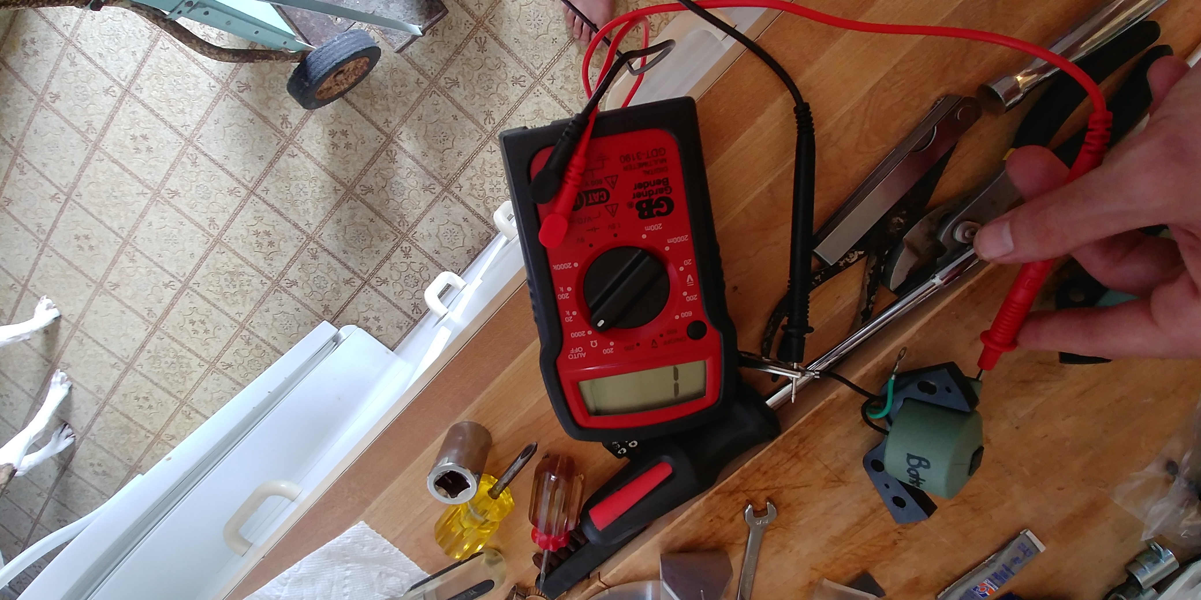

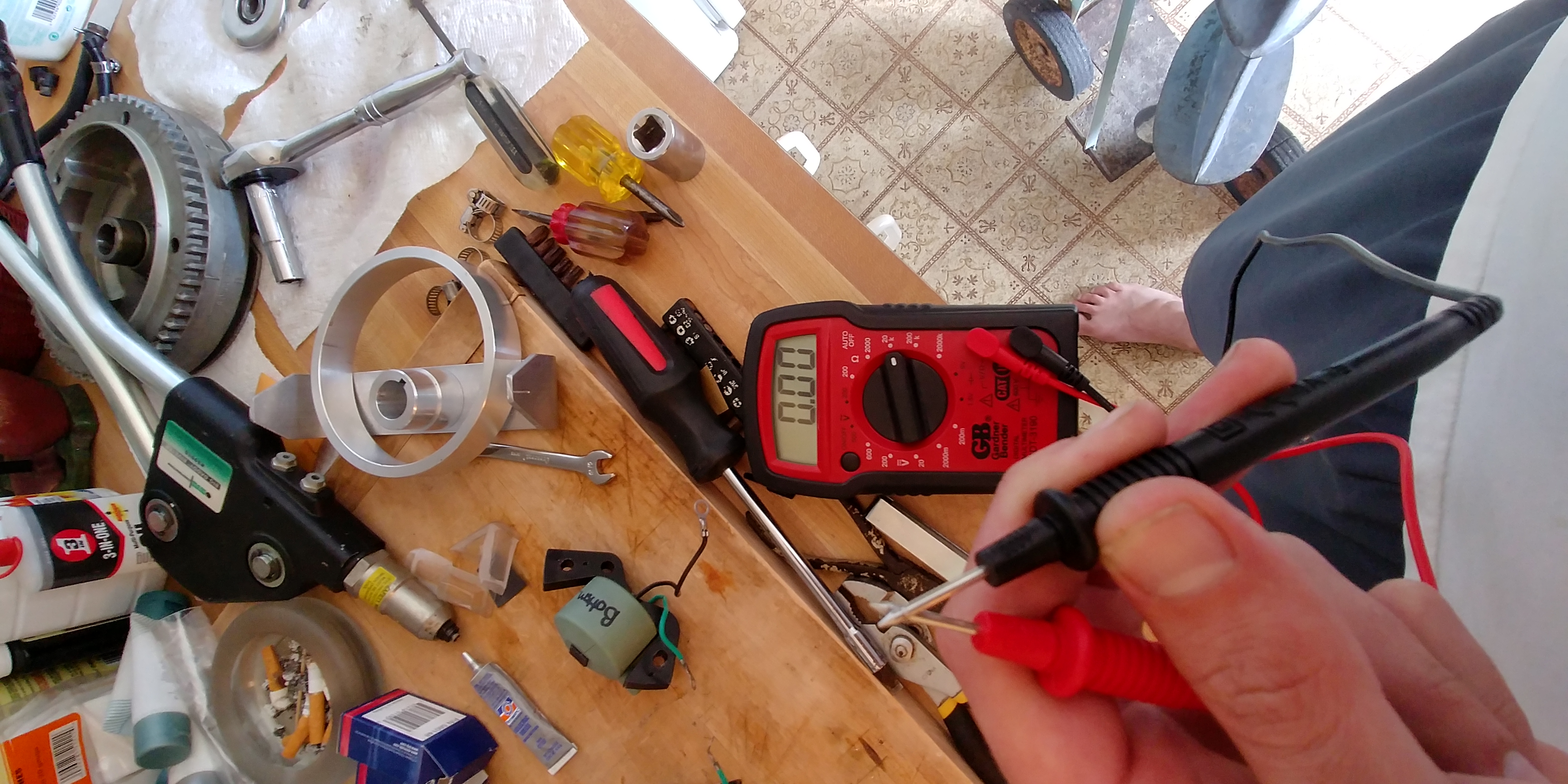

        #71843
        t-bell
          Secondary coil tests still show nothing though on all 4 coils ๐Ÿ˜•

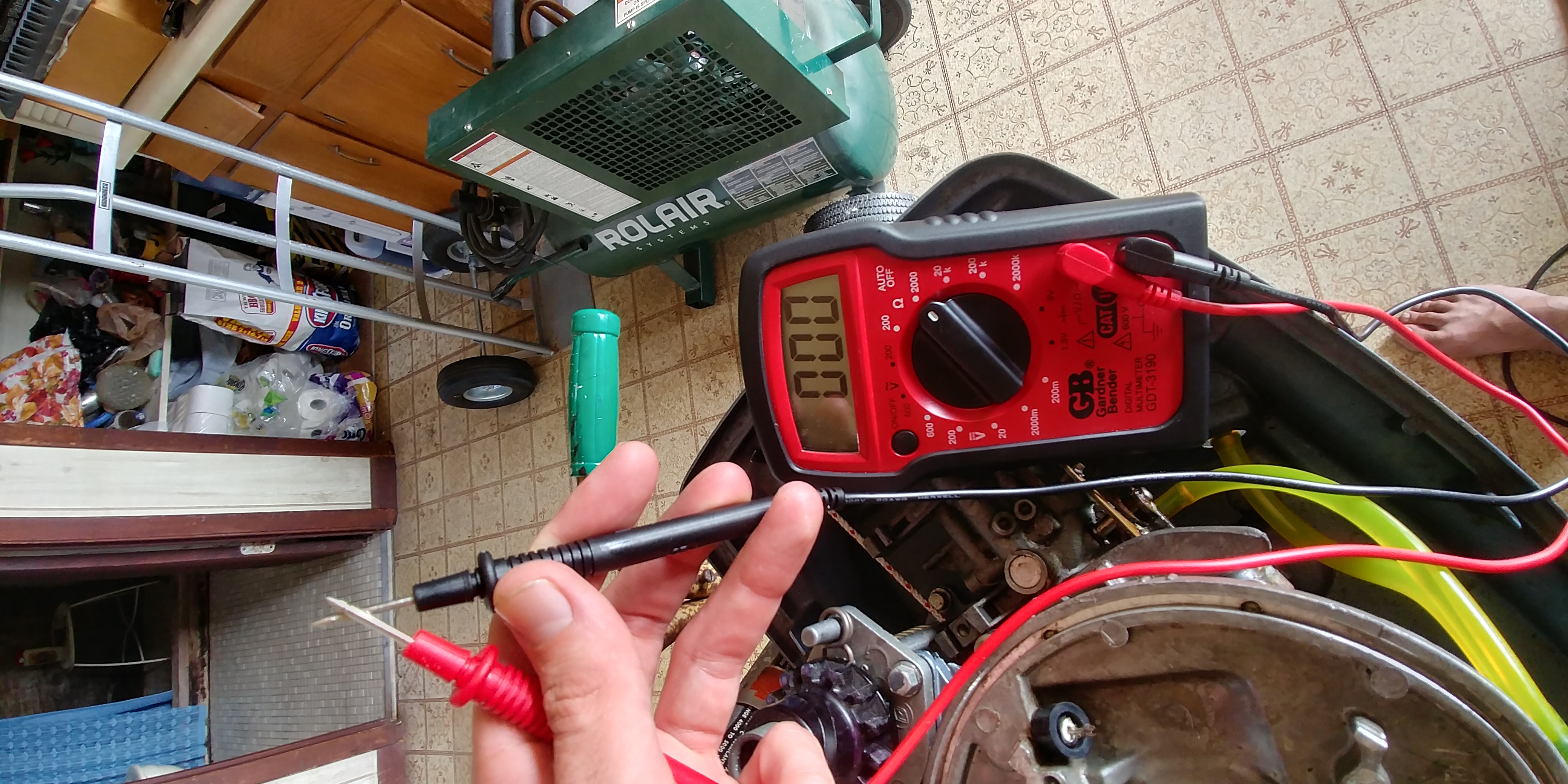

          #71844
          t-bell
            I’m at a loss honestly lol
            #71845
            t-bell
              So am I f****** retarded or still doing something wrong or just this damn unlucky ๐Ÿ™ ๐Ÿ˜†

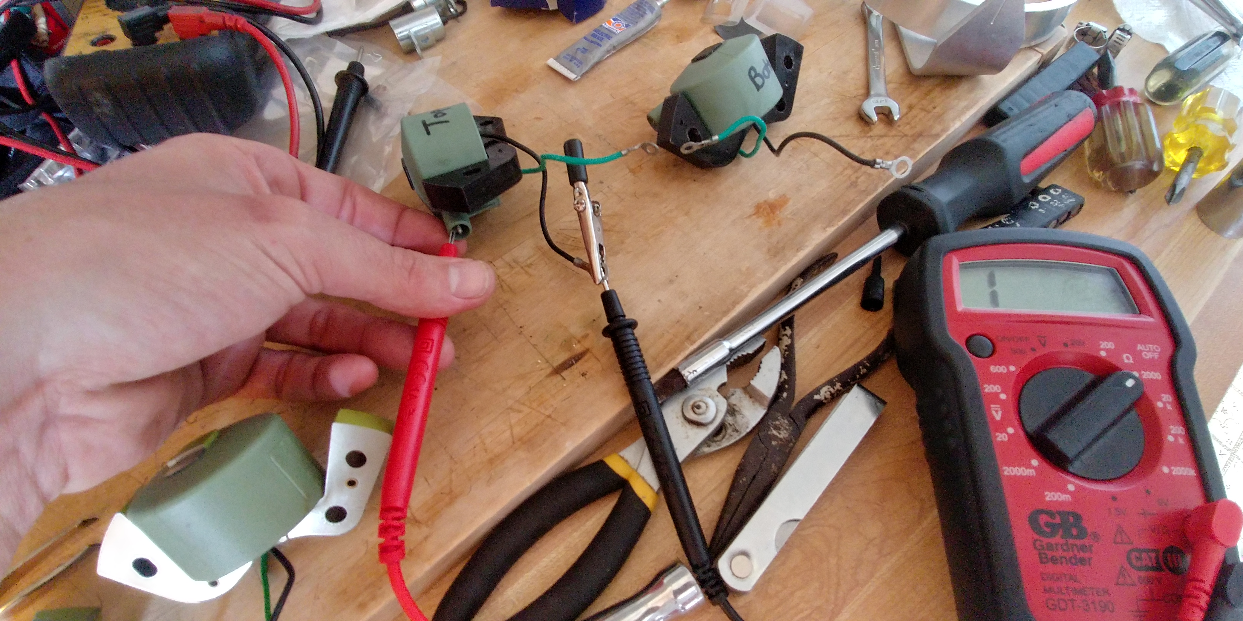

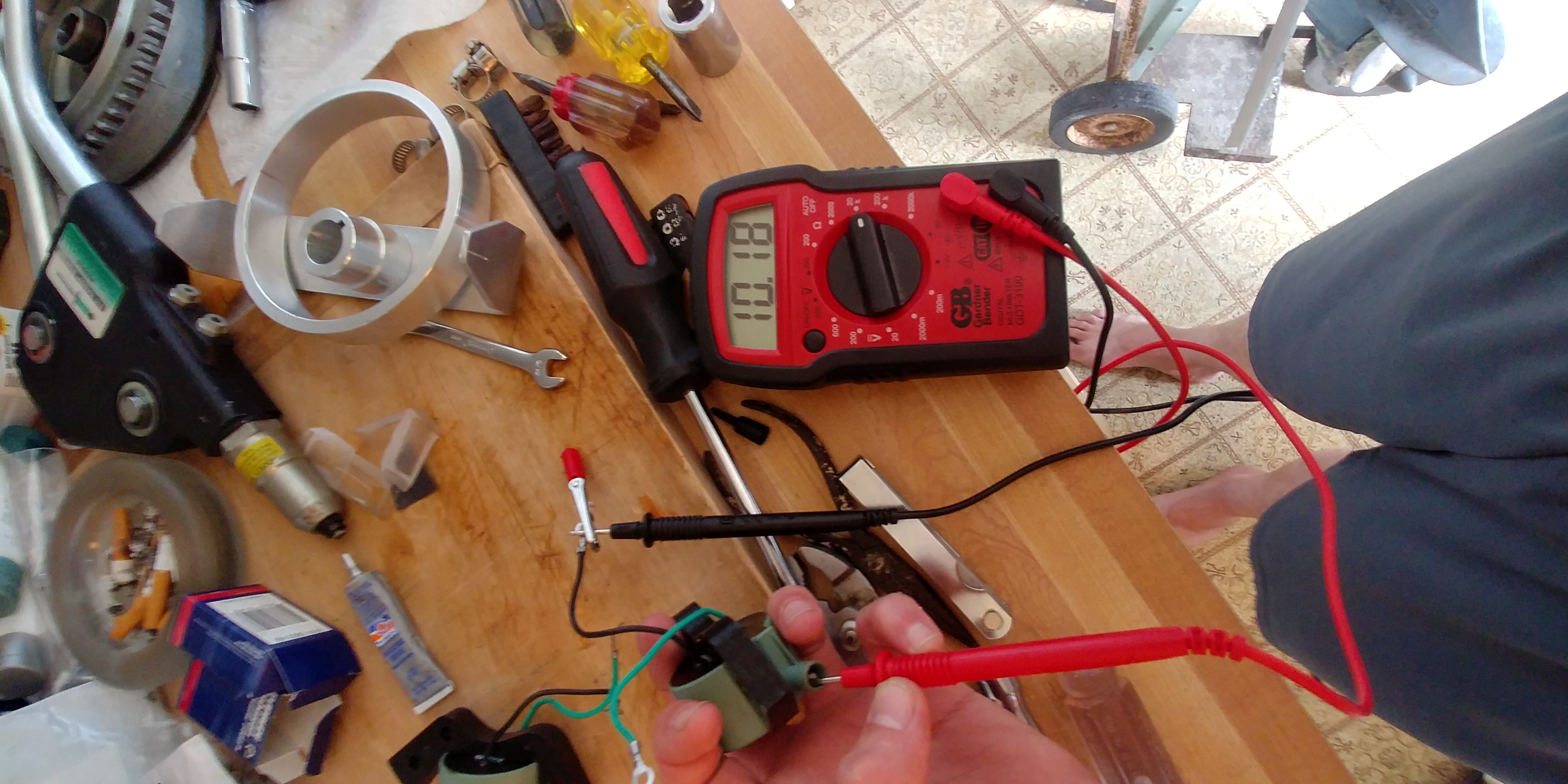

              #71846

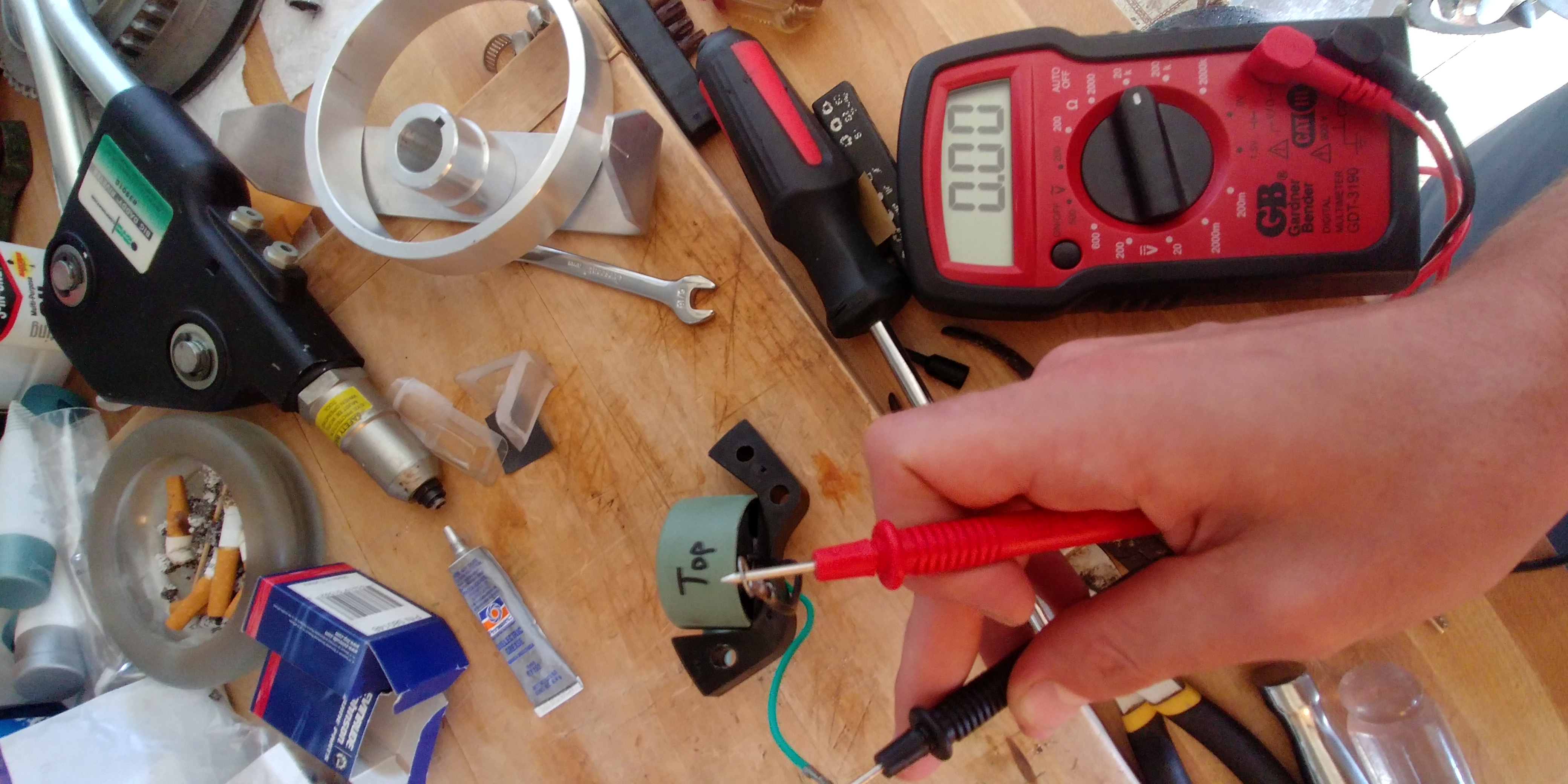

                black to green is ok (bottom coil)
                but black to HV pin on bottom coil reads open (no conductivity) so the winding is internally is broken (not good… make certain contact to pin is ok scrape the pin a bit to go to bare metal) )
                Top coil also looks open winding on the high voltage side …
                are these new coils… ๐Ÿ˜ฎ

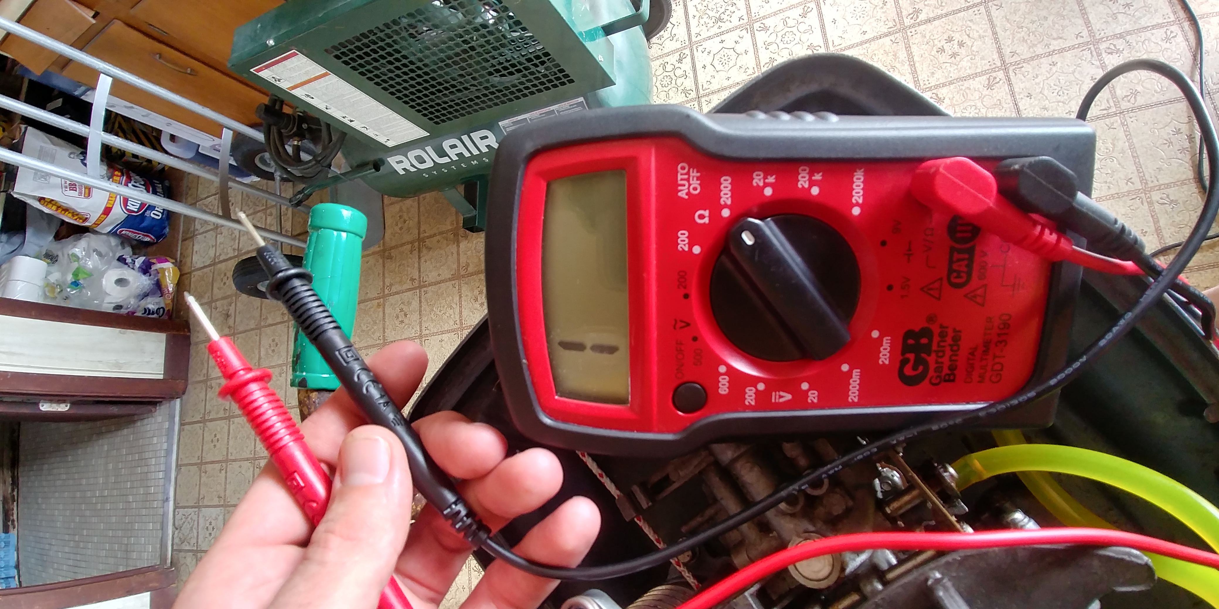

                you should read 4-7 Kohms … ALWAYS use a scale above the expected max ohms reading you are using 2000 ohms to read 4-7 Kohms
                p.s. just flip to 20 Kohms scale re-measure everything post results having seen that 2000 scale I suspect your coils are fine…
                Joining AOMCI has priviledges ๐Ÿ™‚
                #71848
                t-bell
                  Ohhhh ahhhhhh damn lol (another facepalm moment) since cajuncookone was using ร—1 or 1000 ohms I figured I was in the next closest range and should get similar readings AND HE ALSO STATES THAT IS THE RANGE TO USE!?!? But what you’re saying would DEFINITELY make more sense I will try everything again using 20k scale and post the results! And YES the BLACK HEELED COILS with TOP AND BOTTOM WRITTEN ARE BRAND NEW Sierra coils, the shiny heeled coils with no writing are the old coils by prufrex out of Germany.

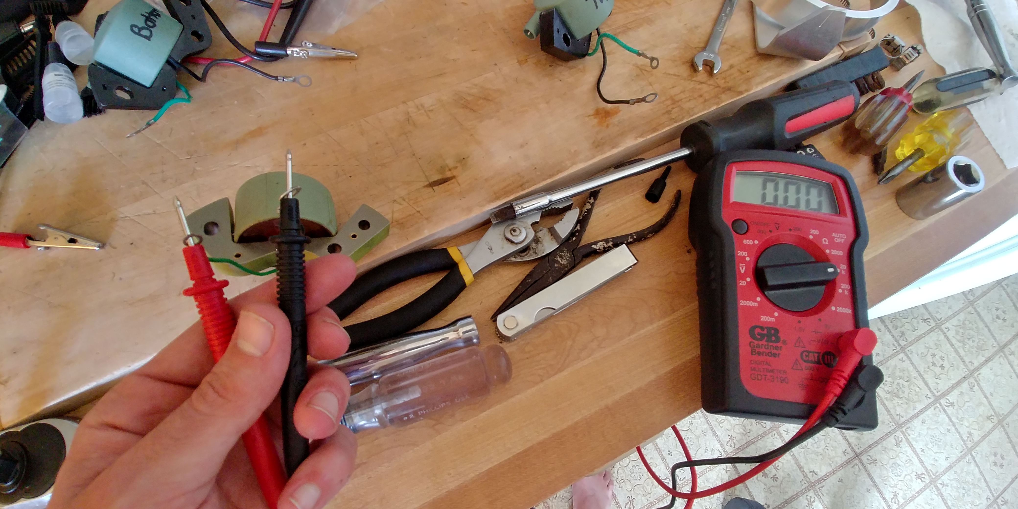

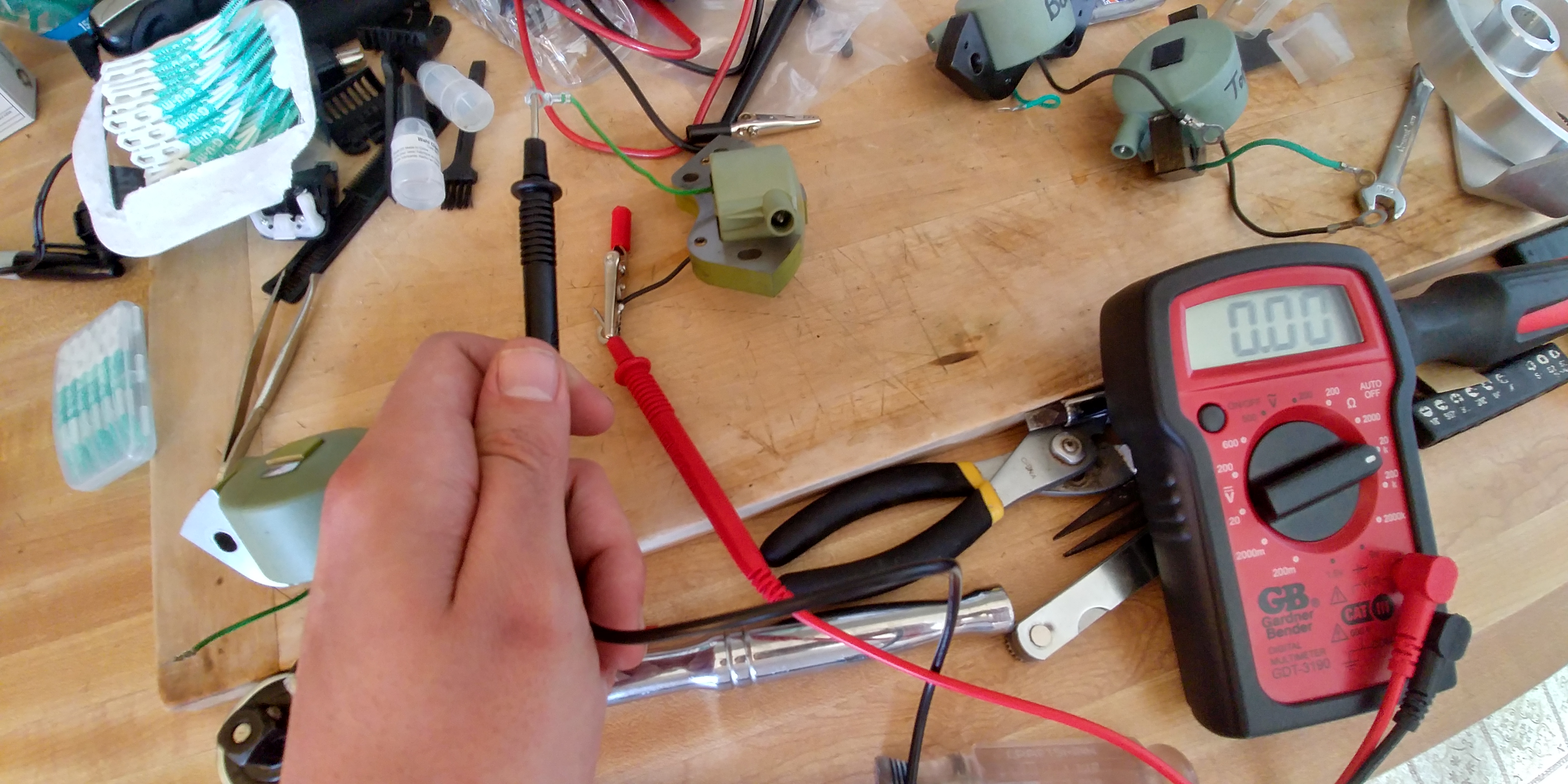

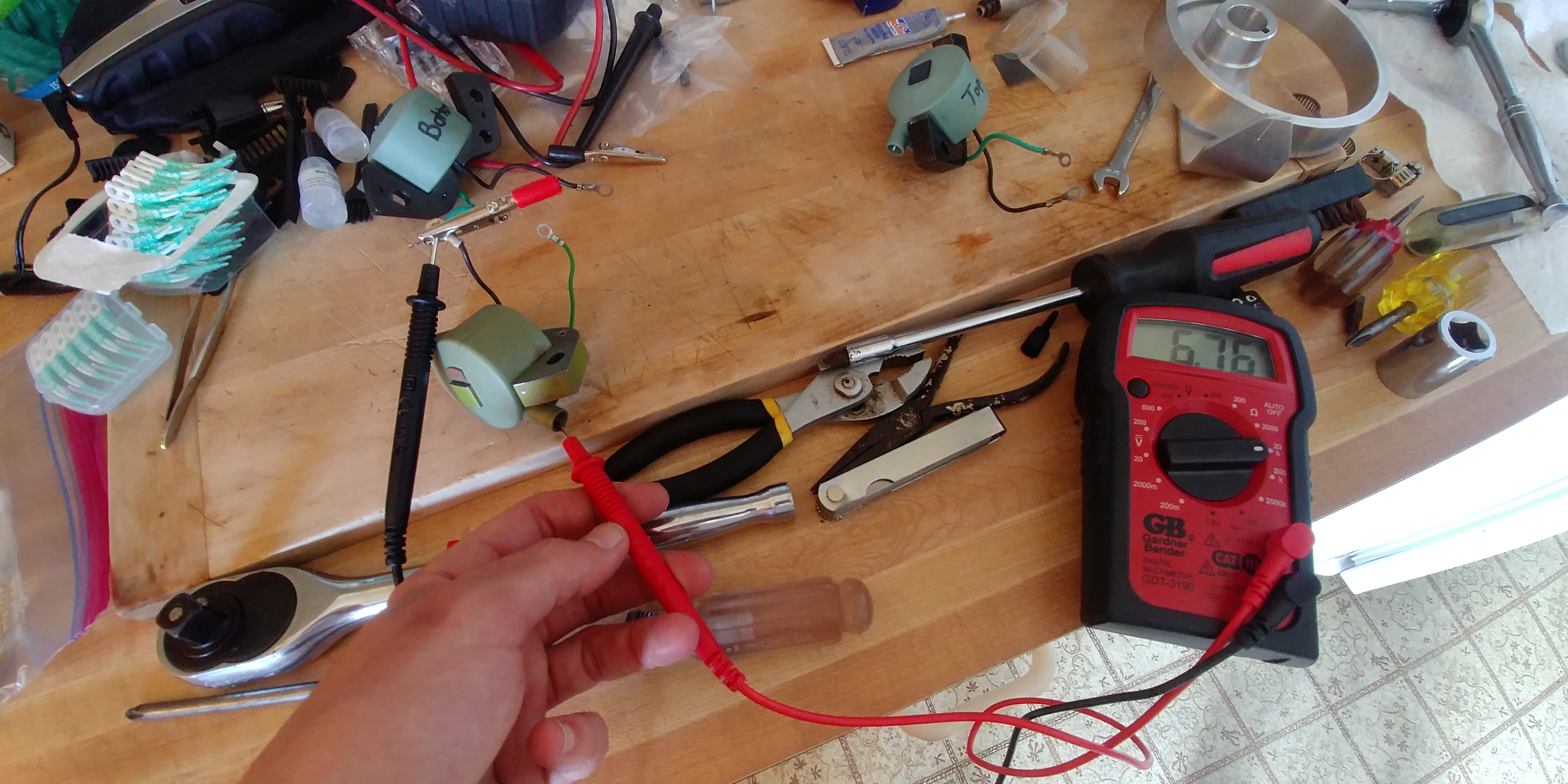

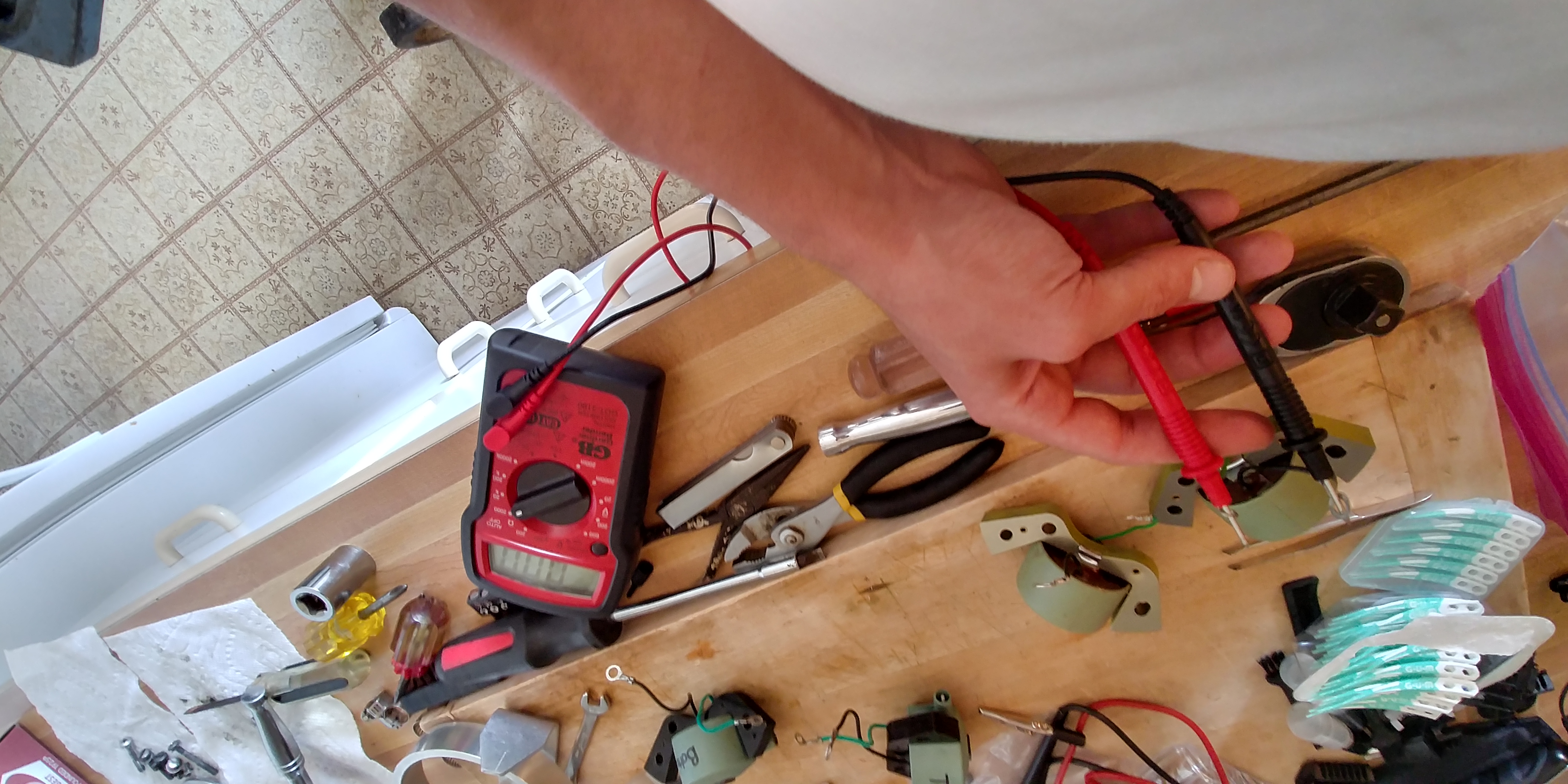

                  #71849
                  t-bell
                    20k ohm scale results ๐Ÿ˜ณ

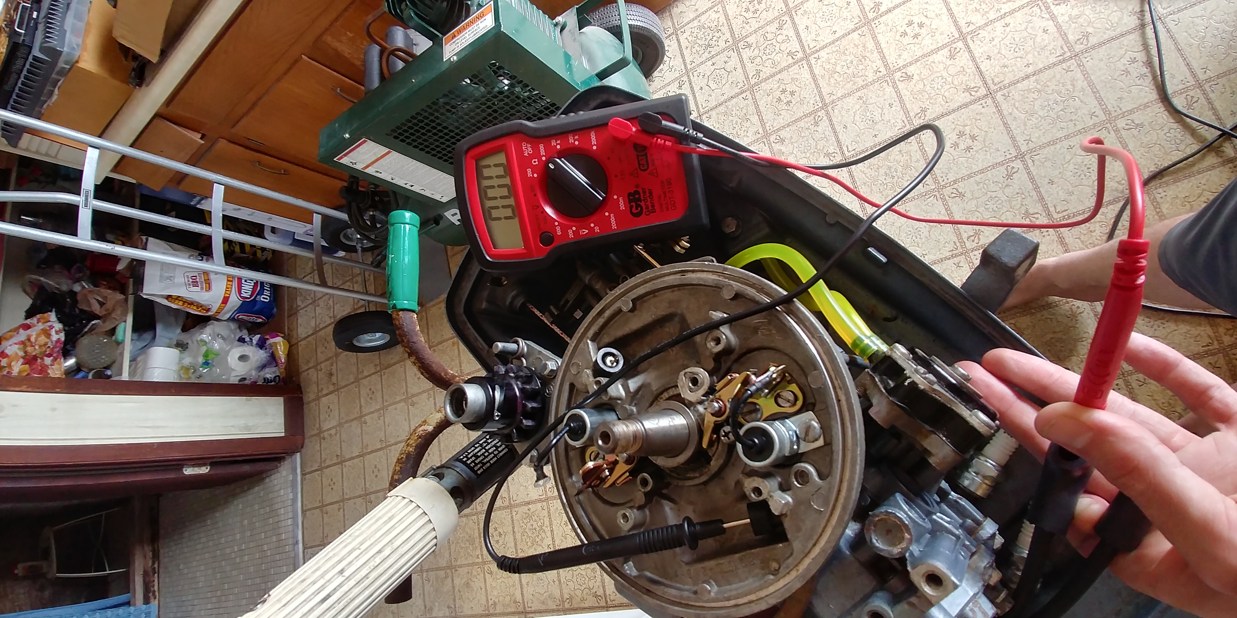

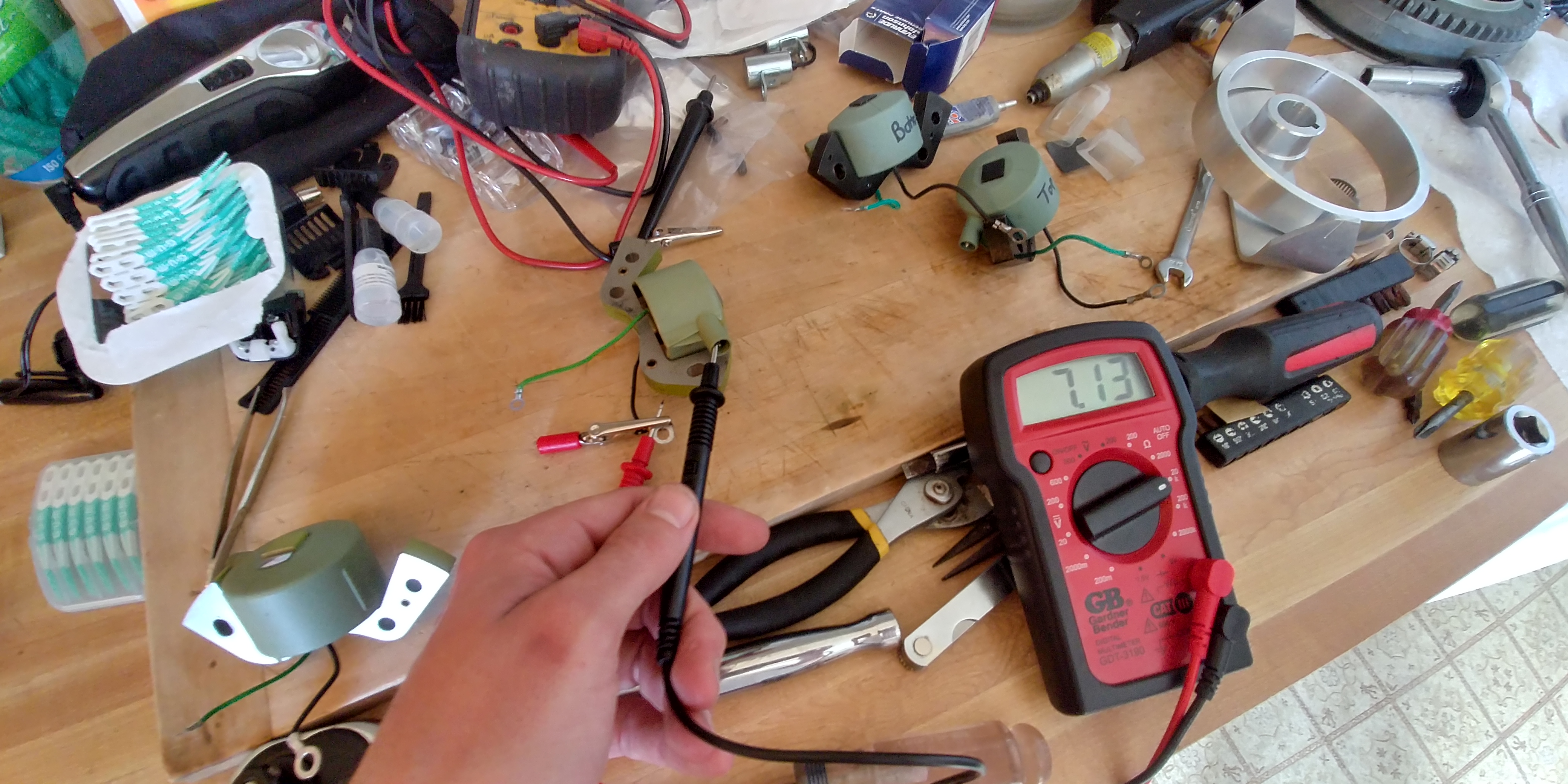

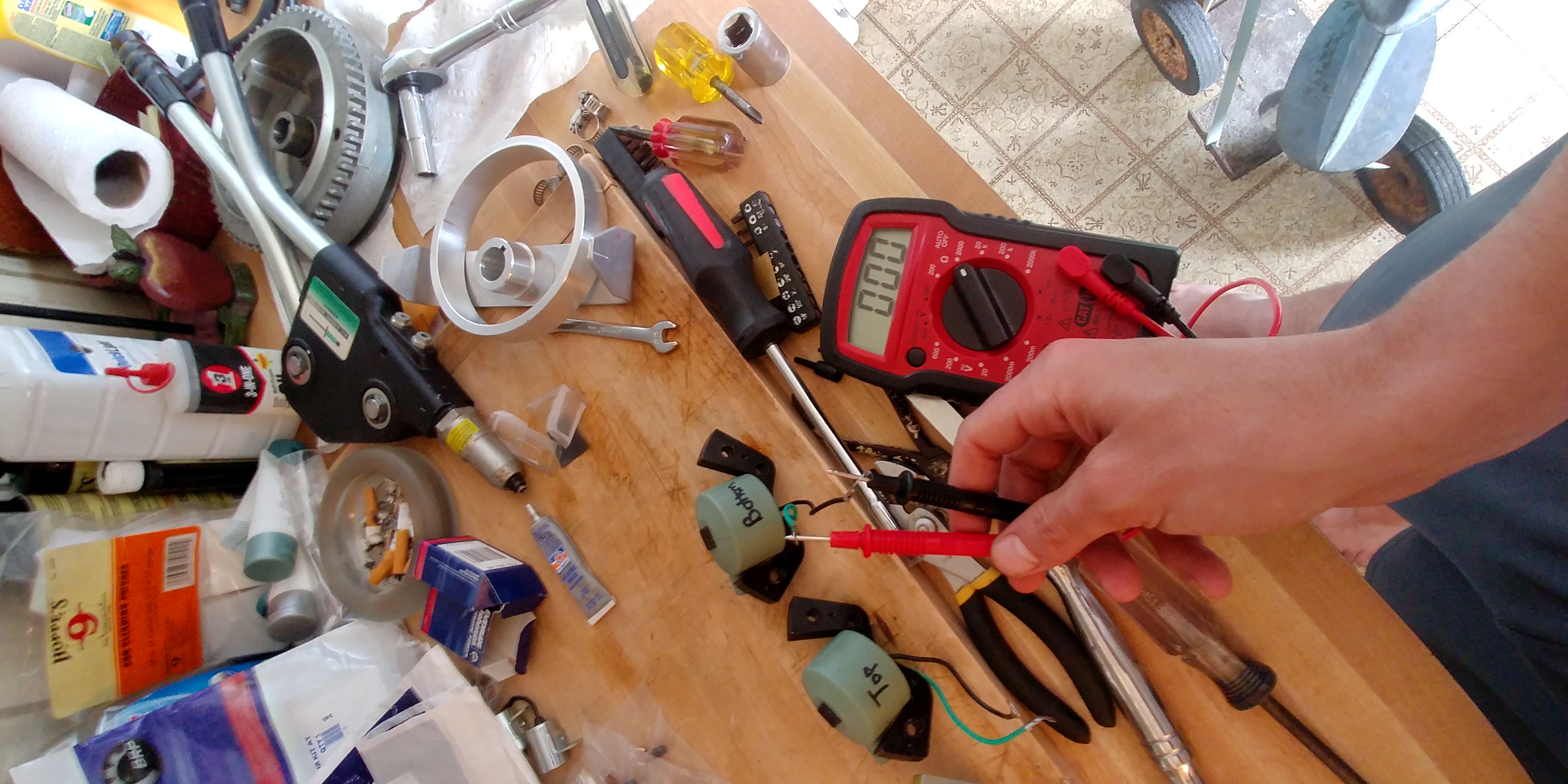

                    #71850
                    t-bell
                      20k ohm test results
                      #71851
                      t-bell
                        I guess on the bright side ive got a spare pair of freaking coils whenever I need em…. F*** me lmao ๐Ÿ˜ณ
