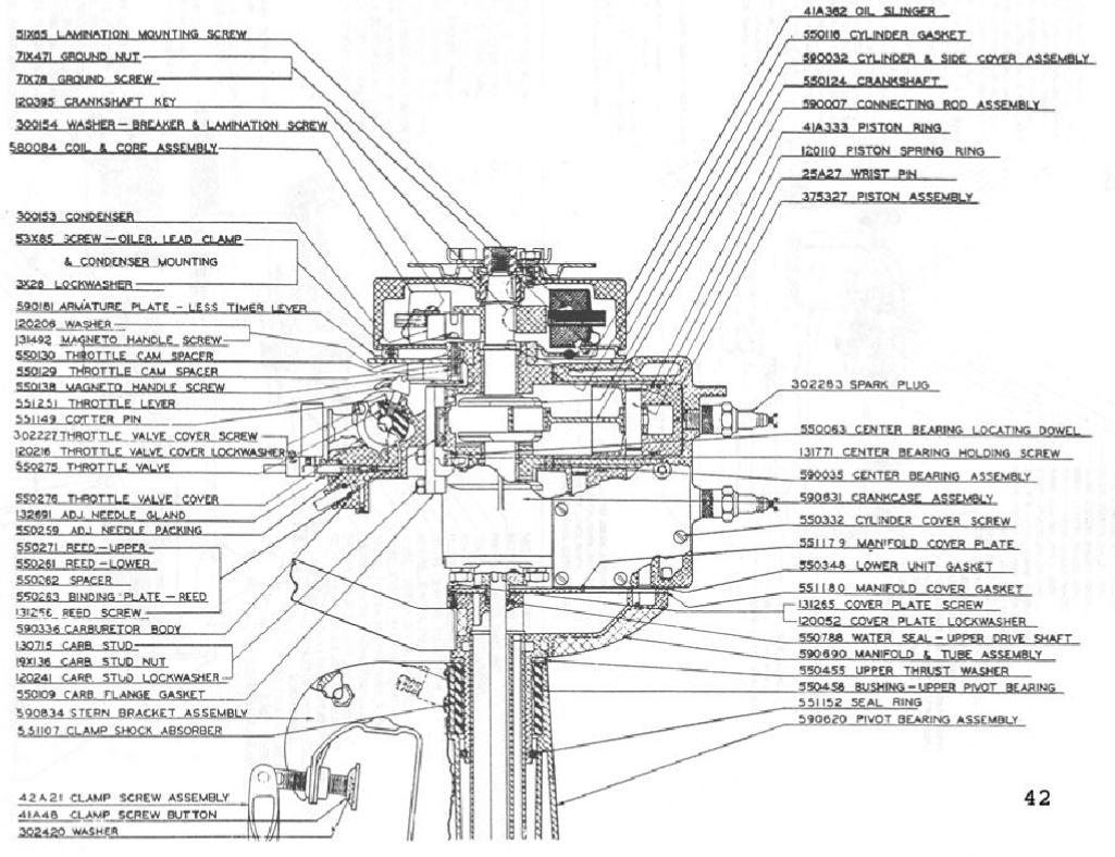

          Like this times two ? ? ? ❓
          The coils are usually good. Make sure the points are immaculate. Take them apart and clean them thoroughly. Make sure all ground connections are clean, no dirt or corrosion. . . 😎
