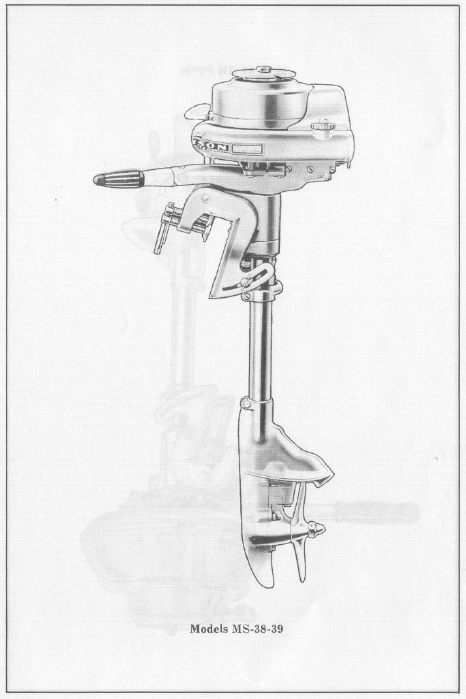

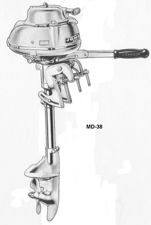

January 5, 2017 at 4:10 am #50353The rear tank throws me for a loss. . . 🙄
– LT-37 ❓
– MD-38
– MS38/39
