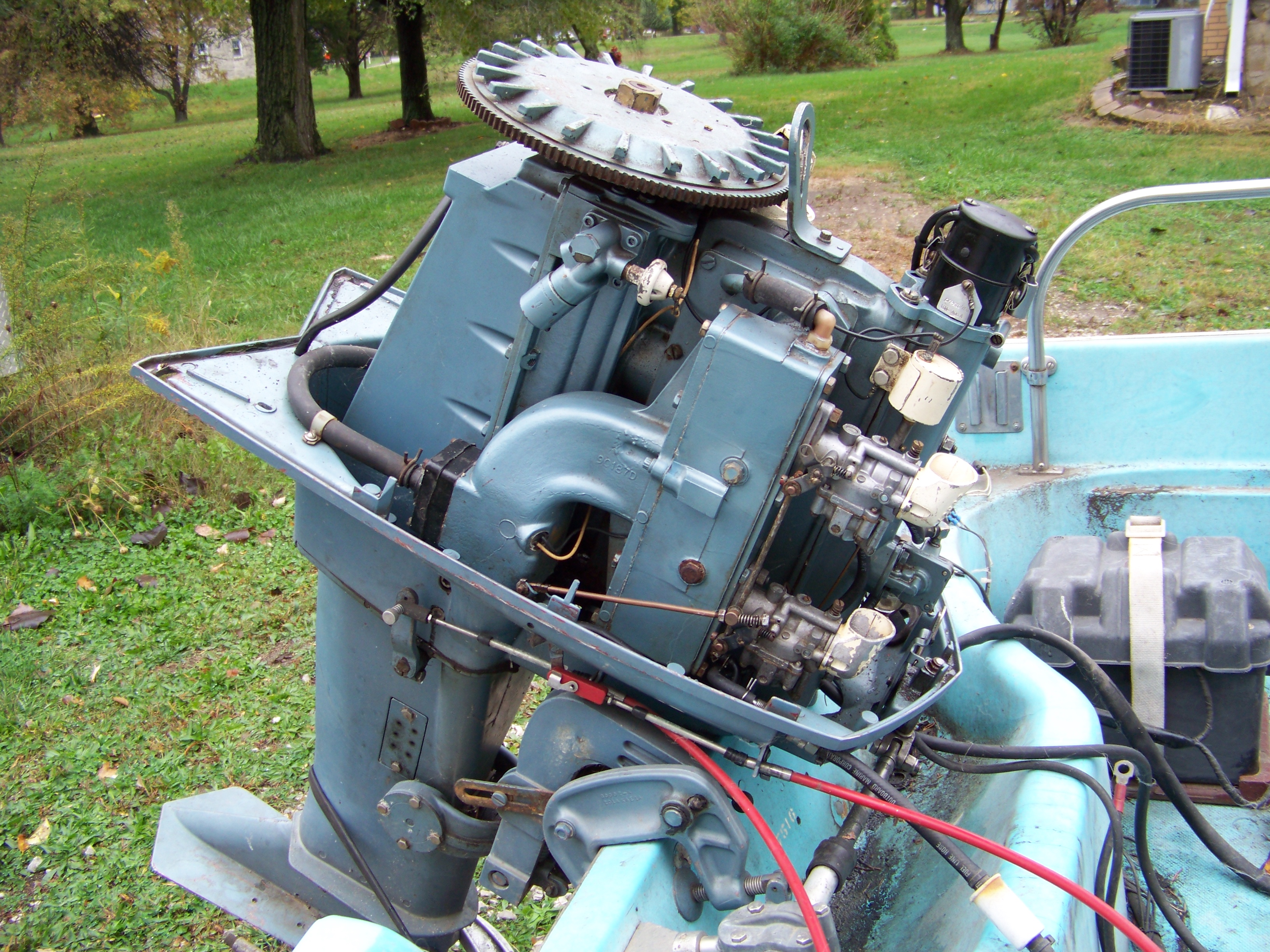

            RICK EICHRODT
              Here are a couple of pictures of my 1970 Bearcat 55.

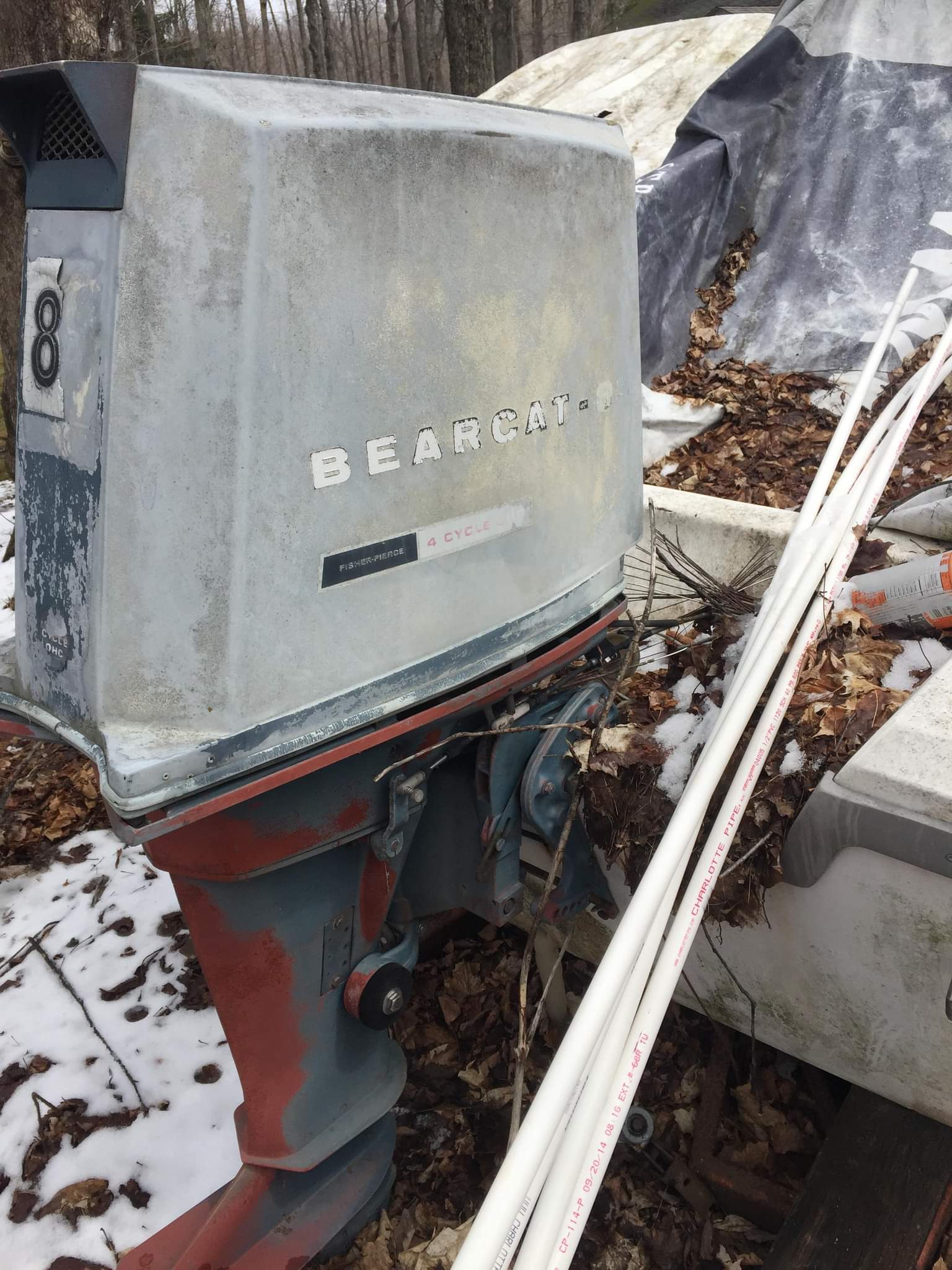

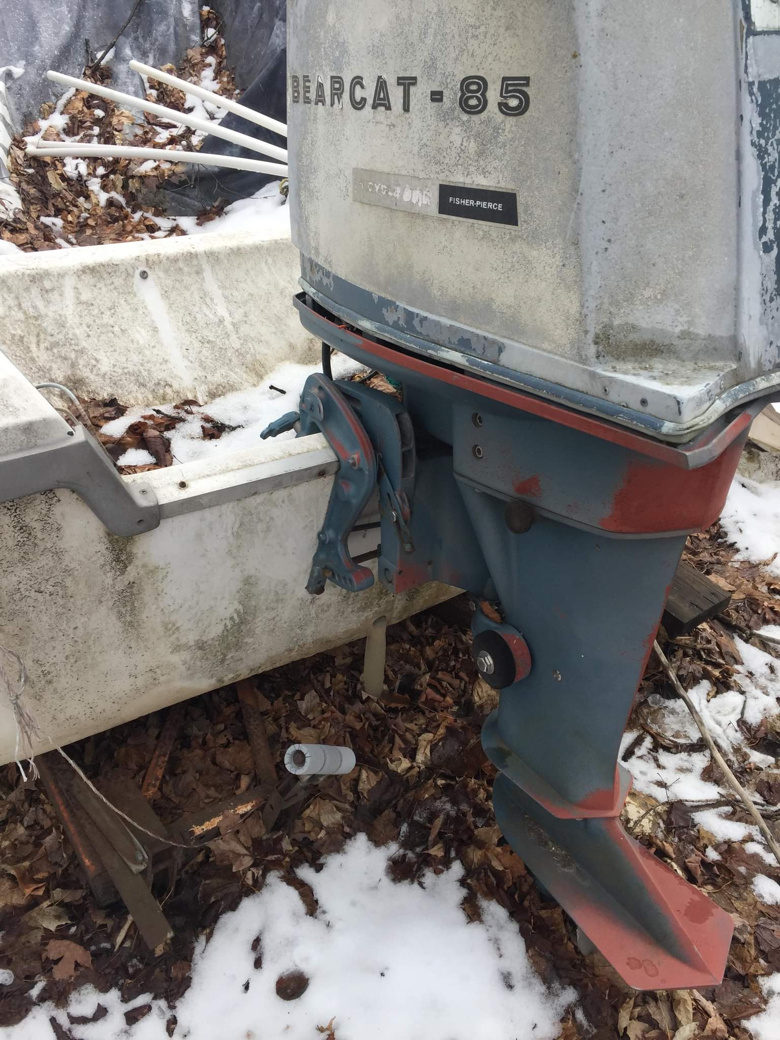

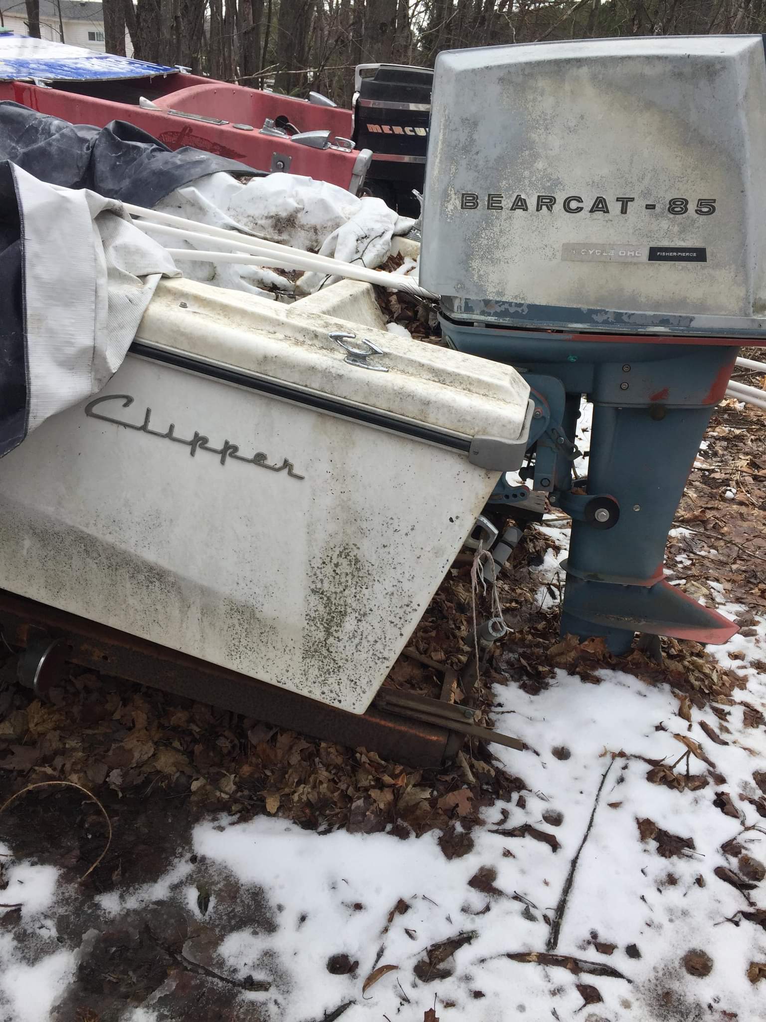

                      outboardnut
                        My buddy in Gaylord Mi. would sell his Bearcat.
                        Comes with non functional boat and non functional trailer
                        I think he want $250 for everything
                        Contact me if you want his info
