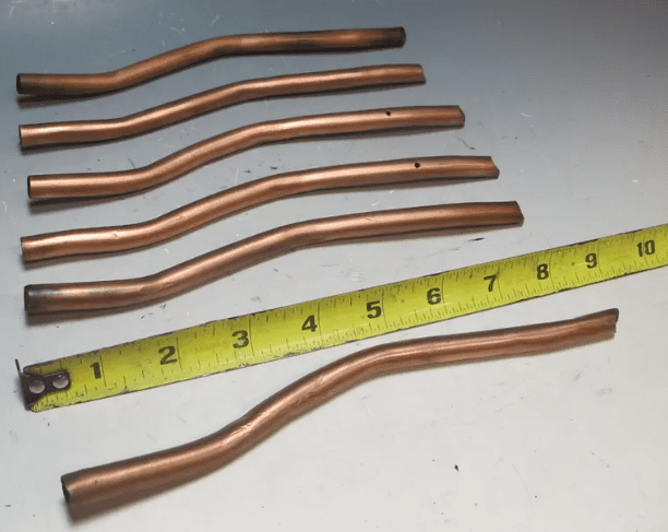

I saw some used tubes on eBay, and some had a small hole drilled in the side while others didn’t. The one I removed doesn’t have the hole. I think on some motors the hole lets the “leaking” water somehow seals exhaust from blowing past the drive shaft. I could swear I read that somewhere, but maybe I’m losing my marbles!

1958 Johnson 5.5 Hp, CD-15September 18, 2024 at 1:15 pm #290885That hole in the tube, does as you say or to spray and cool the leg? Can’t recall , someone will

September 18, 2024 at 3:05 pm #290890Larry, I think you’re getting the hole in the water tube confused with the hole in the impeller housing that does what you mention, that Frank R. so nicely explained recently. I can only remember one person on here saying he had to put a hole in the tube to cool a hot exhaust housing. There may have been a special situation that called for that out of the ordinary fix. Of all the motors of this era I’ve owned and worked on over 25-30 years, I’ve never had a need to do it. But if you saw some on ebay with the holes maybe it’s more common than I think.
September 19, 2024 at 9:36 am #290903Larry I have found several water tubes with a small hole drilled in its side. I think it’s been drilled for extra cooling of the leg and to make sure the water pump upper housing gets filled with water. When these water pumps are working properly, they pump a lot of water. That little drilling will help to keep the paint on the leg and the water pump working.

September 20, 2024 at 9:29 am #290934The attached picture is what got me wondering about drilling a hole in the water tube. It’s from T-Mike’s Vintage Outboards eBay store. The part number for my 15 Hp Johnson FD-10 is 303917. Some of the water tubes in the picture have a hole in the side while others don’t.
