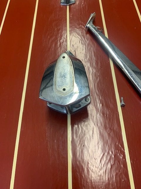

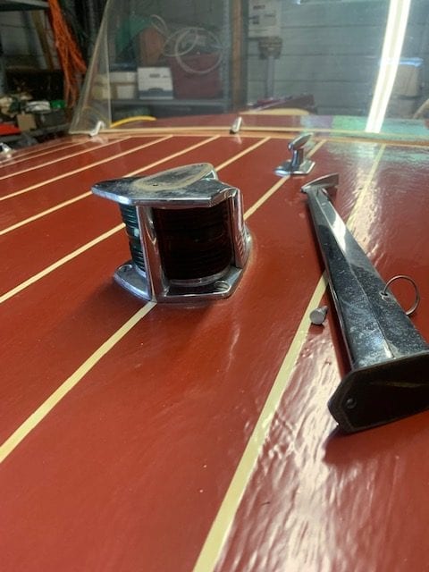

      Hi, Can someone tell me if this light disassembles from the top to change the bulb, or do I have to take it off the boat? (it’s got a bolts and nuts so not easy).
      Thanks in advance, Don

        take it off the boat.

          I was hoping not – can’t get the wife to hold the nut while i’m on top. Thank goodness for vice grips!

            Yep, it has to come off the deck.

              use anchor nuts when you put it back then you wont have to go under again.
