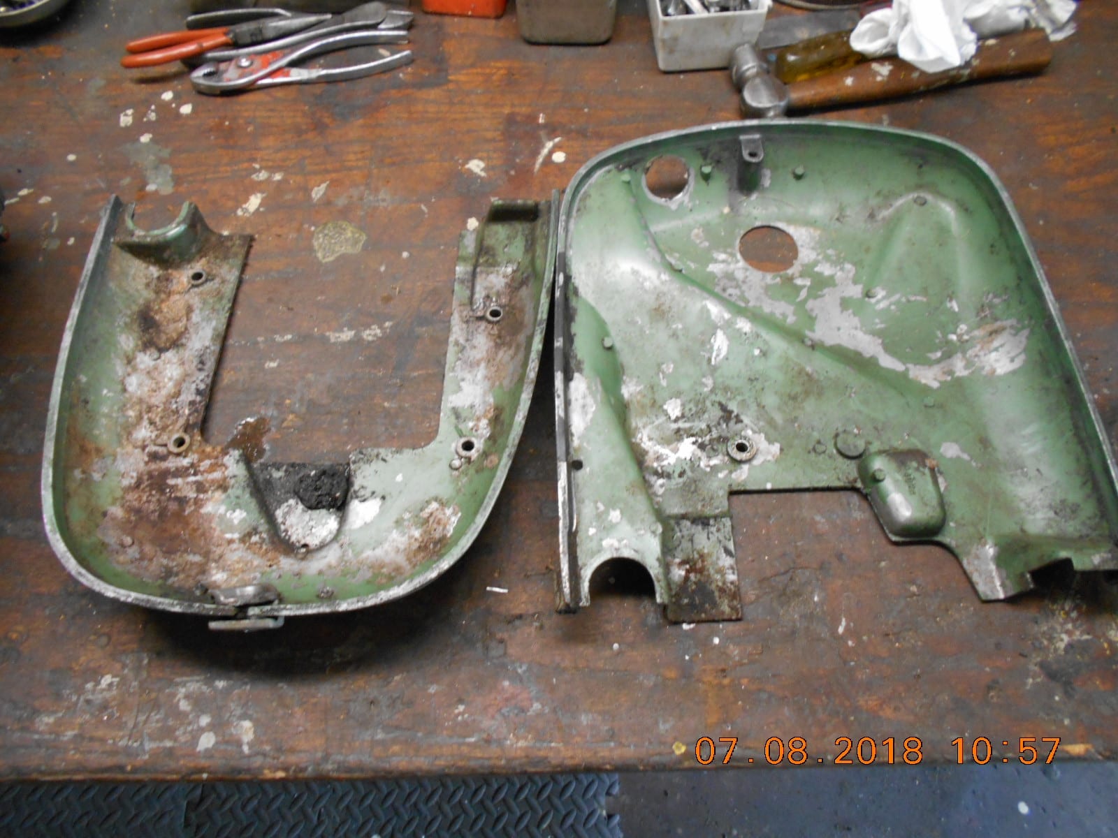

                  There was a service bulletin on this – Make sure the quarter inch hole in the lower front motor cover under the carburetor has been opened up to 2 inches. If it has a rubber elbow on the air silencer intake, it should be discarded.
                  #193821
                    Garry, I don’t remember the service bulletin when working on my RD-17E a couple of years ago,
                    but glad to see from my old photos that it had the “fix”.
