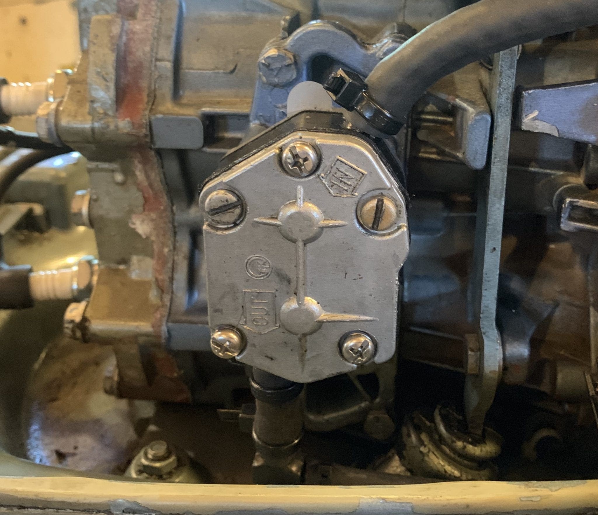

                chinewalker
                  In a pinch, I used a pump off a Yamaha 30 hp recently. The bolt spacing and pulse hole all lined up perfectly! And the cowling fits!
