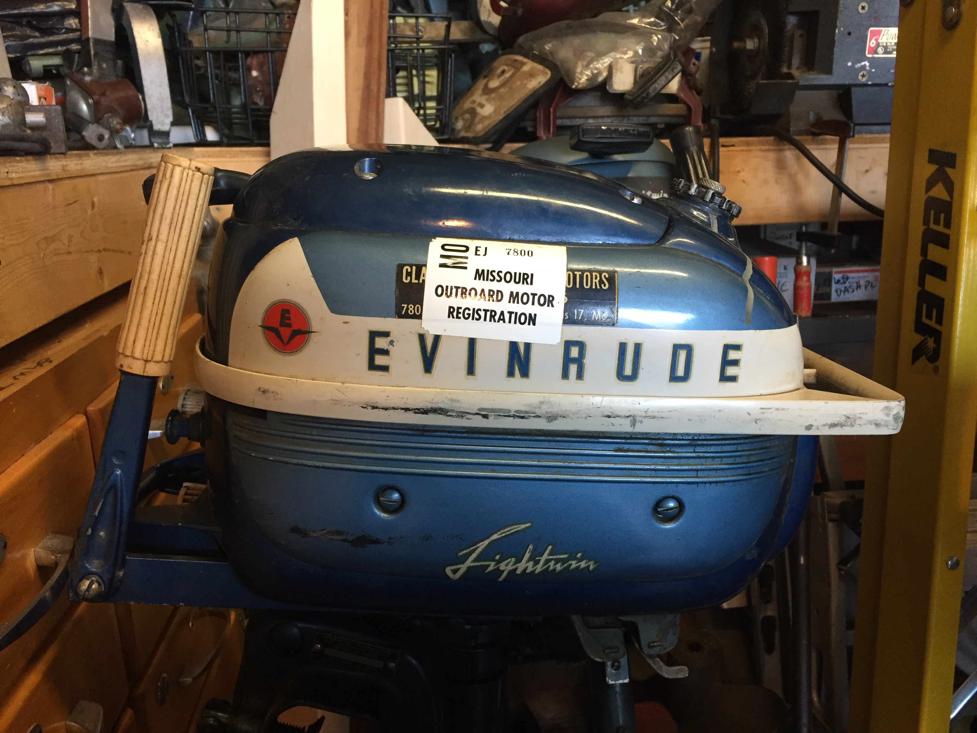

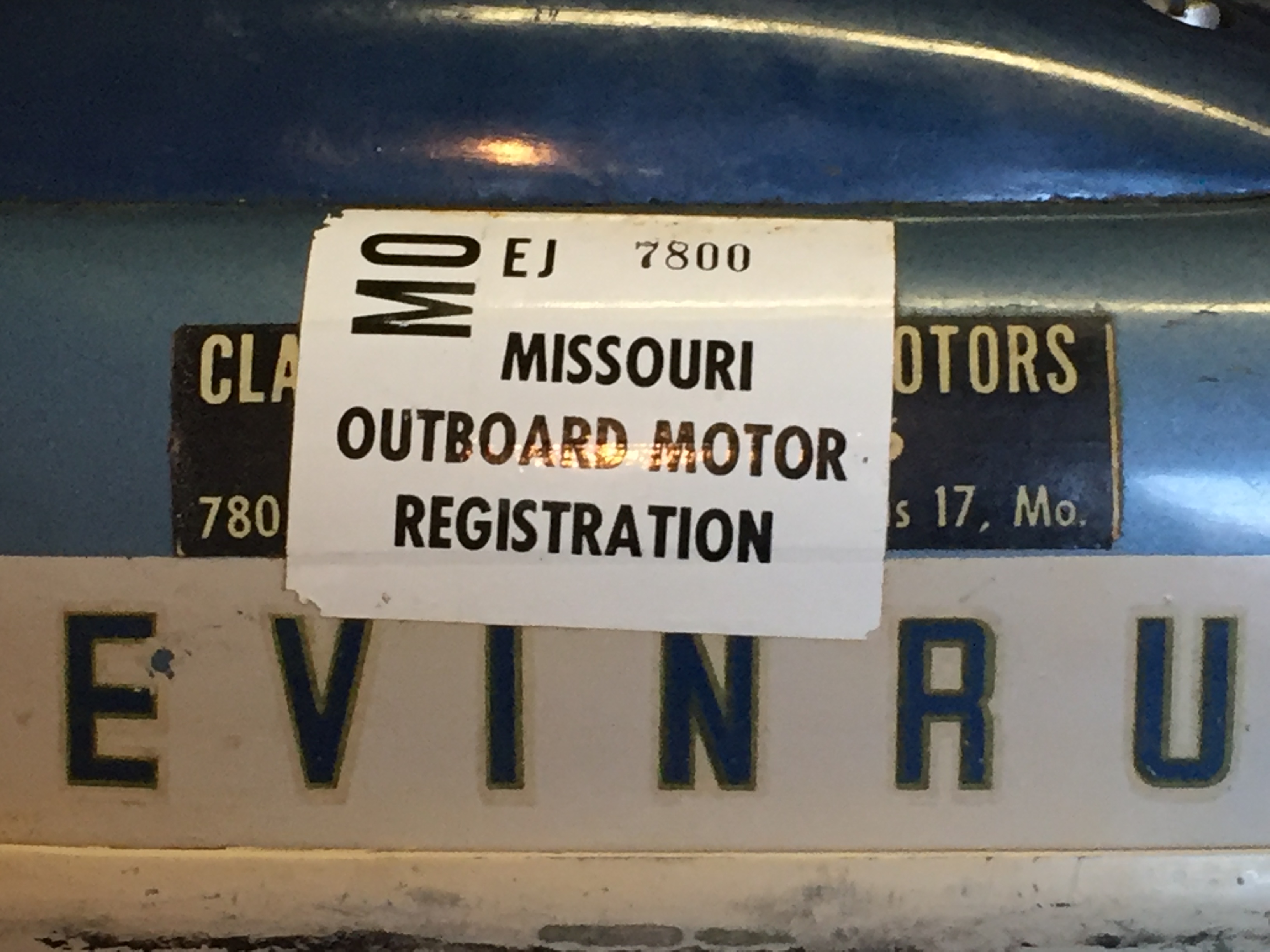

      This is a question for anybody, but maybe especially MISSOURI members. Some states required motors to be registered and required decals on the motors. This is a really nice original and I’m toying with the idea of removing the registration decal. It’d be great if I could remove it and leave the maintenance decal behind it but I realize chances of that are pretty slim. I believe the registration decal is a vinyl type and the maintenance sticker is a water slide type.
      So what do you recommend to remove it? Heat? Any of you Missouri members have much luck removing them without ruining the paint and/or decals underneath?
      Thanks for any and all input!

        hairdryer.
        #72381
          just warm it up to touch and it will just peel off
          #72383
          jerry-ahrens
            That decal doesn’t look all that old,so I would try heat. The underside decal looks nice, I agree.

                As stated, careful use of a heat gun will soften the vinyl and its adhesive backing making it easy to remove. Goof Off or a similar product will clean up any adhesive left behind. Too much heat might soften the paint and you know the rest……

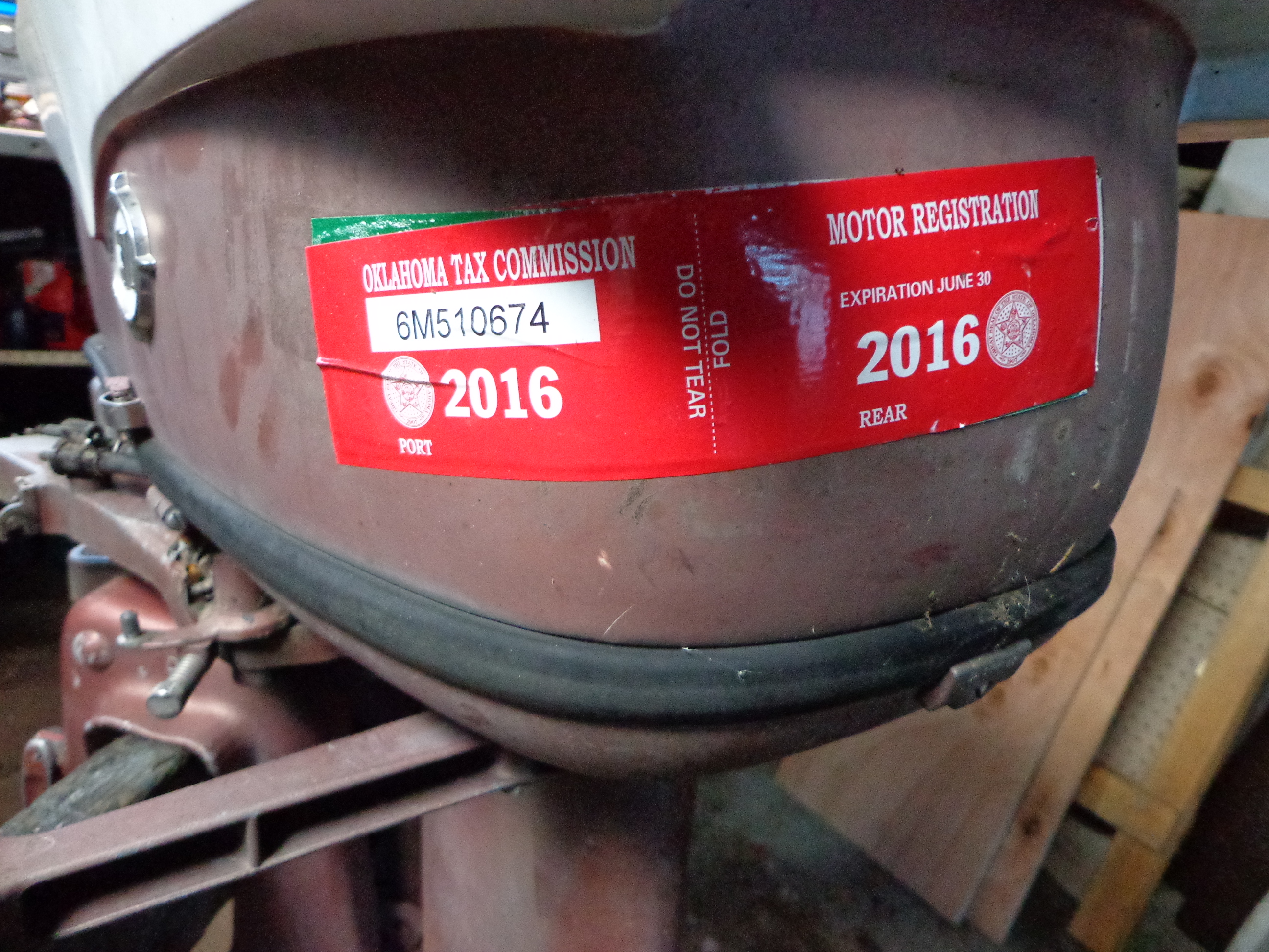

                PSB: You think that sticker is ugly, check out this one on a ’56 Johnson RDE from Oklahoma I picked up. It wraps around the side and rear of the hood. The buyer of this ’56 Lone Star package had to put it on to make it legal on the highway or something. I’m sure glad we don’t require then here and I’d sure hate to be made to stick one on a freshly restored motor.

                    Another vote for hairdryer, and peel slowly. To remove any left over residue WD-40 also works for that and may be less aggressive in the decals than goof off. Good luck it’s a great looking motor under that sticker.
