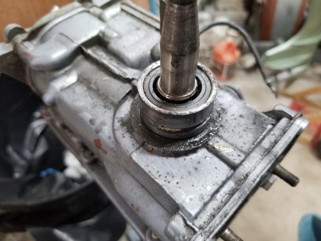

      This is an Evinrude 2.0 HP that I want to replace the crank seal on. DO I need a “special tool”?

        can you collapse the seal and pry it out ???????

        huntleybill
          I guess I could do that but I didn’t want to risk breaking the block.
              If you don’t want to take risks. it really isn’t that hard to remove the crank on that little motor. Certainly cheaper than buying a special tool

              huntleybill
                This is true. There sure isn’t much to them. Or, I can use a screw like tubs video.
                Thank you for the ideas.
