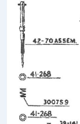

      Looking for highspeed needle valve or repair kit. Also no tension on adjusting wheel, won’t stay in desired adjustment position, freewheels.Carb complete
      #175729
        Wrong model shown in picture, but shows the spring and two washers that provide tension on the needle to keep it from spinning.
