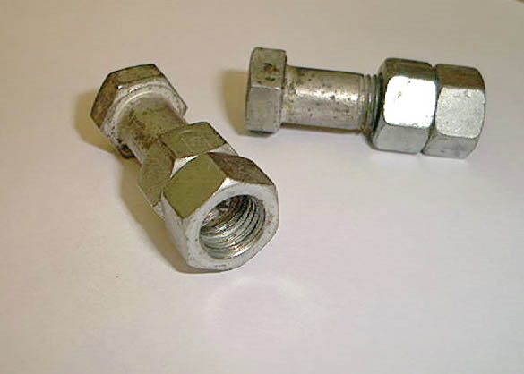

        If I remember correctly, these motors use a knocker to remove the flywheel as there are no holes on top for a puller. On some motors, the nut which holds the rope sheave on was stepped and acted as a puller. I don’t like using that system as I’m always worried something is going to break.
        Here’s a photo of a simple flywheel knocker (thanks FR) composed of a short bolt and two nuts with the same thread as on top of the crankshaft. The nuts are jammed together on the bolt and then the knocker is screwed down onto the crank until it bottoms out. Then, while lifting up hard on the flywheel, the knocker is given a sharp rap with a hammer. This works everytime and doesn’t damage anything as long as an upward force is applied to the flywheel while striking the knocker.
        Can you post a photo of your flywheel?

          I believe this is the flywheel you have. If I’m correct
          the tool Mumbles has posted is the best way to remove
          it. Here is my video on how to use that tool.

            Thanks so much i never would of figured it out. I hope sometime ill be able to help out someone.After working on 5 old motors i still run across things i have no idea about. I guess that makes it interesting to me.THANKS DaveR
