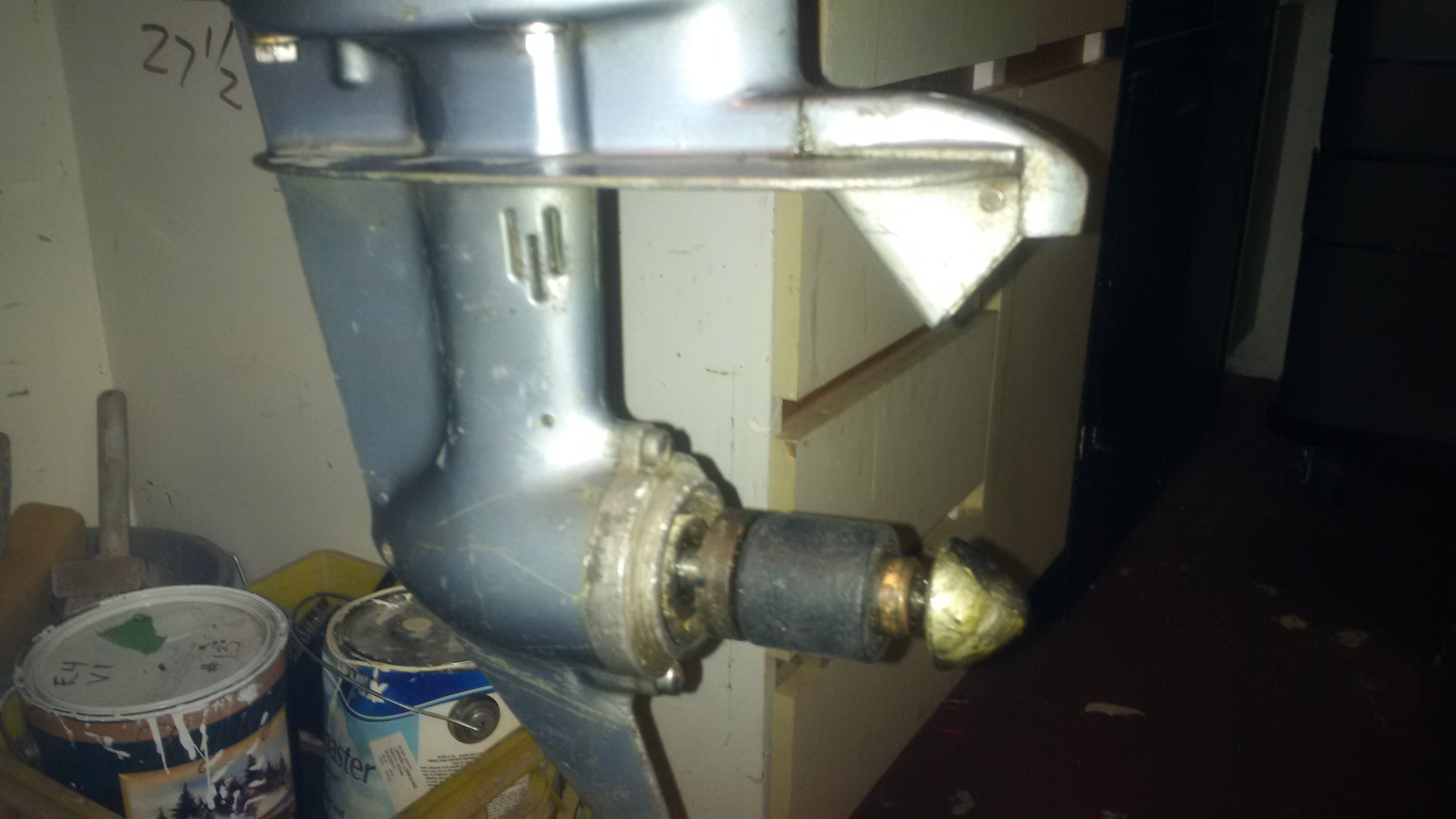

!965 Evinrude Angler 5 hp
This motor is one of the 30 I got recently. Looking at the parts diagram I don’t see a t’ stat, but on the 6 hp with the same powerhead there is a t’ stat.
I see the upper half of the carb has a different part number too. Is this where that 1 horsepower is lost on the 5 horse?
Anyone have a spare prop # 0380104 ? The pictures of the replacements I have found on the net don’t seem to have the correct hub.
February 7, 2016 at 6:35 pm #31567I may in my boxes of props. What are the measurements of it do you know in case some are not marked?
February 7, 2016 at 7:10 pm #31570Your Angler is a detuned six horse matched up to a JH style lower section. ME doesn’t show a stat in their diagram but I think it should be there. The carb and manifold bores are a lot smaller than the six horse ones and I’m sure this is how they got them down to five horse. After searching for ages, I finally found a correct prop for mine at the boneyard up in Campbell River.
Don’t do what I did once though. For my missing prop, I did some machining and adapted an old CD or something prop to the LD. Standing back and admiring my work, it suddenly dawned on me that the motor needed a left hand prop and I had fitted a right hand prop to it! 😥

Thanks Chris ! The prop is supposed to be an 8 inch diameter and a 7 1/2 inch pitch and a 1/2 inch prop shaft. I do have (from a 3432r Yachtwin) an 8 inch with only a 4 1/2 inch pitch that fits. running with this would cause it to over rev correct?

Parts diagram shows 2 blades, but Michigan wheel replacement 12004 says it’s 3. I will look through my parts books and see if I have itFebruary 7, 2016 at 8:05 pm #315775hp did not have a thermostat. Anything to save a buck, since it was a bare-bones motor supposed to compete with Eska / Sears. But they did offer a thermostat "kit".
