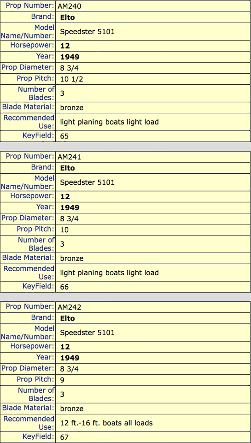

          This is from our Michigan wheel database. This 12 horse Elto was built by the Gale Products Devision of OMC. It is an example and would not work on a gearshift motor. . . 😉

            A variety of optional props were offered for the 15-18hp in later years. They all will fit the 12hp Gale w/gearshift.
