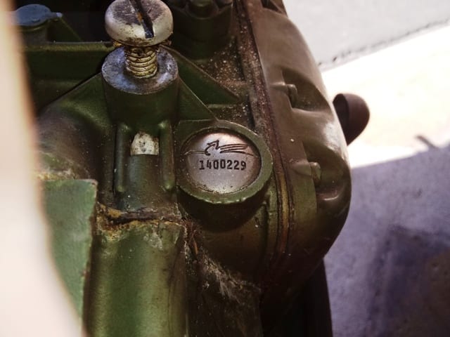

      1400229-serial-number

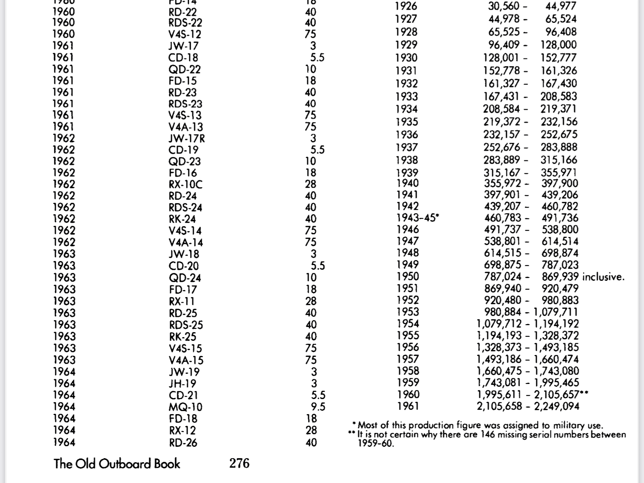

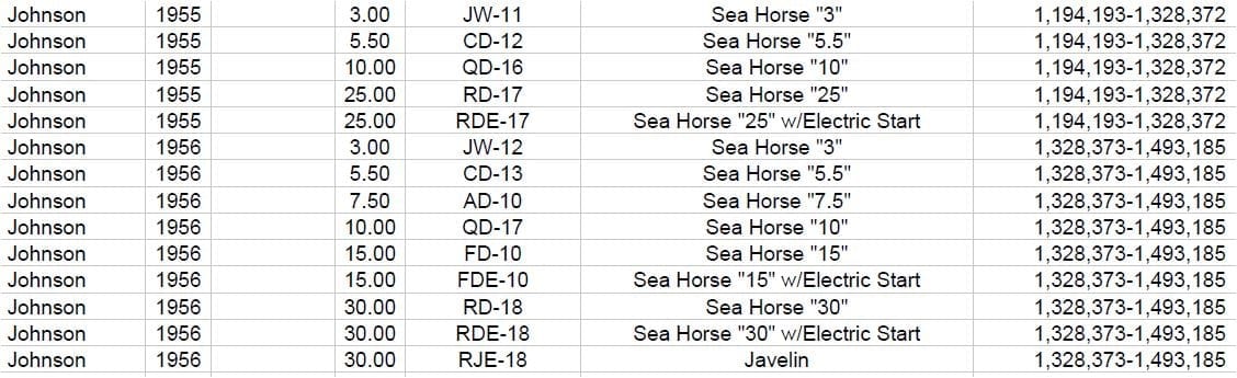

        All I could find in The Old Outboard Book was that it was manufactured in 1956.
        Model RD-18
        Model RDE-18
        Model RJE-18

          Looks like 1956 motor according to The old Outboard book.
          Model RD-18
          Model RDE-18
          Model RJE-18

            All RD-17 xxxx models were 1955. But the serial # you posted is for a 1956. What gives?? I’d say that IF it really is a 1955 RD-17 the powerhead has been replaced with a 1956 30hp. Many RD-17S models had the powerhead replaced due to those lower seal problems.
            Wanna know what kind of seal you have? Look and see. Sorry ’bout that.

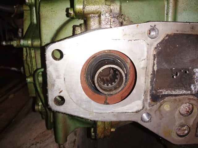

              By just looking at the bottom crank seal-I think it has a lip seal because I see a spring (which makes no sense-Since it is a 1956 it should have carbon seal)

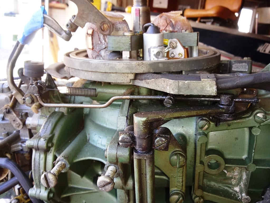

              It does have a fuel saver rod (like a 1956)

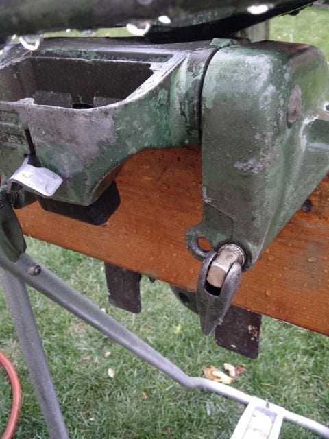

              It has a hole on the stern bracket for an overboard cable (like a 1956)

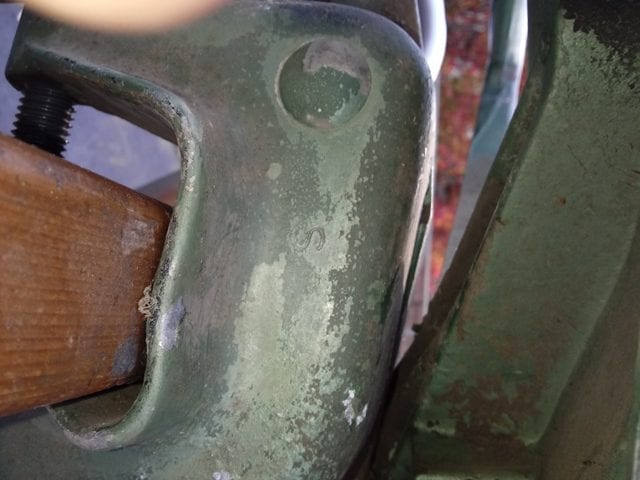

              It has the letter S stamped on stern bracket

                s-stamp
                #220162
                  Since the factory installed ID plates don’t fall off by themselves and one was never reinstalled, there’s a good chance your ’55 RD had a shady past and a welch plug from a ’56 model was installed to help conceal that past. Just saying.
                  Serials-55-56.

                    1. The picture you posted is indeed one of the troublesome lip seals, and yes it has failed.
                    2. About those model numbers: RD-17S would be a lip seal.
                    3. EARLY 1955 (RD-17) would have a carbon seal. That was changed to a lip seal in mid-year 1955 (RD-17S).
                    4. EARLY 1956 models were 30 hp and still had the lip seal. But because they had to replace so many powerheads due to fatal seal failure, another change was made in mid-year 1956, reverting back to the old reliable carbon seal.
                    5. I am not sure of the model numbers denoting the change in 1956. I may have lost them when my computer crashed.
                    6. Hope this helps clear things up.

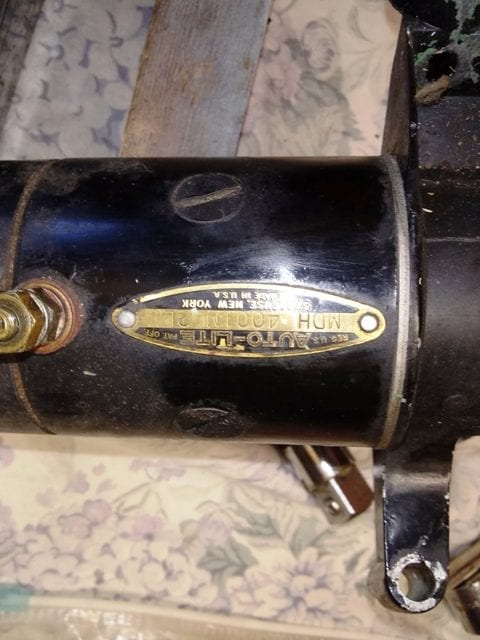

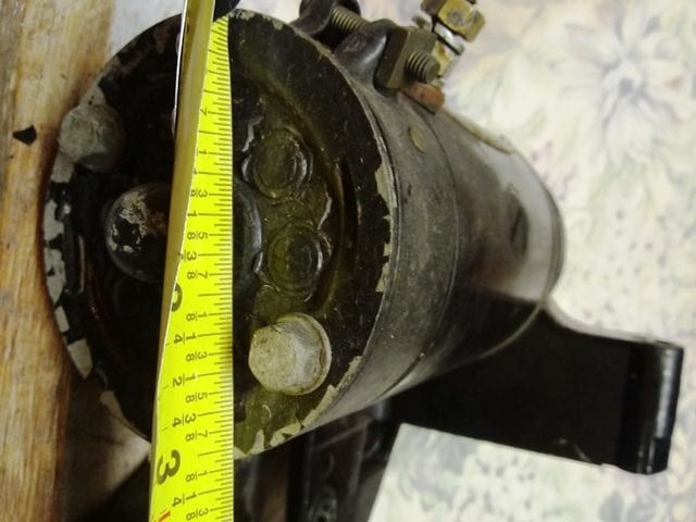

                      1400229 also came with electric start.I believe the starter is 12 volts
                      It is 11 tooth AutoLite MDH 4001 M2
                      I also believe the choke solenoid is 6 volts because there no written denoting that it is 12 volts.

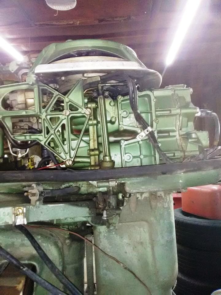

                      The plan is- :
                      Take off the stuck 1400229 (1956) and put on a RD-17S (1955) block
                      To use the exhaust housing from 1400229 (1956)
                      To use the carb from 1400229 (1956)
                      To use the mag with the stop and link assembly from RD-17S (1955)
                      To use the starter from 1400229 (1956)
                      To use the ring gear flywheel from the 1400229 (1956)

                      #220193
                        Your starter is six volt as it has the inspection band over the brush area. Twelve volt starters weren’t used until ’57.
