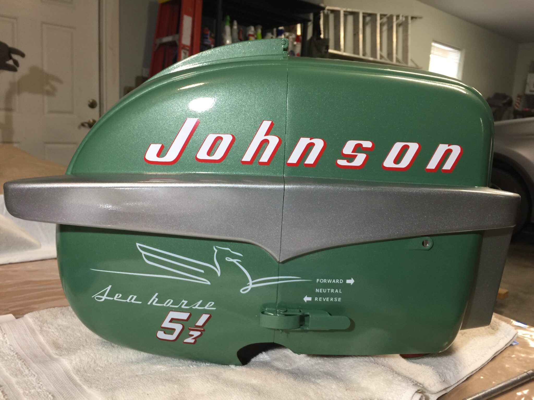

              #250789
                Here’s a pic of my ’54 CD-11 with original paint colors.
                1954-CD-11

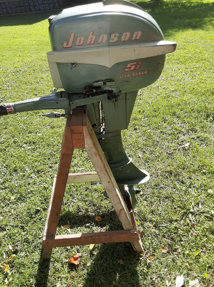

                  aquasonic
                    Here’s a picture of one of the early 1955 CD-12 motors with the cowl wing screws. I’d guess that these cowls were left over from the 1954 CD-10 or CD-11 series.
                    Johnson-CD-12-with-Wing-Screws
