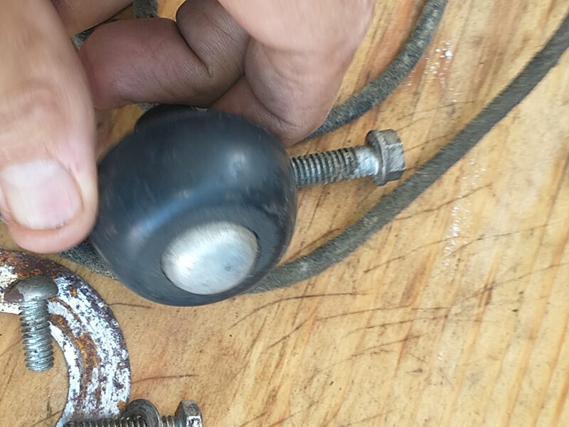

      I found this coffee can full of outboard parts..
      The pull knob is very distinctive as well as the interesting little parts that look like needles for the carburetor and the castle nut etc..
      Can anyone identify what motor these parts are off of.?

        Needle valve is Elgin.  Starter knob is, I think, Scott.

          What Tom said , X2

            If the threads in the prop nut are 7/16 by 20 its for a Pal, Scout, or Ranger. If the threads are 1/2 by 20 it would be for an Ace and likely some others.   Tubs
